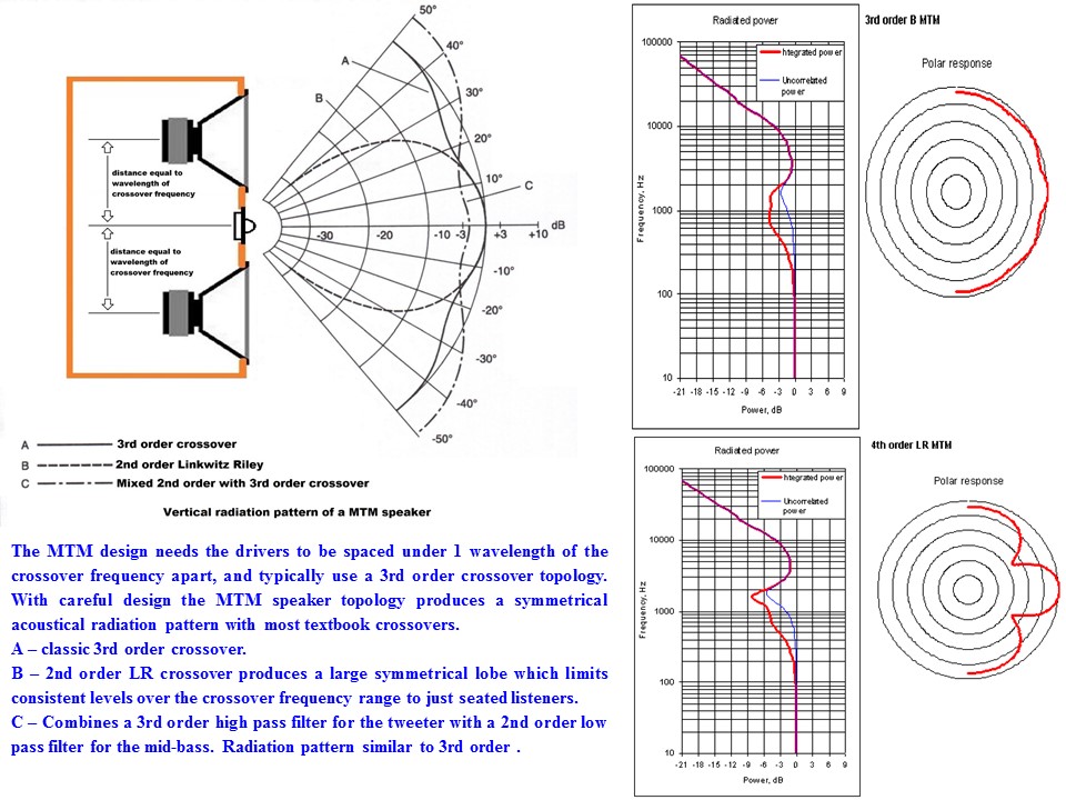

"The filter is a normal 3 way second order LR design."
Properly designed, the MTM driver configuration with 6"-7" midranges generates a large center lob which is often favorted for seated home theater listeners because there is reduced room/wall interaction. Clear sound for close seated listners in a small room, even with the speakers against the rear wall.
For broader MTM usage, changing midrange driver size, C-to-C spacing, and the crossover circuit can produce a few different polar patterns.

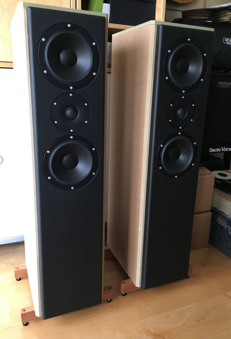

Beautiful work and a very nice finish. I'm glad you explained the title in the first post.
We often see the word "best" used on this forum and it always makes me wonder... Best what? For whom?
Most suitable to your own specific needs is what people should be after i.m.h.o. 🙂. It seems you've got that covered!
This price for the mains pair scared me a bit, that's quite some budget to play with!
How much of that budget went into the CNC process?

The front speakers costed approximately €12.000. This includes the outsourcing of the CNC work.
If I would have just built the fronts it would have been more.
I read that explanation as well, but must admit that the prototype we built just started to sound fantastic after two days tweaking. And that was with a dsp based active crossover to figure out what crossover frequency worked best.
But the 2nd order LR was where we came back to every time

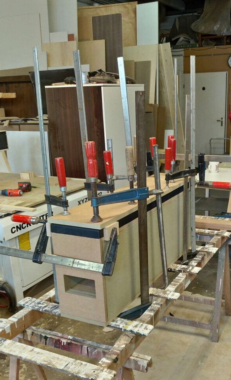

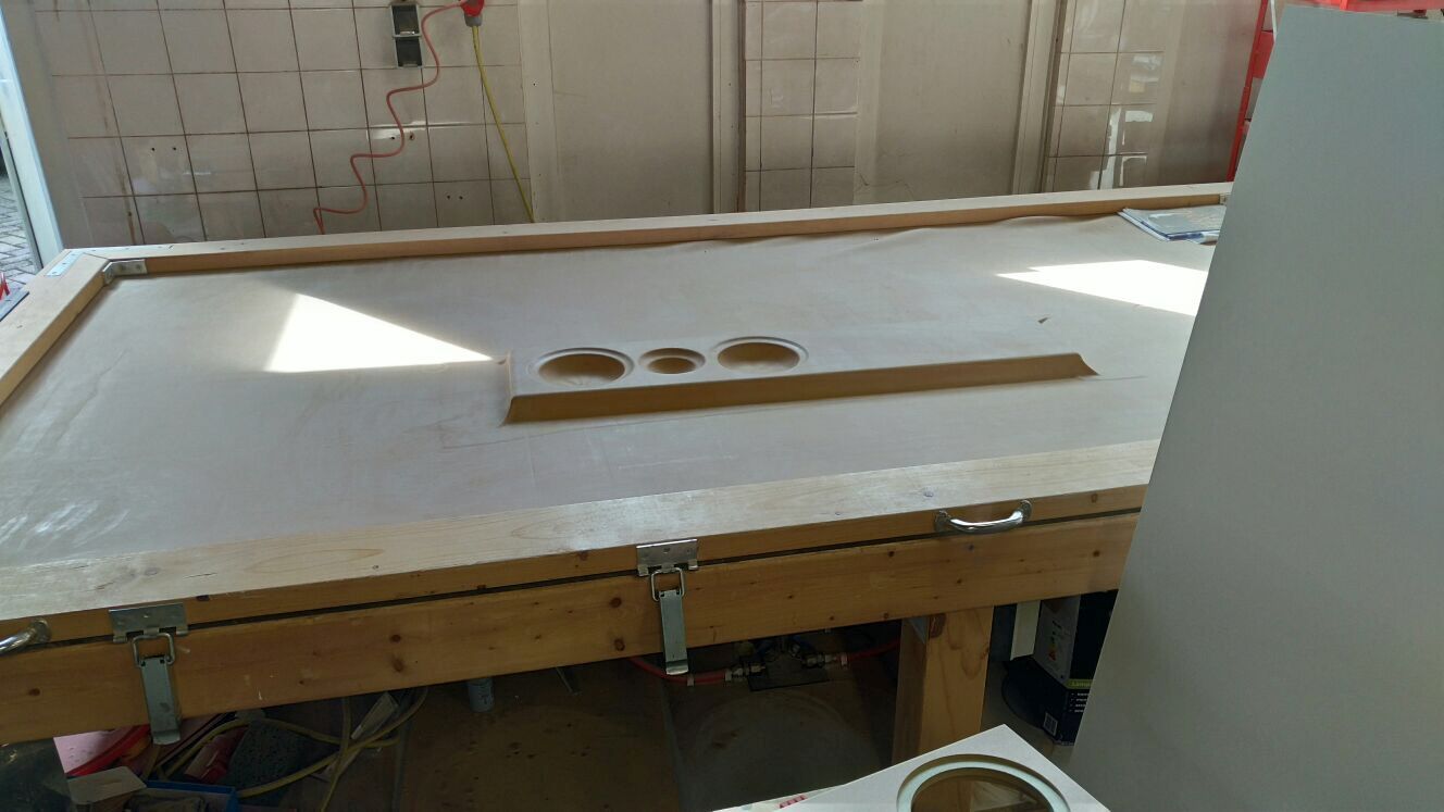

The CNC part was quite a challenge.
After we glued the first 6 baffles (2 big ones and 4 small ones) and went through the CNC process and the next day the layers came loose. Something went wrong glueing the 13mm panels on a vacuum table. The second time I glued them under a 30ton press. That proved to work but the CNC machine caught fire due to the drill getting blunt.
I spent in total € 1000 for just the baffles CNC without material

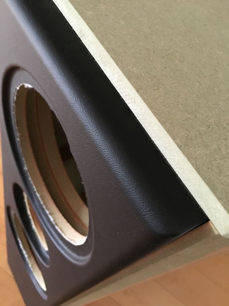

The gluing of multiple layers and the leatherette was done on a vacuum table. For most applications this is a great too but less ideal for the HDF where the sides came loose.
Getting the leatherette smooth around the corners was something I never did before, but this was quite doable with some patience and a heat-gun. The positive surprise was how well this fairly low cost material (€5 per speaker) matched the drivers with respect to color.

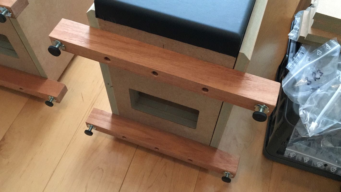

I added feet to test the influence of the distance to the floor with respect to the down firing port. This proved to be not critical as long as there was enough 'breathing space'.

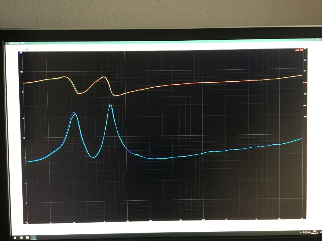

The impedance test showed quite well that the tuning frequency was calculated/simulated correct.

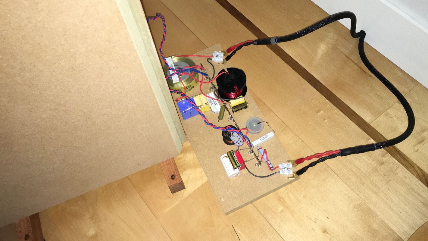

Then we made a prototype filter with basic quality components. added a baffle-step compensation to compensate for the reduction in LF energy below 300Hz. At the end of day two we had real music coming from this speaker.
This was the point where we were getting confident that we were on the right track. Another weekend of tweaking proved that we made a musical design and that things were so good that the real thing would be great.

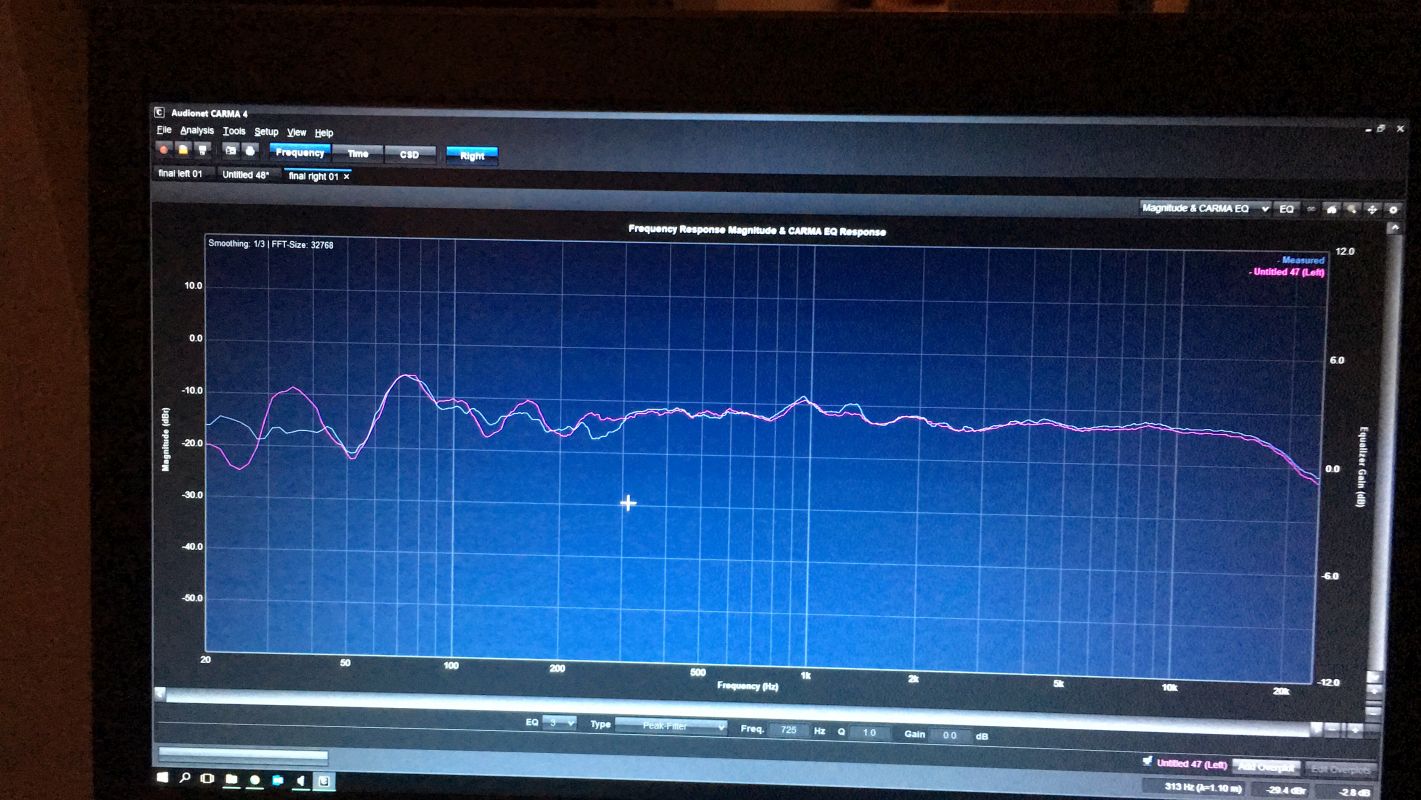

The graph below shows the frequency response measured at 1 meter tweeter height.

I need to clarify something Ronald,
As we do not have a wood-shop with the tools and the space to make 6 speakers more or less at the same time I made a deal with a local wood-shop.
(i saw in your line array thread that you have quite some space to build something)
For a reasonable amount of money he delivered the MDF material and did all the CNC work for all parts except the fronts as that needed a 5-axis CNC. At the same time we could use his place in some evenings and the weekend to put it all together, glue, sand and mount the parts.

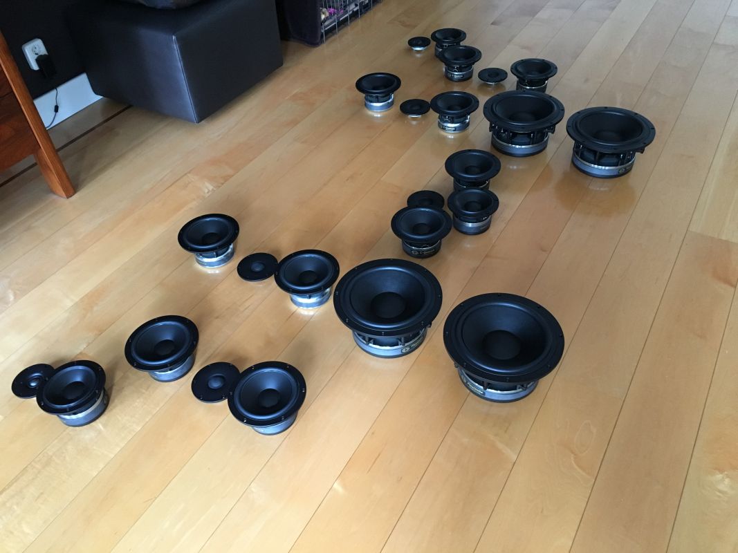

Of course the parts are expensive.The drivers (see below picture when they all arrived) Audio technology, the beryllium Scan-Speak tweeter and the Mundorf top of line parts add most to that total amount.
Even the feet were €35 each on Ebay. Stainless steel rods, Technocell dampening. and €2100 for the Walnut side panels (4 speakers) also influence the cost significantly.
I must admit that when I started I had a smaller budget in mind, but if a project like this takes over a year you don't feel it that much.... haha.

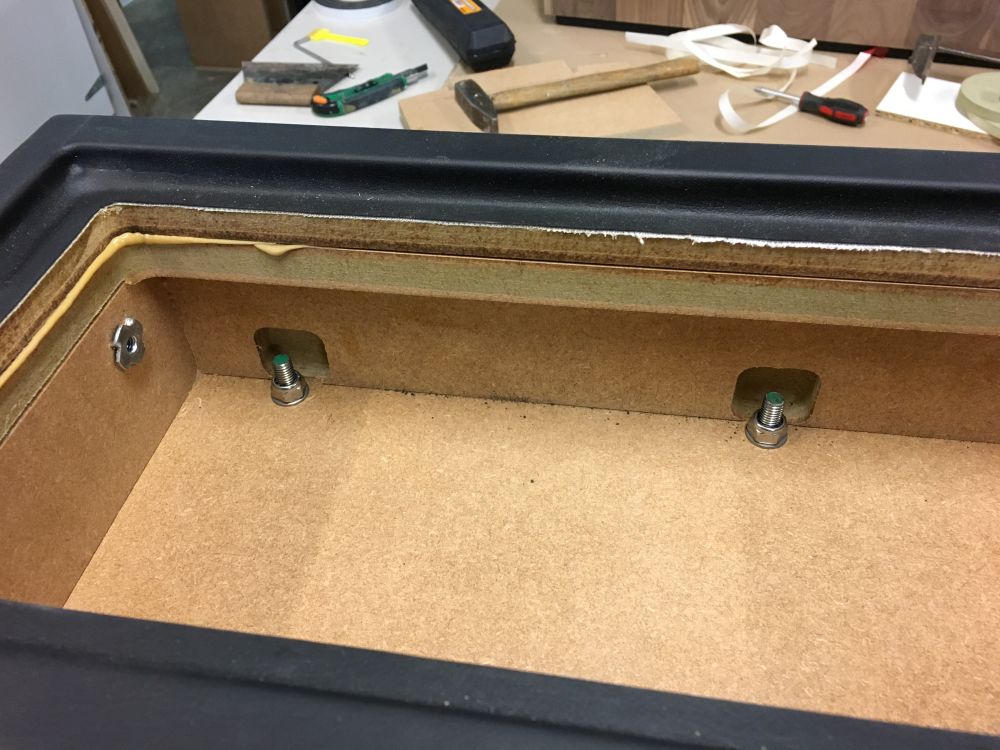

Out of interest- is the front baffle removable with the threaded rods you're using? or was that just for alignment / fixing or to try some sort of resonance decoupling from the rest of the cabinet?
If removable - do you have a photo of the back to show how the rods are terminated / fixed?

The LF and the MF are in parallel. I don't think speakers should be mounted in series as they will ruin the dampening. the impedance of one is always in series with the other. I did order these units with a higher impedance of Re 7,5 Ohm.
Because of the flat baffle and an extra large capacitor in the HPF of the midrange the MF and HF are in phase. It gave a perfect response mounted in phase and a nice gap when in anti-pahse.
The MF/HF set is out of phase with LF.

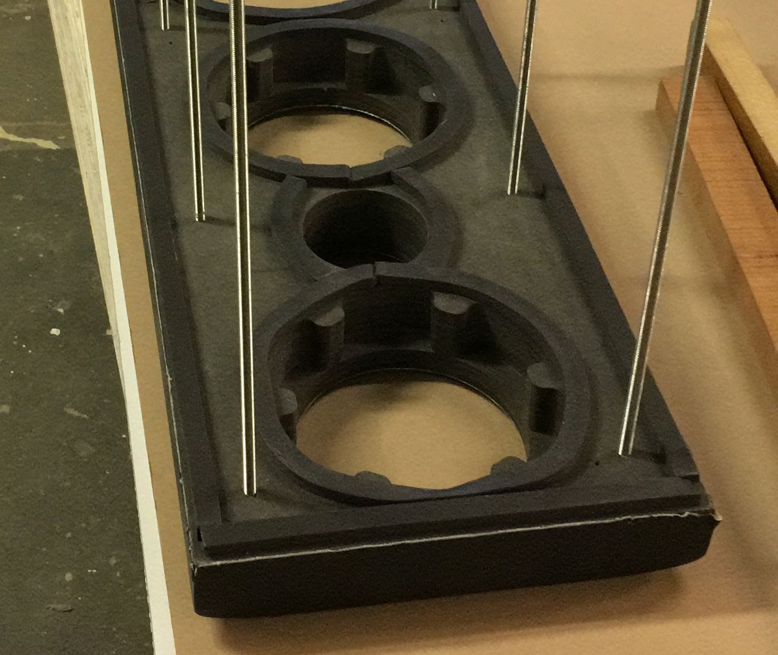

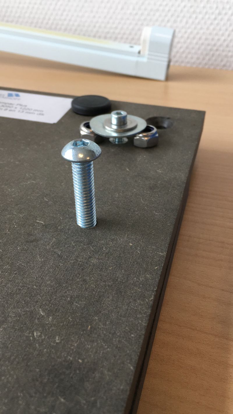

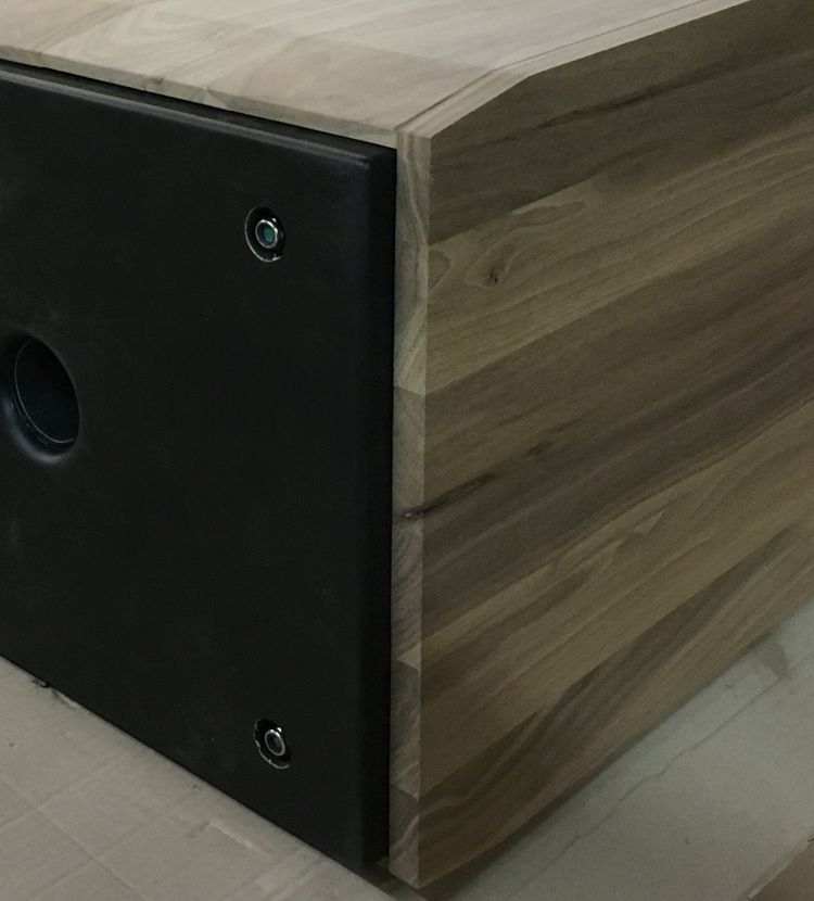

The main function of the M8 rods is resonance control of the enclosure by putting tension on the rods. No alignment was needed, it actually proved quite a challenge to get all 10 rods aligned and at the end I used 10mm pipes to get the rods trough all chambers.
In theory they are removable. The threaded rods are screwed into the front directly for approximately 20mm. This is an extreme solid fix that I tested separately and could not pull out with any normal force.
I planned to glue the front to the main enclosure. And next time I would.
But I decided to use a "sticky" foam as I didn't know how this would go. Would the leatherette hold and so on.
Because 10 M8 rods are used and the front is massively rigid with 5 layers of 13mm HDF glued under 30T pressure. The whole structure is very very solid. I don't think glue would have made a difference.
See pictures for how it was done.
Hope this helps
