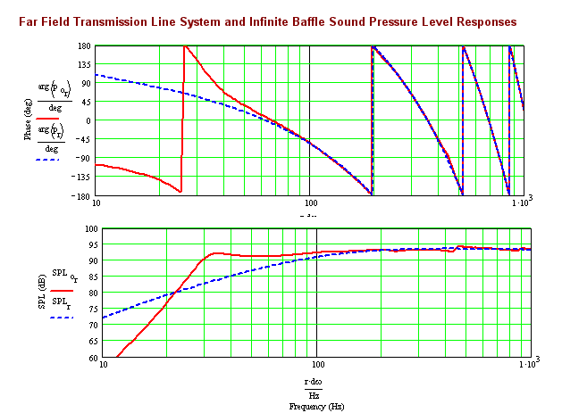

Scott, quick question. I was laying out a cutting list for the towers, and there is quite a bit of material wastage. What's the performance hit for going down to a 12" deep cab rather than the 13.75"
I've just run a quick check and you're in luck according to MathCad anyway: almost nothing is the answer. That's the sim result below.
Oh yes: if you find the cabs too bass-heavy, increase the port length to 4". That will roll things off below 100Hz whilst keeping the same F10. Sm is reduced to 3.55Sd and So to 0.888Sd respectively (or very close). All other dimesnions remain as described.
