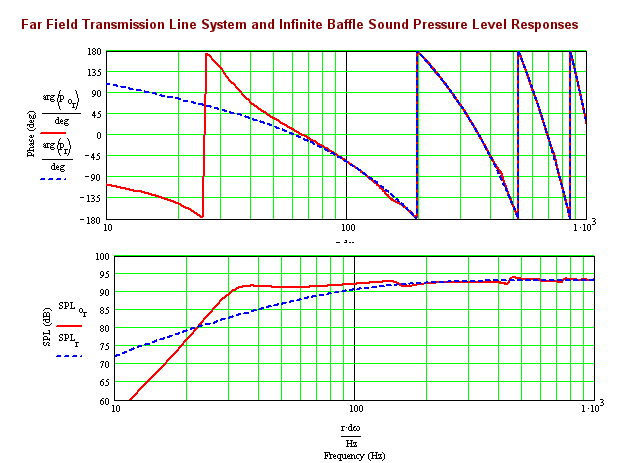

Cheers guys. Assuming it's the SP1044, this thing is a doddle to use in a Quarter-wave resonator (TL)
Two options here: a Mass Loaded Tapered Quarter Wave Tube, and the next post will have a straight, Mass-Loaded Transmission Line. For more on these geometries Freo, if you haven't seen them before, look at the Projects section on Martin King's site: www.quarter-wave.com
The Project 2 ML TQWT shows the basic cabinet shape. Looks good in-room. If it's too tall for you, you can simply fold it in half, the top to the rear, and it will perform exactly the same.
ML TQWT first.
Line-length: 60"
Width: 16" internal at the base, 4" internal at the top.
Depth: 13.75" internal
Driver centered in the cabinet at 30" from the internal base and 30" from the internal top.
Use 0.25lbs ft^3 of stuffing from the top to just below the driver.
Circular, round port 3" wide by 2" long 3" up from the base.

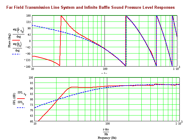

Here's the projected frequency response:
You can cure the slight rise with either a touch of series resistance or a 1 long port instead. However, I deliberately aimed for a slightly falling response or this thing will become very bass-heavy in-room.
ML TQWT first.
Line-length: 60"

And here's the response of a straight, Mass Loaded Transmission Line. For more on these, Look at Martin's FE208Sigma and Lowther MLTL projects. They look like bass-reflex cabinets, but they don't behave like them!
45" internal height.
Internal width 11.5"
Internal depth: 14.35" (So & Sm=3Sd)
Driver at 33.75" up from internal base. (0.25 of line length from the top)
3" wide by 2" long port 3" up from the internal base.
Note: with both of these designs, you can put the assumed midrange and tweeter wherever you like, within reason. They shouldn't affect the cabinet etc. In the case of the MLTL, I'd place them above the B139. Actually, if you did that, and were using a midrange unit, you could lower the B139 to 22.5" from the internal base of the cabinet, which would remove the touch of ripple you can see. Again, I was aiming deliberately for a slightly drooping response to compensate for room-gain.
In the ML TQWT, unfolded, I'd probably place the mid and tweeter below the B139. Folded -your call. These MathCad sheets of Martin's are staggeringly accurate by the way. This is exactly how these designs will perform in anechoic conditions, assuming they are built correctly and the drivers are working as they should. However, as our friend has above mentioned, the bit you want to be paying attention to in both cabinets and graphs is below around 200Hz: above that, you'll need a decent midrange unit. That's fine: place it in a location like those I suggested above where there is some stuffing and that should flatten its behaviour nicely!

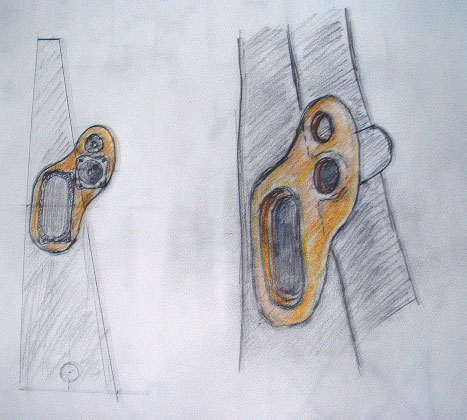

Hi Scott.
Just a quick question, as you're the Worksheet Wiz.
Would the simulated behaviour of the line change at all in the TQWT if the driver was mounted on the tapered side, and can the software even differentiate?
I'm sure it wouldn't make a difference, but MJK's work has caused me to question my assumptions on TLs many times before, so I'm now back to asking beginner questions! 🙂

Hmm. A very good question. Not in the current worksheets is the answer. That will change a bit around March though when the updated sheets emerge. Until then... Well, I'll do my best, though I'm still learning myself.
I wouldn't expect the behaviour of the line itself to alter much, whichever face you put the driver
Mounting a driver on the trapezoidal face like in Martin's Project 2 ML TQWT (and the layout I think would be best in this case) is a much better, albeit more 'interesting' idea than sticking it on the sloping side in my view, and I think your main query, correct? Now that will almost certainly have an effect on the speaker's response, not because of internal changes but because of differences in baffle-step. As it is a different size and shape to the other panels, it's probably going to need different values in the correction circuit.
Best
Scott

That could work really well. Nice idea! You'd just need to juggle the mid-dome pod enclosure so it could get down low enough. That should be easy to do. Actually, now I've done some checking, I think that the 139 could be OK up to around 800Hz or so, which should make life easier for whatever it's crossed over to. And maybe even allow the midrange to be dipolar too!

Scottmoose said:...And maybe even allow the midrange to be dipolar too!
My thoughts exactly. I have some nice Fostex mids I might use, I was going to give two away, but now I'm having second thoughts. Now all I need to do is blag some tweeters from somewhere, and the drivers for this project will have cost me nowt!

pinkmouse drawings
That Design looks great it would certainly stretch my woodworking skills, any idea of the dimensions?
Thanks again to everyone for their help
Regards Roger
Regards Roger
Dimensions of the tower are exactly as stated in Scott's ML TQWT design on the last page. I was thinking of hardwood for the front curvy baffle but thick MDF or ply would be cheaper and easier to work with. The dimensions of that part will change depending on exactly which drivers you work with. I haven't run any sims yet, just sketchpad ideas at the moment.
