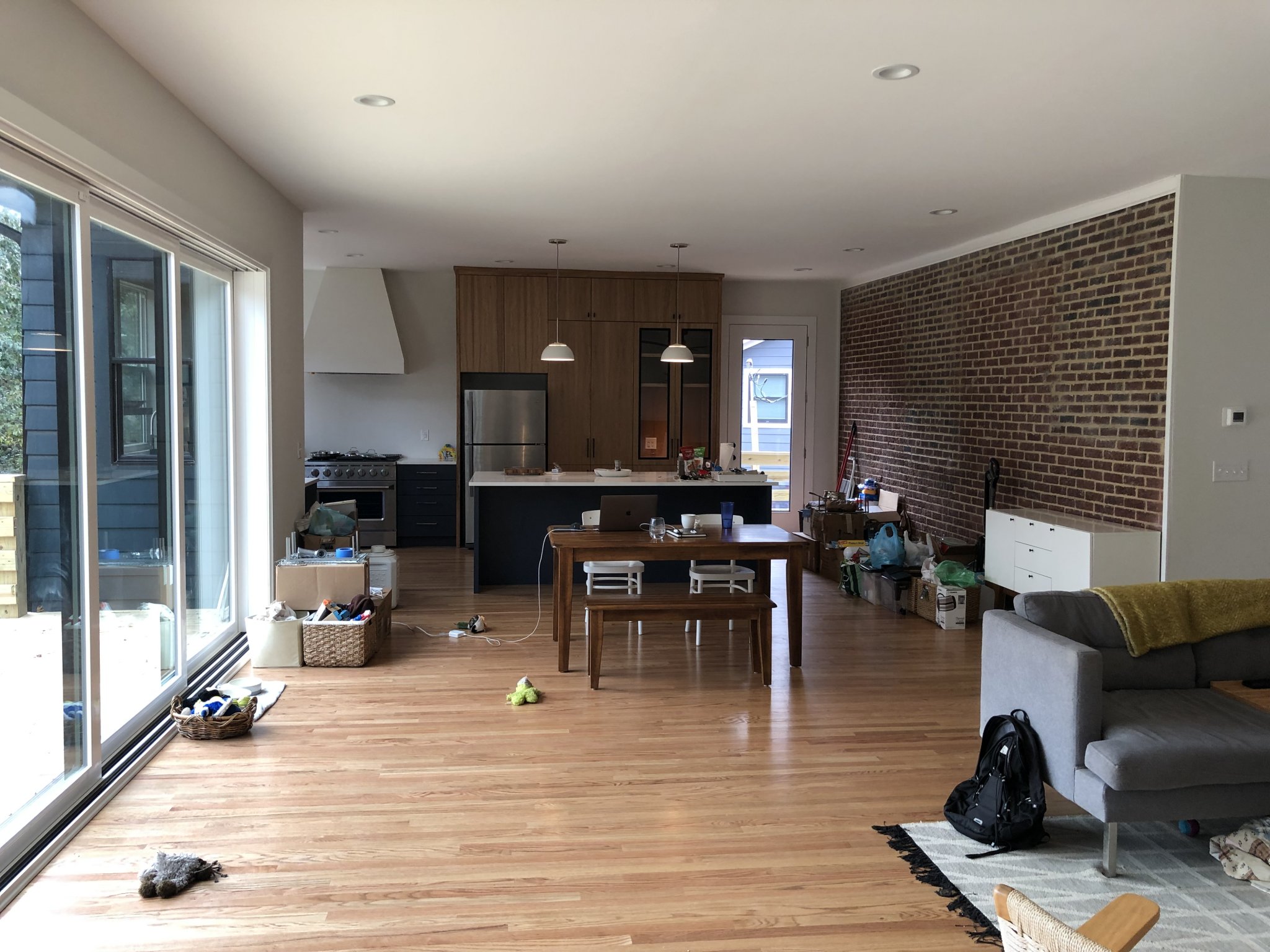

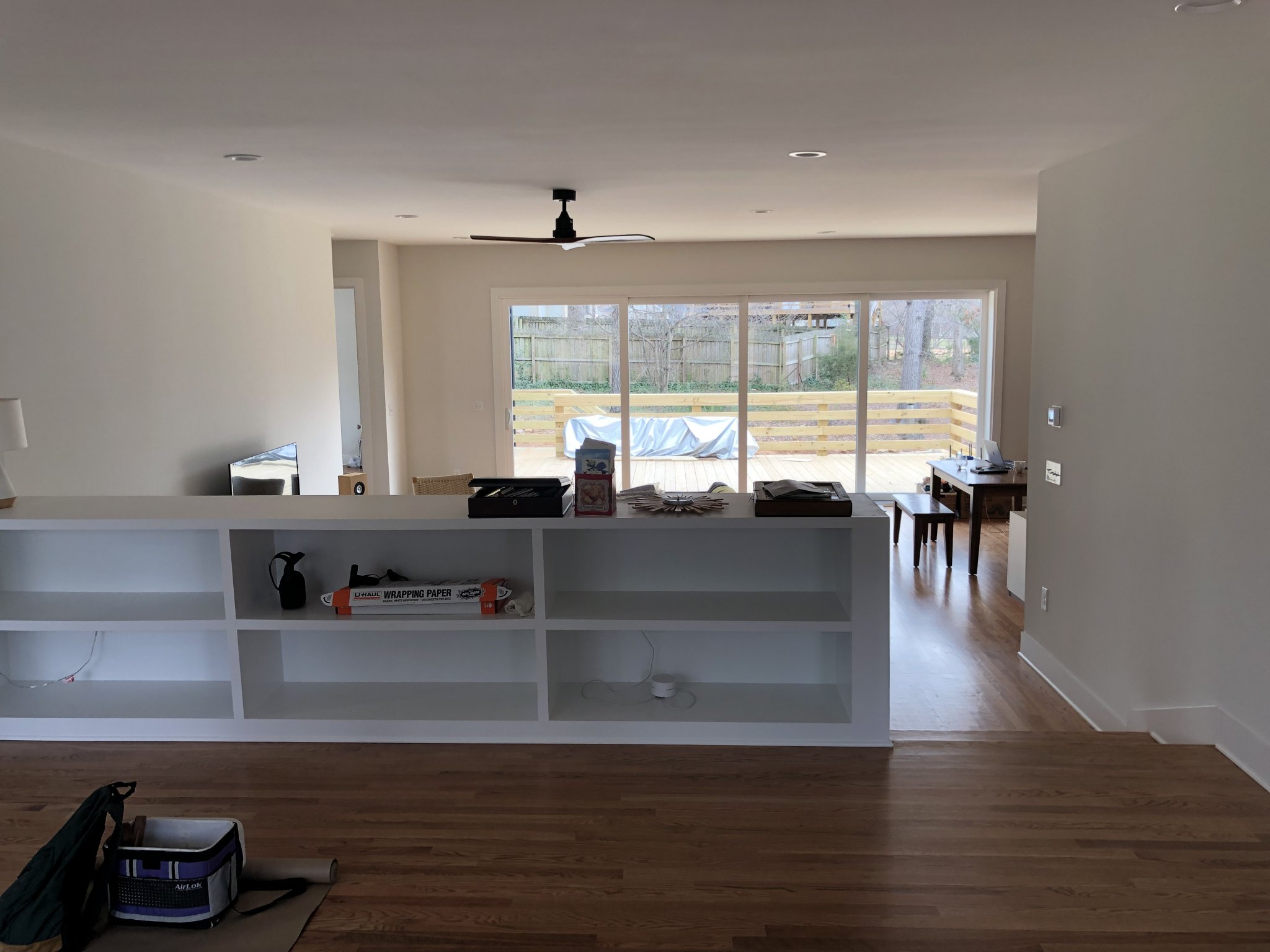

Also, I built those pensils for a small room in a 900sqft house, and we have just finished remodeling up to 2400sq ft and we now have a very large open area comprised of living room, dining area, kitchen, and entryway lounge. There’s also a 20’ sliding glass door in the space. Visually, I love it, but acoustically is going to be a challenge. Photos for reference (excuse the mess, we’re still unboxing and moving back in).

Basically any competently designed speaker kit should perform reasonably well within your entertainment center. The ones meant to be placed specifically in open space, will be a bit bass heavier, which may very well be a desirable feature. I would make that a 3 way, a 10" bass in a sealed cabinet.
Thanks, while I do appreciate a clear midrange, you’ll never hear me complain about extra bass. Especially with modern music I could argue that bass is more important than clarity…and I do listen to virtually all genres of music. Everything from classical, to jazz, to good country (Sturgill Simpson, Johnny Cash, etc), Americana, hip hop, rock, etc…
