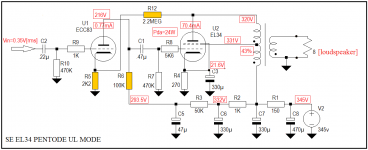

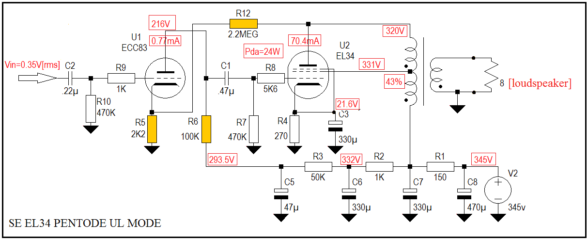

this is my mod of a cheap chinese amp kit I brought and works much better !!
I would change the time constant between the two stages by lowering the coupling capacitor to 47nF. Just my two pennies.

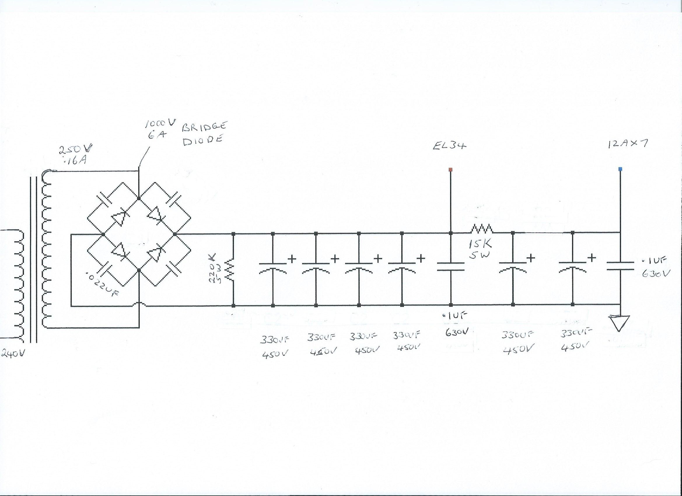

this is the kit I brought totally mod it replaced the 6N9P with 40 year old 12AX7 and put 6@330uf caps in the power side which smooth the power supply.
A vacuum rectifier feeding a huge capacitor bank will not last very long. I hope you didn't increase the reservoir cap, but just the smoothing caps.
I did 2 tube amp the 1 I'm talking about with 6@330uf has no rectifier tube I did a solid state bridge rectifier like the pic attach
