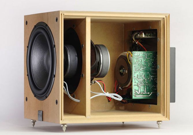

If one compares the sensitivity of two drivers side-by-side* with a single driver in half the box volume it is + 6 dB for parallel connection and 0 dB for series coonnection.
There has been several threads on this in the past, and it is a bit counter-intuitive, but it comes from that the efficiency actually increases when two drivers are mounted close to one another (compared to the wavelength).
*non-isobaric, either normal monting or push-pull.

I have questions about push pull subwoofers when the woofers are mounted on opposite sides of the box. There are 2 scenarios as I see it for the cones to operate facing outward:
1. When the front and back woofers to work in electrical phase; i.e., when the front woofers are moving outward the back woofers do the same, thus resembling a monopole.
2. The front- and rear-firing woofers are working in opposite phase with each other; when the front woofers move outwards, the rear woofers move inwards. In this operating mode, the whole system works (sort-of) as a dipole system
What are the inherent advantages to each? With scenario 1 I can see force cancellation via opposing forces and lessening box coloration, though I do not think scenario 2 provides the same advantage.

Push-pull becomes less and less effective as frequency rises. The distortion reduction happens in summing, so coupling is important. Once you get above 100-200Hz, shorting rings start working so that might be a better option from midrange frequencies up.
But the bottom line on push-pull is coupling is your friend and asymmetry is not. You want the two drivers as close as possible. You also want the forward-facing air loads for the two drivers to be equal and the rear-facing air loads for the two drivers to be equal. Whatever configurations you can come up with that do this most effectively will work best.

You will get more benefit from push-pull drive when two identical speakers without shorting rings are used. Shorting rings reduce distortion, so drivers without them generate more distortion to remove. That's not to say having two distortion reduction mechanisms is a bad thing though.
The important things for push-pull drive are symmetry and coupling. You want both drivers to be matched and have the same acoustic load on their forward-facing sides and also the same on their rear-facing sides. You also want them to be as close as possible, within 1/4 wavelength at most.
