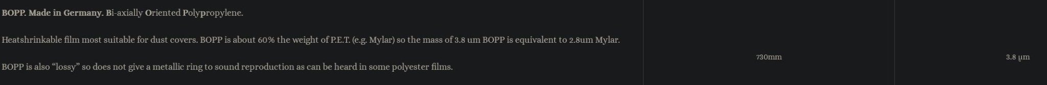

Yes, you don't think it is too thin, the mylar I use is 12 um.
But this comes from Australia, do you know of any European dealer where one can buy without being a company?
Yeah, I thought so; it's seemed like an old name.
Nevertheless, that's what the seller wrotes:
Tillverkade av BOPP film, vilket i dagligt tal kallas cellofan men som är en polypropylenfilm.
Googlle translates the above to:
Made from BOPP film, which is colloquially called cellophane but is a polypropylene film.
So BOPP is less suitable then?
