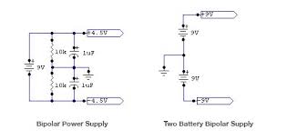

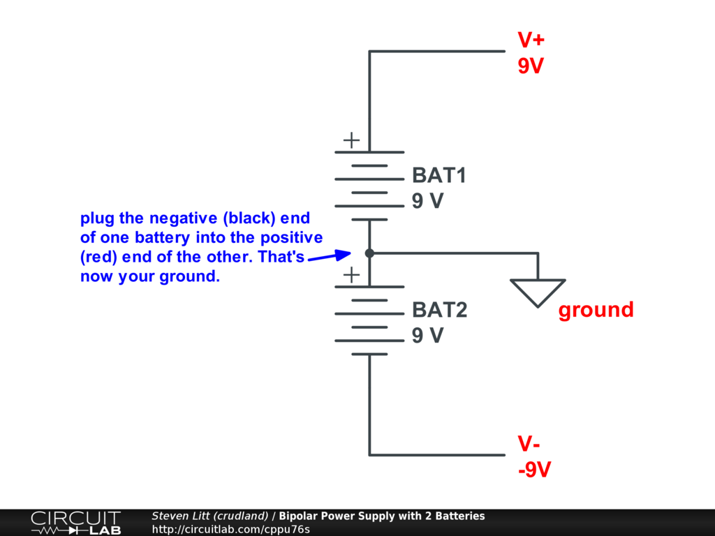

Roger, do you mean what is ground? The same thing that is ground in any series-stacked ("Bipolar" or "+/-" ) PSU... the middle of the two supplies.

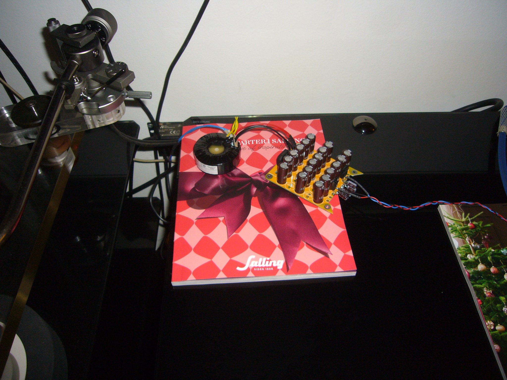

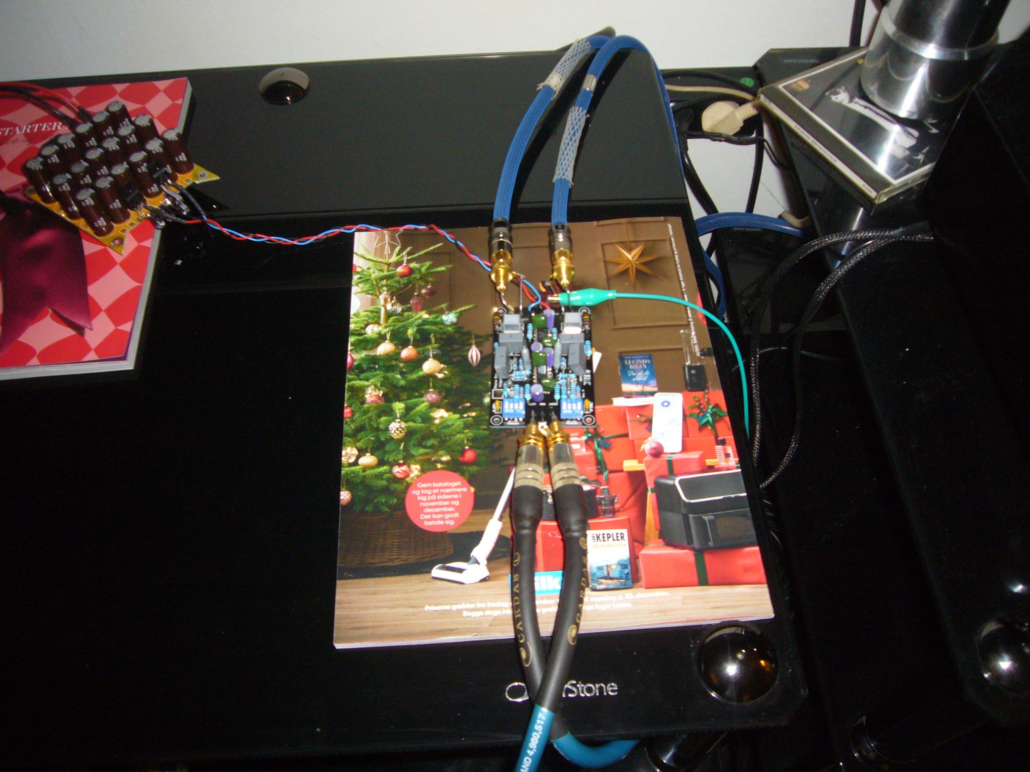

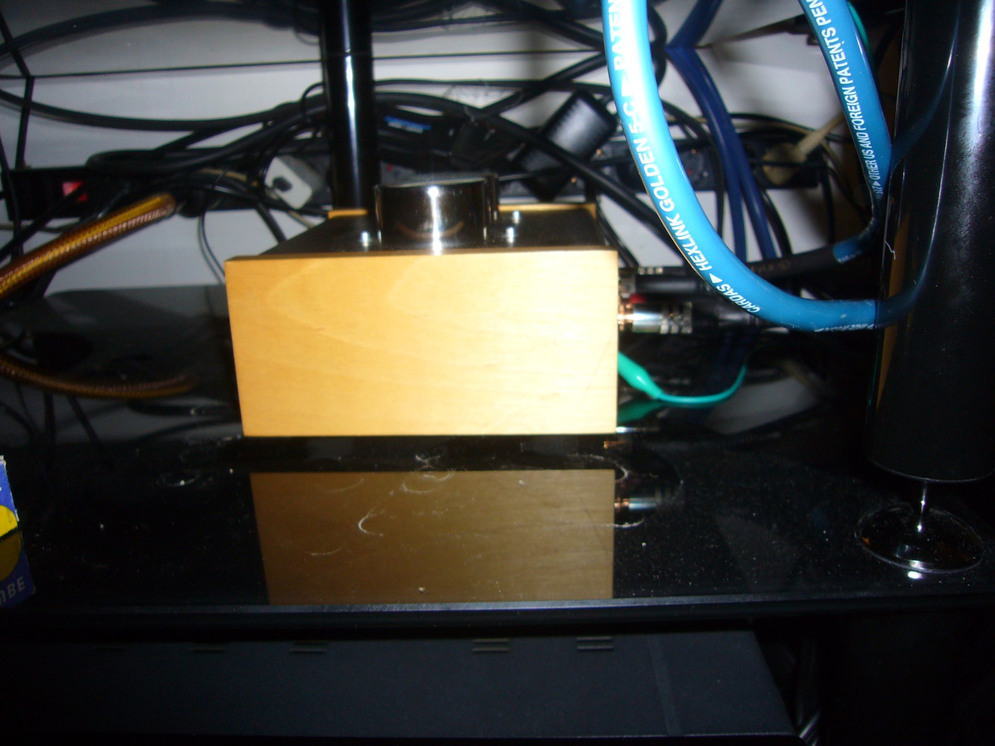

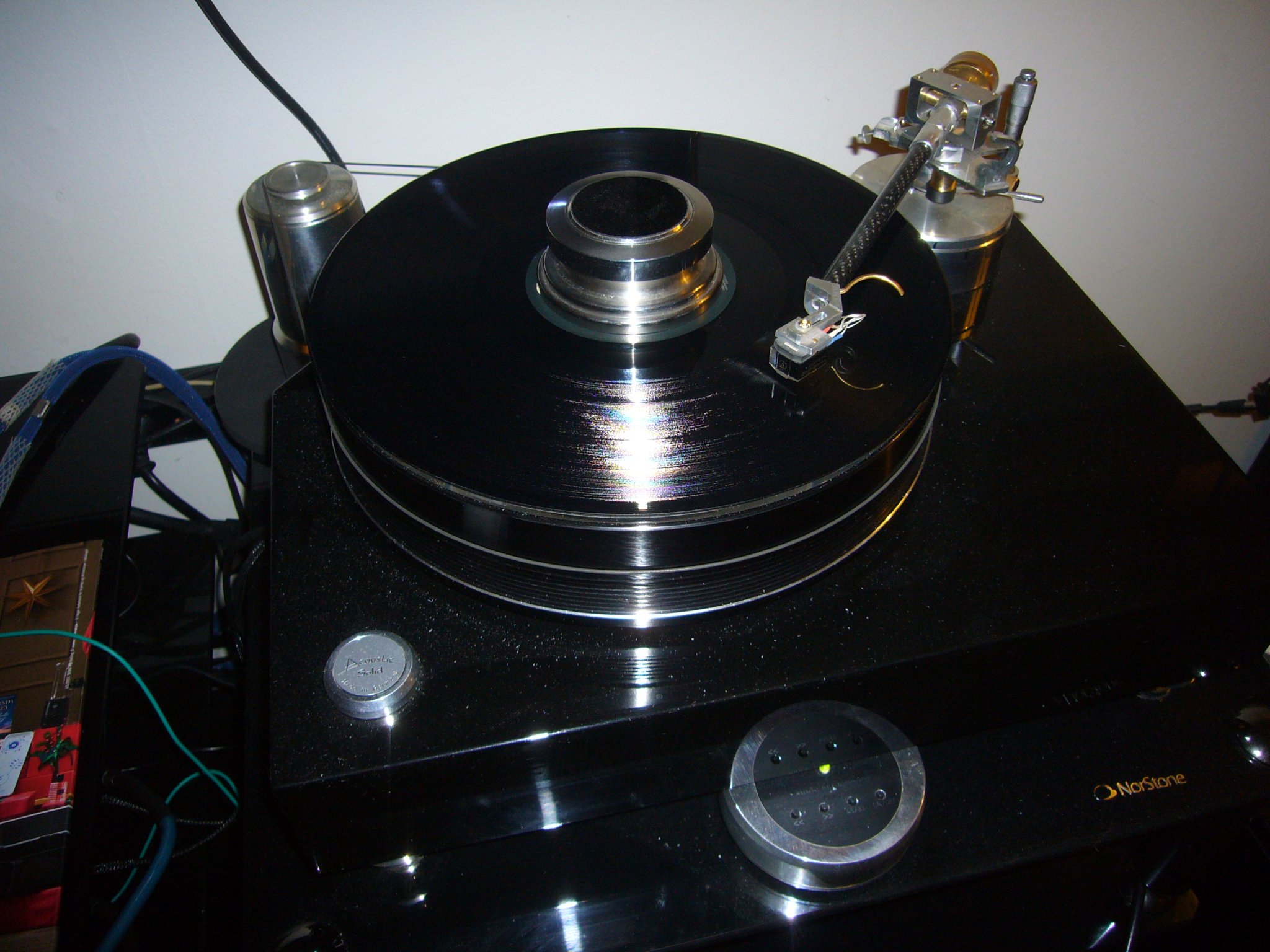

Well..... sold my X-Ono clone a couple of days ago, and just neede something to play vinyl....
This is what I got... A couple of hours...... Just grabbed whatever I could find, res. and caps form the waste bin.
Riaa is placed 20cm beneath a 55" plasma screen, which is "ON".
No hum, no hiss, no nothing besides music 😛
From an AT-33PTG/II into a diy stepup (Silk audio transformers) to the riaa..... sometimes it´s about construction more than
screening the sxxt.......
