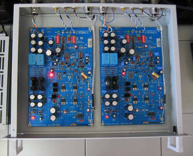

Hi to all ONO builders,
A piece of advise, about the 2SK 170 GR it took me about 30 of the same batch to have 2*4 pieces perfectly paired {<= 0.01volt}.
Good DIY building...
PS: I already have 2 ONO boards ready! waiting to finish the enclosures!
Regards.
Alain.
Regards.
Alain.

Hi Alain,
I got my 2SK170 and managed to match them with Dragan's help. He suggested using the same circuit as the Ono, applying 15v and measure the voltage at the 22 ohms source resistor. Now waiting for more components to complete the board. The enclosure or cabinet is another hard thing to find in this part of the world. They are all the standard aluminium casing, not that good looking.
Best Regards SK
Best Regards SK

Sry I was a bit unclear. I meant I have the Ono pcbs, they are waiting on a pile of other things. The Ono project will not start within the next 4-6 month I think (unless I get fired and have a lot of time to fill).
Btw How does it sound and what pickup do you use?
It also took me some time to get all the components. I also ran it in for many hours. The sound is very good, clear highs, beautiful mids and good bass. I did not have any regrets starting this project. You should start it ASAP. The 'flexible' loading resistance helps in finding the best sound for your cartridge. I am using it with my LP12, Ittok and OC9 Mk2🙂 🙂 🙂
