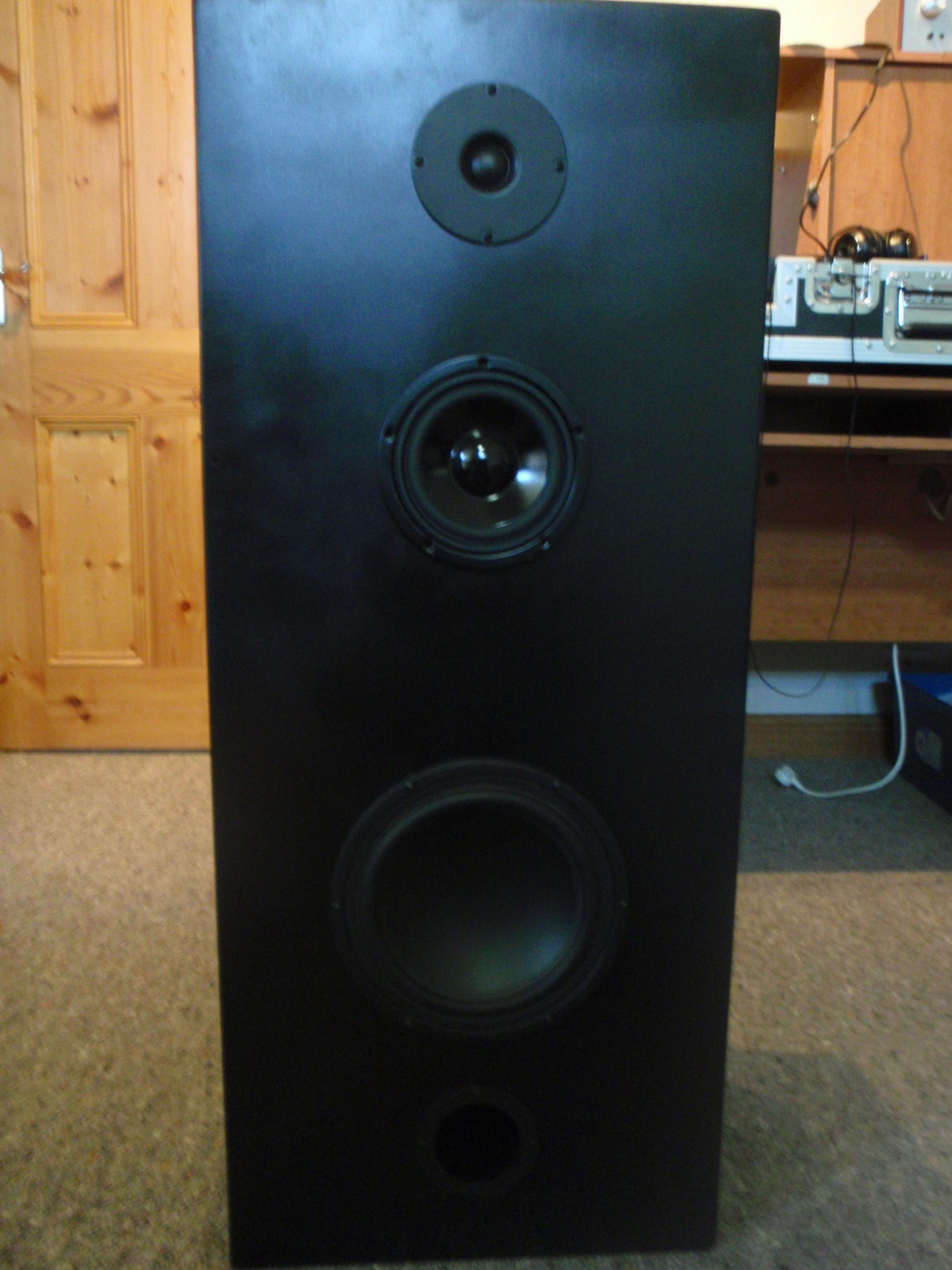

Finally found the time to build them, took over 25 hours in the end!

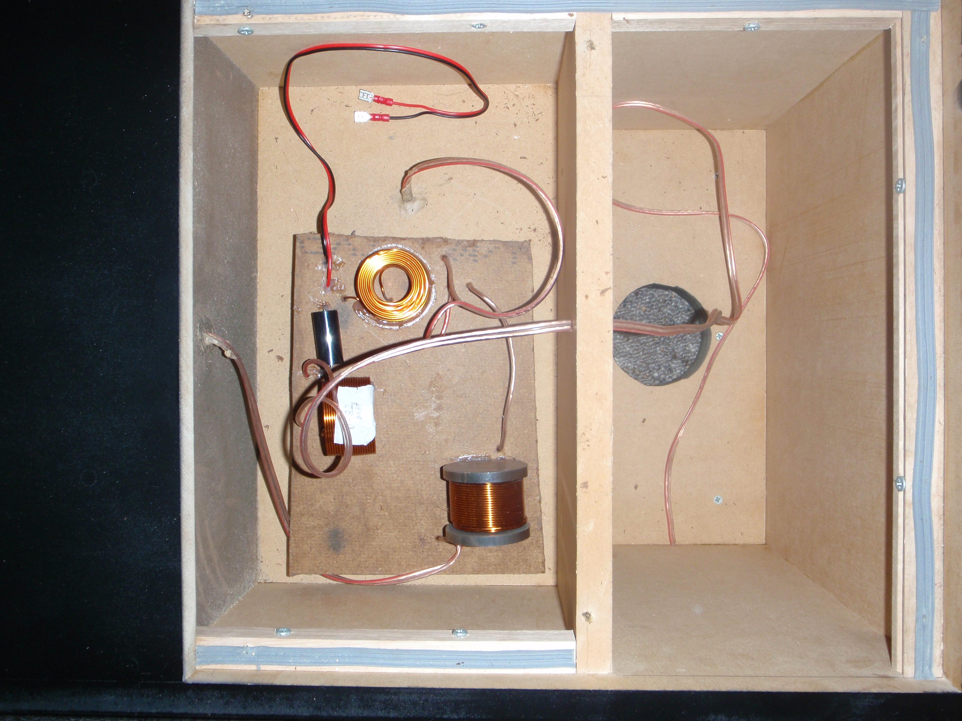

Bass driver is in a 44L ported box (66mm diameter, 186mm long), midrange in a 7L sealed (as per website).
Made out of 3/4 inch MDF, double thickness front wall, each join glues on at least 2 faces and screwed the same, if not from more! Sprayed black.
Crossover's wired in (Not the nicest of looking jobs, but that doesn't matter...), Zobel soldered directly to back of 5" mid.
Treble sounds really good, 8" in 44L sounds really nice, strong deep bass, 5" midrange is good when it’s used as a midrange, however has a really nasty boomy crappy sound when deep loud bass occurs (Which is predominantly the style of music that I listen to....)
Now is this a con of having a 2.5 way setup as opposed to a 3? Is there anything I can really do to reduce the mid from making this sound without doing a 3 way conversion?
One thing that did worry me slightly in construction was due to the size of the 44L, it meant the 7L for the midrange had to have its depth reduced to 100mm to make it fit within the space confines... This only leaves 40mm of air at the back once the driver has been fitted. Could this possibly be an issue? If it is I will just have to live with it....
Chucked a couple of photos up for those interested, if you want anymore just tell me =)
Cheers guys and thanks for all your help, I have really enjoyed it!

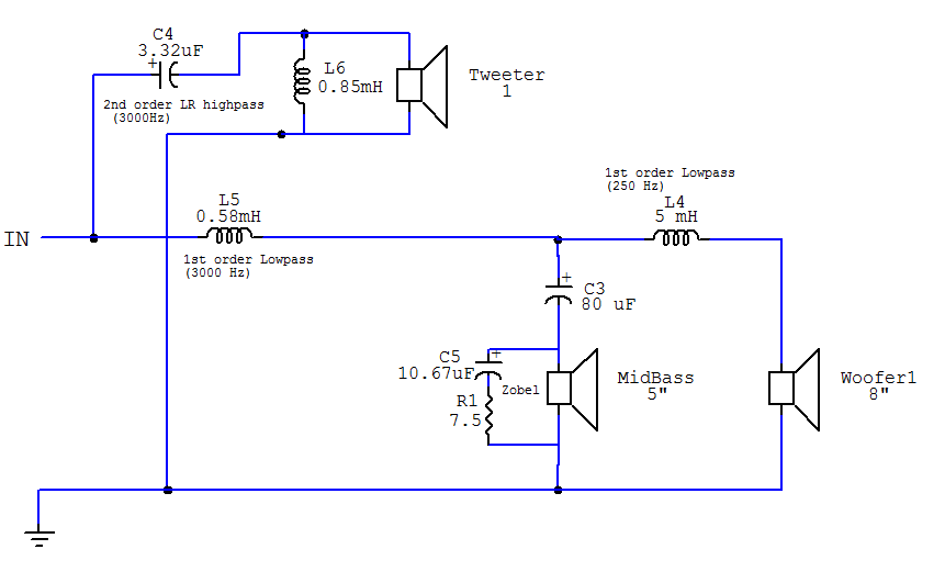

Hi Felix, you need a bandpass filter on the mid to turn it into a three way. That is a high pass filter followed by a low pass filter.
So you would need a 250Hz high pass and a 3000 Hz low pass on the mid, and you would have the mid and the woofer in parallel not series. So yes you do add a highpass in front of the mid... I assume the circuit you posted was the current 2.5 way implementation!
Tony.

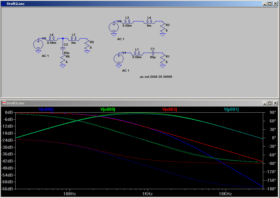

That doesn't look right to me, I think you will get a pretty funky transfer function for the 8" with that (could be wrong as I haven't designed any three way crossovers, just going off what I have seen before and read).
I would say you need to parallel the 8" from the speaker terminals not after the bandpass for the mid.
Since the current implementation is a 2.5way the current filter for the woofer includes the .58 mH coil so it will change a bit if you only have the 5mH on the woofer.

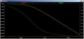

So if you wire the woofer completely separately it should be fine... I just used spice to see the difference with and without the .58mH coil (for a 8 ohm resistive load) it only makes a small difference. Red is with 5mH only.
edit: just attached a second spice sim comparing the two topologies. Not as funky as I thought it might be, but this is only using resistive load, so will almost certainly behave different when a real driver is in the circuit. The Green and red curves are with the woofer and mid circuits separate, the blue and turquoise traces are the topology you posted. But as I said this is spice a with resistive load.
Tony.

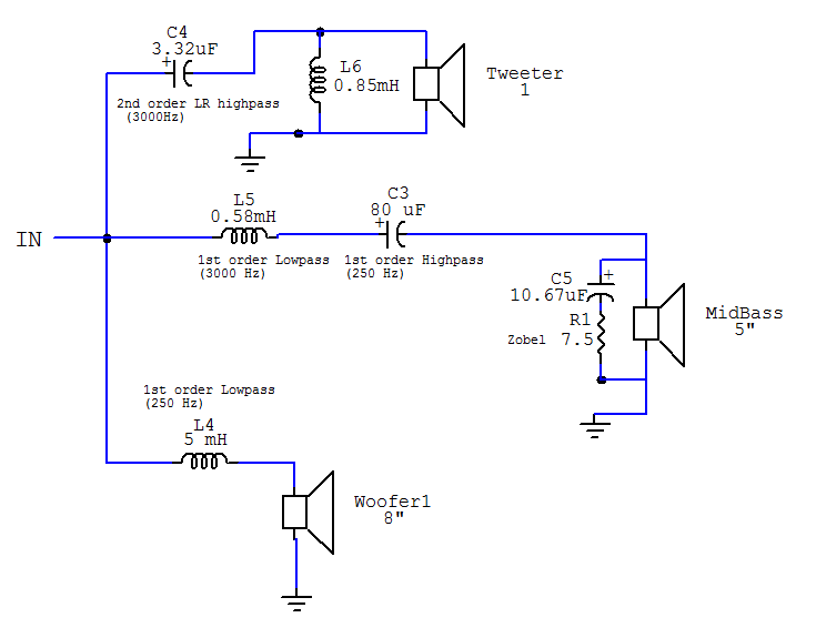

Would this then be the correct XO? I can't see that it makes any difference which way around you have the capacitor and inductor in that band pass, but out of curiosity is there a difference in which filter comes first?
Thanks for your help!
Felix
looks good to me 🙂 As far as I know it shouldn't matter whether it is cap - coil or coil - cap. Often it is shown cap-coil but I think that is just because it is more intuitive when viewing the transfer functions 🙂 ie it ramps up for the cap and ramps down for the coil.

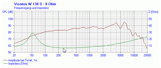

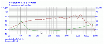

Hi Felix,
I just had a look at the visaton graph, at 250Hz it looks to me like the impedance is closer to 6 ohms (assuming this is the right graph W 130 S - 8 Ohm - Soundlabs Group) bit hard to tell but I'd say somewhere around 6.2 ohms.
By measurements I mean at a minimum impedance measurements of the drivers mounted in the boxes. Ideally also acoustic (ie freq response) measurements of the drivers in the box as well 🙂 (as then you can do actual crossover simulations and optimization).
You can do impedance measurements with a decent sound card (any modern motherboard with High definition audio on board will probably be fine) and a jig, I use the walin jig II, but you can also do it using Claudio Negro's cable jig and a freeware program called speakerworkshop. If you want a no hassles solution (getting up to speed with speaker workshop can be a challenge) then the woofer tester 3 is another option. Note that I do not use an amp when doing impedance measurements I do it straight off the sound cards output.
I've attached the graph below that I was looking at and arrowed 250Hz.. the impedance ticks are 2 ohms each...

Oh wow, turns out I can't read a graph properly! (Yep I took those spaces as 1 ohm each 😀 - My bad).
I'll have a look into measurements, however my laptop only has a stock soundcard, and the output died a month or two ago (but works randomly every now and then...), so I may have to get set up on some different gear.
However since I have already made the boxes and pretty much the XO, I am only really looking for a small tweak to it to drop those low frequencies from the midrange!
Does that calculation of 80uF sound about right? It's a lot higher than the other HP filter, however at a much lower frequency and I understand that they would not be in a linear relationship...

I just plugged in 250 Hz and 8 ohms and it said 79.5 uF (pretty close to your figure of 80uF so I guess the calculator you used was ok 🙂 when I put in 6.2ohms it comes out at 102.5 uF 6.4 ohms is 99.3uF so I reckon 100uF is probably about right.
