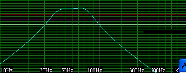

I am building my first BP box to use in my HT setup. I am using a 12 inch car audio driver (audiopipe tsv12), I ran it on Winsid and the curve is the following. Do you think it will sound nice on a home setup? I plan on crossing it at 70 hz, but I am afraid of "one tone bass". Any suggestions?

With a bandpass like this, you'll only get output from about 40 Hz to 60 Hz... I think you can do better, unless you're looking at high SPL only.

Thing is, WinISD suggests either a sealed or 4th order BP due to high EBP, so that´s why I am going for that design........

I'm with grumpy Bill. I've never heard a bandpass sound good anywhere but in a car.
Not natural sounding

The sound quality of a 4th order bandpass isn't that great.
For kick a** bass I recommend a dual-chambered bass reflex;

These are the specs of the speaker:
QTS 0,56
QMS 3,85
VAS 54,4 L
QES 0,62
FS 33hz
SPL 88 db
RE 2x4 ohm
PE 300 w
Le 1,85
Xmax 8,0
Does anyone think it can work on a ported box?

Yes, it can always work in a ported box, I never look at the EBP number.
You could tune it around 20-25 Hz I guess.
I get 24 hz. F3 & Fb
Box size 13wx24hx22d
Port 3" x 19 1/4"
At 24" high the board that seperates the two chambers would be 8"
So the small chamber would be 8" the large chamber would be 16".
Power rating before Xmax & Port Chuffing is 150 watts.
Both at 25 hz.
Total box volume is 87 litres.
Yes, It's Do-Able!!!
