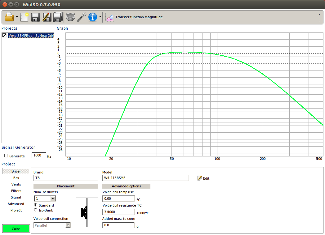

Hi again,
So played around a bit more with WinISD and came up with the below posted image.

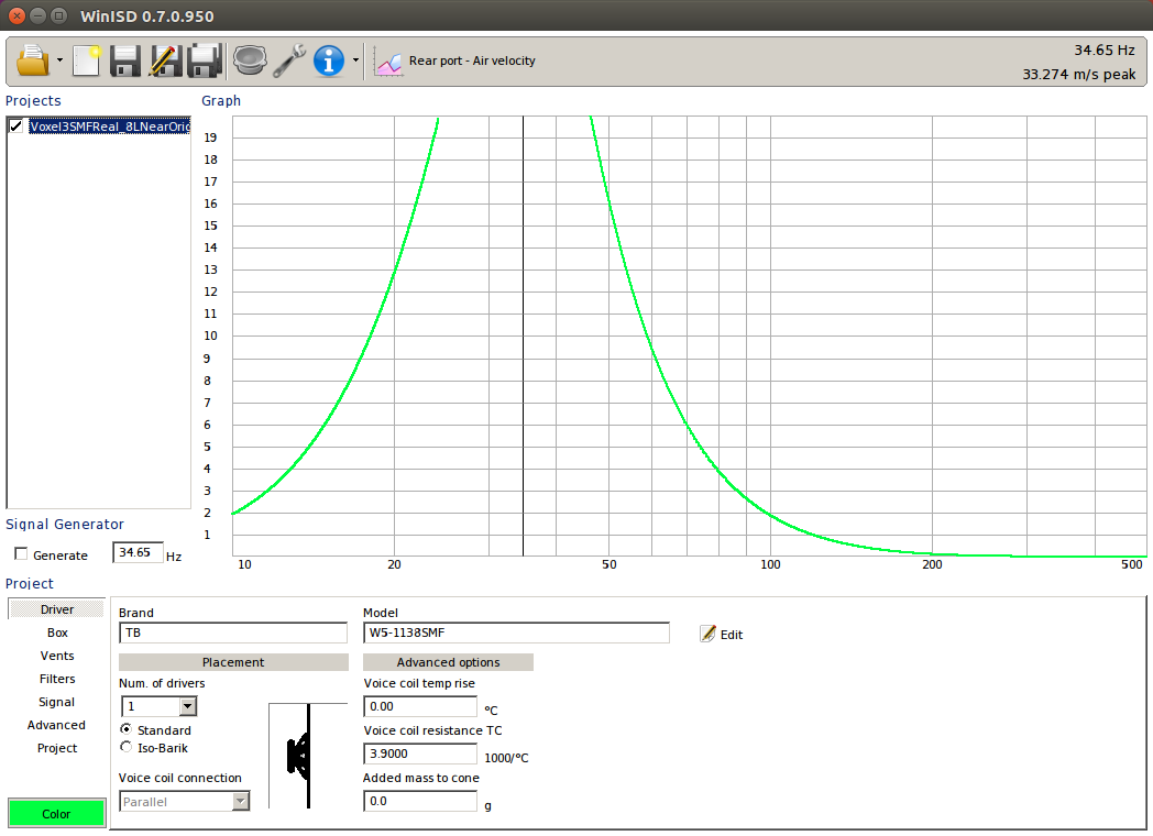

The F3 is about 34.5Hz with a 9L box, 40x275mm tube length and a tuning freq of 37. Port air speed should be around 5.3m/s according to the graph, though I think it sounds low.
What do you experts say about this?
Is there anything more to check?

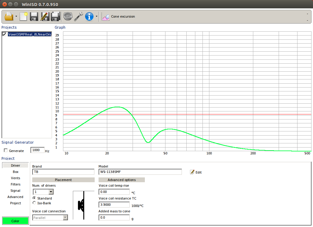

I'm sorry but don't know what you mean. The cone excursion varies between 0.6mm and 1.7mm during the sweep and the power is set to 40W. I am total noob at this so please tell me how to check 🙂
OK, so you have checked that 40 watts only produces an excursion that varies between 0.6mm and 1.7mm, and port velocity of just 5.3m/s.
The Tangband W5-1138SMF (Ferrite magnet) and neo magnet W5-1138SM both have a 9.25mm Xmax, so if you increase power to reach that level of excursion, the port velocity will also increase.
If you plan to use enough power to peak at 9.25mm excursion (probably over 200 watts if the information above is correct), the port may be undersized, but if you are not using more than 40-80 watts, it's OK.
Increasing the box size to around 13 liters (net) would make for more output using the full excursion potential without exceeding the 80 watt maximum power rating.

Apparently I made a mistake. The cone excursion is 0.6-1.7mm when input is 1W. When i put system power to 40W I get a peak of 11mm @ 23Hz with a 9L enclosure. Also i get an air velocity of 35m/s. How the ** did people design a small sub with this driver? 🙂

Some numbers on my current design:
Box: 8L
Port: 39x280mm (will be flared)
Tuning freq: 38Hz
F3: About 35Hz
See attached files for graphs. This is close to the original design of the Voxel sub which I also modeled. Any suggestions on improvments?

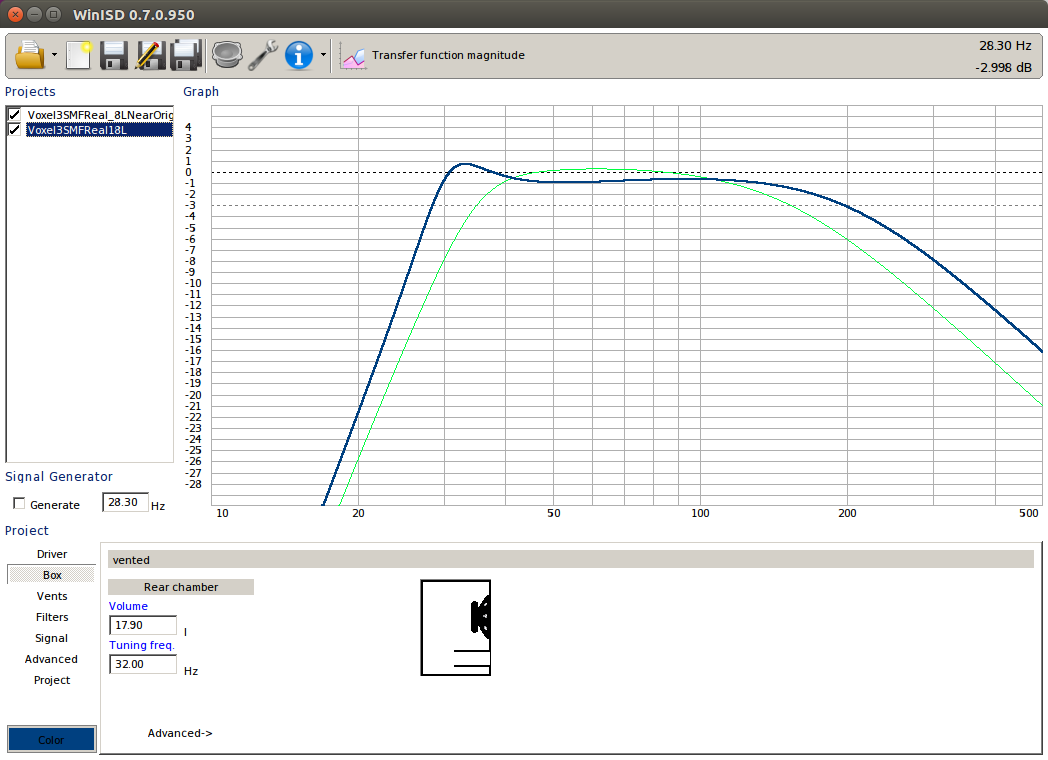

I also modeled a 18L box to see the difference. It would actually fit here so I'm thinking about building it instead. I reached a F3 of 28Hz and a tuning freq to 32, with a slightly different response, see last picture. Cone excursion about the same and air velocity below 29m/s.

5)I also modeled a 18L box to see the difference. It would actually fit here so I'm thinking about building it instead. I reached a F3 of 28Hz and a tuning freq to 32, with a slightly different response, see last picture. Cone excursion about the same and air velocity below 29m/s.

2) Excursion increases rapidly below Fb, the speaker "unloads" as it would in open air.
3) You can model the behavior at different drive levels that your amp will be capable of. In reality, the excursion will likely be a lot less than predicted. A steep 24 dB per octave BW (Butterworth) filter can be placed around 1/6th octave below Fb for protection.
4) If pushed hard enough, the driver can be damaged by over-excursion, but will probably make some nasty sounds before damage (Xlim, Xmech) occurs. If the voice coil hits the back plate when pushed hard, damage can occur in one cycle, but likely the suspension will reach it's end stops before that happens. Push in on the driver with your fingers to get an idea what happens past Xmax.
5) There is not a lot of program material below 28 Hz in most pop music, but the extra extension of the bigger box would be an improvement over the 38 Hz tuning, and won't "flap" as easily if you don't use a HP filter.
If the port velocity is high enough to blow out a candle at 30 centimeters, turn it down ;^).
