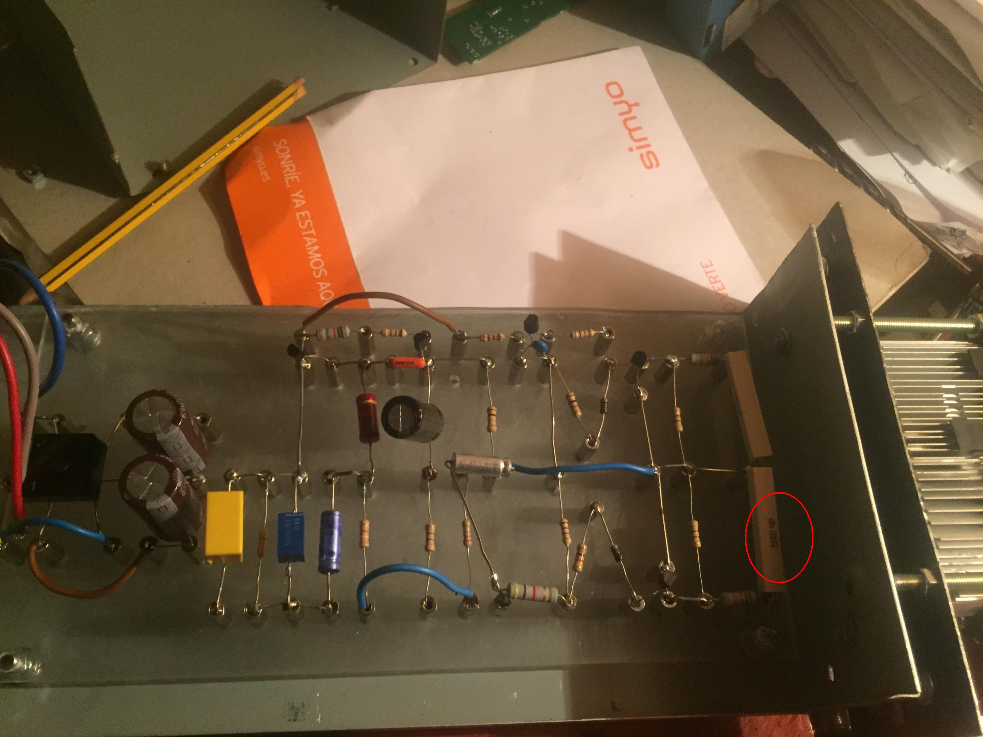

So the diode removal has proved it was limiting.
I'm going to add the following comment based on the fact you mention being able to get the volume 'high' even with a 27 watt bulb fitted (presumably the bulb is in the incoming mains feed)… and that is to check the current limiter components are correct, in particular that the 0.33 ohms really are 0.3 and not 3.3 or something like that. Also check that the 470 ohm and 1k5 to each limiter transistor is correct.
If you think it plays loud with a bulb fitted then it certainly shouldn't be limiting under normal conditions. The bulb will absolutely kill the power available (as it should) and so it should play far louder even with the limiter connected and running on full supply.
36 volts rails should deliver around 50 watts RMS into 8 ohms and the peak current in each output transistor would be around 3.5A approximately. That would develop a voltage of just 1.1 volts across each 0.33 ohm and that would not be able to activate the limiter.
So its great you have proved the limiter seems to be the problem, but something doesn't add up because it should really be cutting in at even full output.

I think you have to, but it would also be good to try and find out why it behaves as it does. That would involve using a scope to look at the limiter action under real conditions and to see at just what peak output levels the protection triggers at. It would also show if there were any other issues such as instability that could be causing a problem.
Are you sure the speaker loading isn't to low an impedance ? That would draw more current than expected.
ok. First of all happy christmas to all of you!!
I've scoped output. What I thought it was loud... it wasn't, really. But as I used it with guitar distortion, I could not distinguish the clear guitar sound, so I thought it was the preamp distortion.
When I scoped output before clipping, the AC Voltage in output was 14V.
When I scoped output playing loud but with distortion, which is not annoying in guitar, 39V AC.
W(rms) = 14*14 / 8 ohm = 24.5 Watt.
Something is still wrong here....
Please help!!

All these measurements were in the output of the amp with the 8 ohm load attached. The 14V AC RMS is a real measurement of the voltmeter, just before clipping.
The 39V AC was a wrong measurement because I put the maximum gain in preamp and the amp was obviously clipping, but It was really loud. Obvously I did this in a short preiod of time to prevent damaging FETs.

With full overdriven square and 8Ohm Speaker at +-50V supply rails 39Vrms might be obervable for a short time (until the speaker is burned).
Try this...
With NO load attached adjust the output to give 10 volts rms as measured on the meter. The scope will show around 14 volts peak (28 volts peak to peak).
Now connect your 8 ohm dummy load to the output.
The amplitude should remain unchanged. Does it ?
