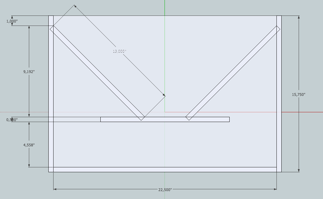

I am building jbells hs12 from this post and came across a problem.
There should be a one inch setback for the grill but if my calculations are right there is not enough room for the driver left. The datasheet for the beta 12-a2 specifies a depth of 4.57 inch which is about exactly the room left but building it I see that I miss about 2/3 of an inch.
attachment.php
Now to fix it I think I am just going to place the baffle/horn a little to the front. Would the added volume be a problem? I have tried to model it in hornresp but that was a little over my head. I hope somebody who built it as well can enlighten me.
Also, there is a vent located in the back of the speaker. Placing it tightly to the back of the enclosure would close that off and possibly impede cooling. Would that be a problem?
Then I am also worried if placing the driver tightly to the back might resonate or rattle. Should I better keep some clearance with the effect of adding even more volume?
Thanks for your help!

Hello everyone.....I know this thread is a little bit dated, but have been considering building a set of stacked HS12s myself for a sound system. Like kzy, I too noticed that a lot of possible drivers will not fit the cabinet plans as released. I have a set of Delta Pro 12-450s that are an inch longer than the space alotted....even the recommended Dayton 12" really should not fit either.
Have there been any revisions to the dimensions to accommodate deeper drivers. Is it safe to lengthen the box an extra inch or so, so the drivers fit and have room to breath.

Volume changes of +/-20% are within the error margin. So you can simply make the enclosure deeper. I would suggest that anyway because you are blocking the pole core venting anyway (which is very bad for cooling). Plus, that's much easier than fiddling with the angle and you could at any time add another little box which uses up the same volume and put it in one of the corners.
Thanks for the input ICG......I suppose by the time you add a couple recessed handles on the sides, you would lose some volume anyway. I guess you could also add some rigid foam insulation blocks to the inside of the cabinet to lose volume as well and not add much weight at all......
