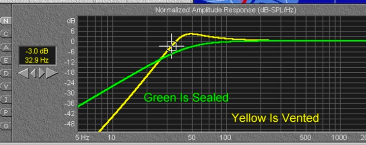

I am building a modest home theater sub - I had an 8" car subwoofer already and since I don't have a HT sub or the $$ to buy the one I would like I thought I'd see what I could do with this.
I have the box almost built - about 1.2 cub. feet not including bracing, etc. I used 3/4" MDF, sealed with caulk, etc. I have a couple of questions:
1) ports? I plan to use 2 ports - 2" diameter, and according to the only multiple port formula I could find, about 4.5" long each. Does that seem right? According to the formula, that should tune it to about 32hz with the speaker specs and box size.

TS Parameters
Heres the parameters I have from the tech sheet. I don't think I have the equipment to measure it yet, but let me know what I would need (or point me to the proper thread), if you could - I would like to do this with my whole system.
Vas 0.75
Qts 0.55
Fs 36.80
Displacement (CuIn) 38.00
SPL 84.50
Mounting Depth 3 13/16
Qms 10.18
Qes 0.58
Pmax 100.00
Xmax (mm) 7.50
I have a 1.2 cu ft. box half built at the moment (top is not attached yet) - no port holes drilled yet - probably soon though.
The tech sheet recommended a .5 to 1.2 cub. ft enclosure with or without a port. I could definately use some help figuring out the port length/size - I have 2" PVC pipe to use if that will work. If it wouldn't hurt, I would like to use 2 ports (for looks and to reduce the total length of the port).

For the box/port size numbers, use a free design package such as WinISD. Enter the T/S parameters and it will give you a box and port size to start with.

ok - I've been playing around with WinISD (where was this program when I started this project!?!)
According to the program, if I put in a port tuning of 40htz and a 1.2 cb ft box - if I use 2 ports of 2" diameter they need to be 0.182 inches long - does that seem right? Everything I was getting was in the range of 4-5 inches for 2 ports, trying to do it by hand.
I'm using the specs THEY have in their database for the calculations, which could be part of the difference. Are they generally accurate? I'm not 100% on the specs I have as I have an older model and thats the best Kicker could give me (Its a Comp 8" Kicker sub, 4ohm)

In winISD beta (alpha only lists solobaric) I only find two possible matches for the description you gave for your driver "Its a Comp 8" Kicker sub, 4ohm". (assuming the "C" means Comp)
Kicker C-8-4
and
Kicker C8C-4
Neither of them have T/S specs resembling the ones you posted. You'd be better off to get ALL the T/S specs and plug them in yourself, or better yet, measure them yourself and try it.

BTW,
when I modeled the C8C-4 to the box and ports you mentioned it says the port length should be .182 METERS, not inches. Click on the M next to port length to scroll through different units of measurment until you get to in. (came out to 7.17")
The C-8-4 models almost identically to the first (7.18") and has almost exactly the same response curve when overlayed.

That would make sense - 7.17" not .182" - I was having a couple of problems of that sort when I first put the #s in making sure I used the correct measurement. You were right that it is the C8-4 Kicker.
Yep - my program shows the same. I don't know why I didn't try that - i think at first it was saying inches, and it musta got changed at some point.

Hey behnkem!
You see, all it took was those TS Parameters to get the
ball rolling.
The most I can tell you is use the TS parameters supplied
with your woofer. Alot of times they (Speaker companies)
update their specs, and, you will see two different TS chart
listings.
If your speakers came with a TS sheet, use that for reference.
The Program I use is Eminence Designner, and, Bass Box
Pro. The one I posted was the Eminence.
