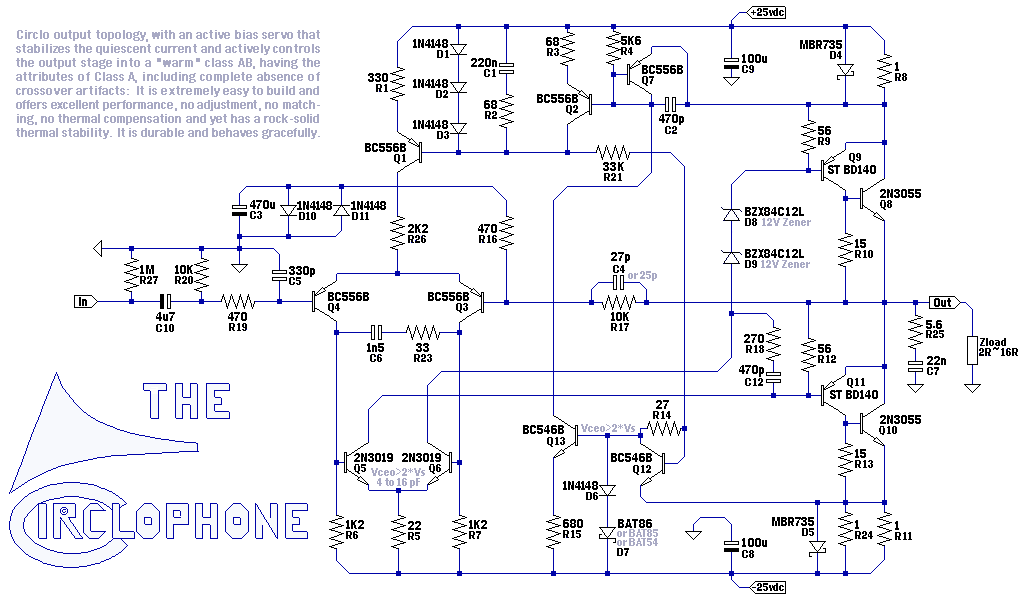

Oscillation
Well, fire hot drivers is oscillation and if you don't have sim, scope handy, what you could do is to change vas components. The deal there is that changing the vas components unavoidably changes the vas compensation because they always work together. This could go nicely or badly. Therefore, if you put on something like the very tame 2sc3421 or the reasonably tame 2sc5171 then the vas comp is probably going to work.
Bias
After verifying correct parts and checking what you can, there's an option to hot amplifier. We could instead lower the bias. That will increase the switching which does increase the THD. Reports of how much distortion increases because of decreasing bias heat, is severely overrated and may not even be noticeable, so here's a chill out:
R14 to 51R
R8 to 1.2R
R24 to 1.8R//R11 to 1.8R (0.9R)
These four resistors are all set together if you decide to lower the bias and they can be changed if you also compare with the post 1 schematic to get the proportions (such as halfway between here and there per each resistor in the example). The above example is extreme and cuts the bias in half. That is shown for purpose of comparison.
SO, If you lower the bias but your amp is still hot, then that means the amp is oscillating.

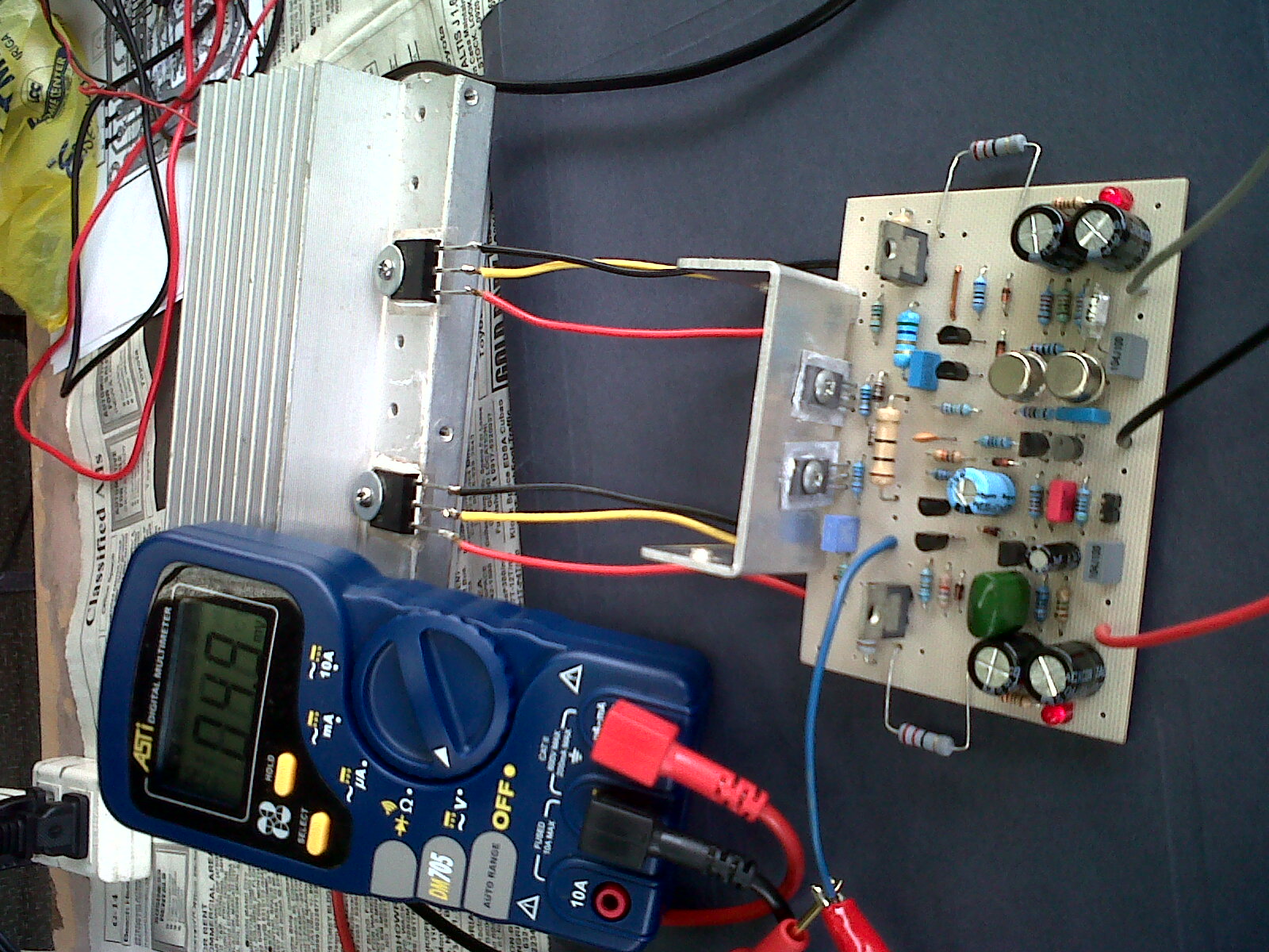

Fellows, did I measure the idle current correctly? My previous CFP build also reads 0.12ma. This is a rebuild using AlexMM pcb lay-out. All components are pretty normal excepting VAS 2N3019 they're getting hot to touch.
DC-offset at 04.9mv, (no AC reading, perfect!) +/-23.7vdc rail voltage, D1047 for the output. (Sorry, not so clear images 'been using cellphone cam😀)
Do you mean you measured 0.12mV across the 1R resistor? This seems unlikely, with a standard multimeter the resolution is not sufficient.Fellows, did I measure the idle current correctly? My previous CFP build also reads 0.12ma.
If it's 0.12A (120mV), it is lowish but sufficient.
With 50V total supply, the 2N3019 should be reasonably hot without cooling clip, but they should remain touchable (by me anyway).
If they are really too hot, I would suspect some kind of error, pin or component swapping

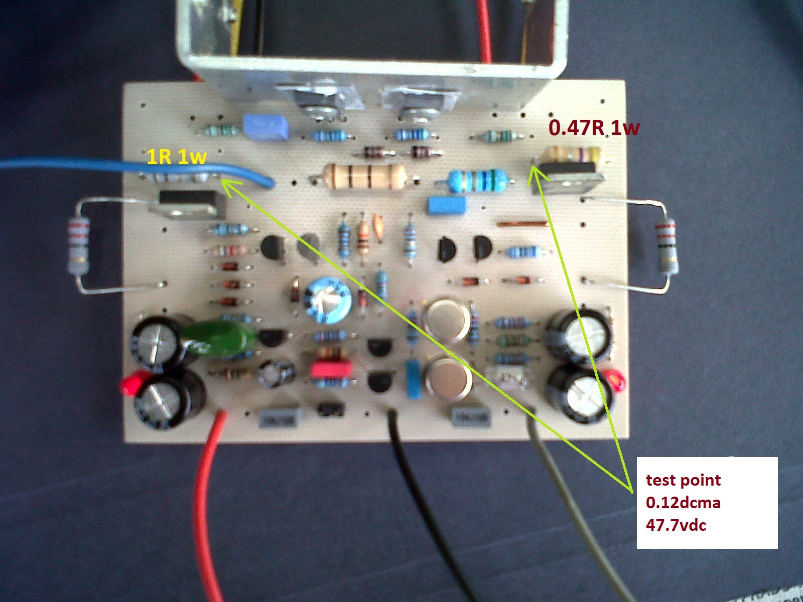

Sir Elvee,
DMM set to DCmA = reads 0.12mA when set to DC = reads 47.7vdc.
Red probe to 1R and black probe to 0.47R (tap points indicated by the arrows)
I am not so sure if my manner of measuring is correct, though. PSU at -/+23vdc.
I am afraid you fried the ammeter section of your multimeter.I am not so sure if my manner of measuring is correct, though. PSU at -/+23vdc.
To measure the quiescent current, you have to connect a millivoltmeter across the 1R resistor, then Iq(mA)=VR(mV)

One should never use an amperemeter in an amplifier: it is dangerous both for the instrument and the amplifier.Uh,oh! Guess I need to check on the capabilities of my DMM, it's an auto-range type...it is supposed (programmed) to detect errors when used incorrectly. My failings'

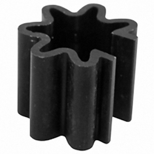

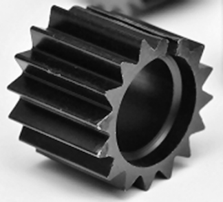

All components are pretty normal excepting VAS 2N3019 they're getting hot to touch.![]()
There are heatsinks made that size You can make the "flag" version at home in a couple of minutes and it would work fine with some thermal paste.
An equally important thing is airflow. In the absence of airflow the heatsink only retains heat. Therefore, be sure to allow airflow. Vents are necessary (fans are not). It is especially useful to allow the cool air in at the bottom and allow the hot air out at/near the top. That will voluntarily make a silent breeze and enough circulation to make the heatsink work.

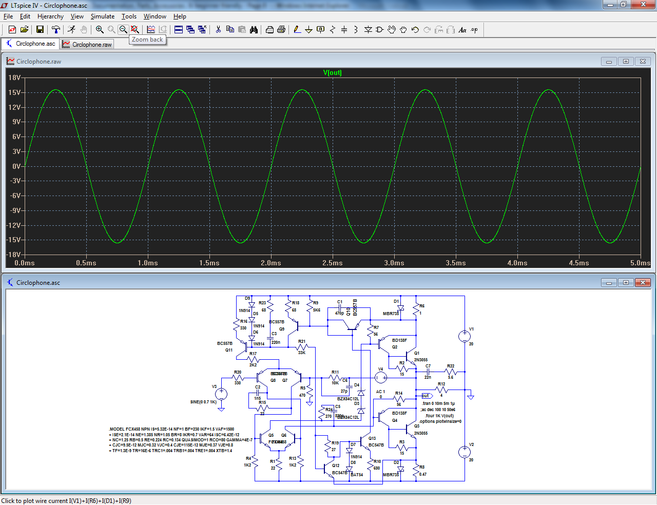

Has the FCX458 been evaluated for use as VAS?
.MODEL FCX458 NPN IS=5.32E-14 NF=1 BF=230 IKF=1.5 VAF=1500
+ ISE=2.1E-14 NE=1.385 NR=1.05 BR=8 IKR=0.7 VAR=64 ISC=6.42E-12
+ NC=1.25 RB=0.5 RE=0.224 RC=0.134 QUASIMOD=1 RCO=80 GAMMA=4E-7
+ CJC=9.5E-12 MJC=0.32 VJC=0.4 CJE=115E-12 MJE=0.37 VJE=0.8
+ TF=1.3E-9 TR=16E-6 TRC1=.004 TRB1=.004 TRE1=.004 XTB=1.4
It is widely avalable and cheap.Ok is SMT but it can make the design much more robust against higer rail voltages.
400V and a Hfe of >100 output capacity 5pF

It works transparently in sim, and it is highly likely it also would in reality.
Two things concern me though:
-The Ft is rather lowish: 50MHz (OK, it's the min value)
-Such high voltage transistors tend to have a relatively large knee voltage; this might affect the negative swing.
You should try them, keeping the above points in mind (and report the results, it will be useful to other members)
