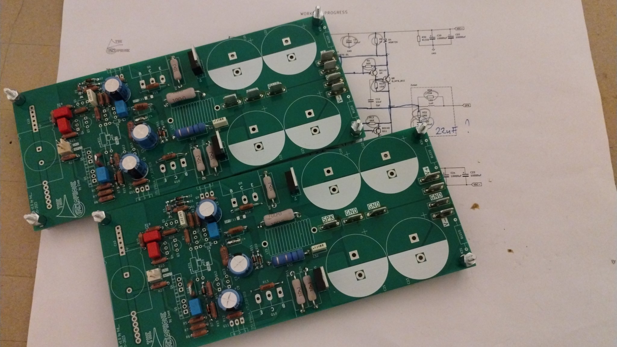

Congratulations, it looks promising, but a detail worries me: is it a 0.56 ohm I see in the Zobel? It should be 5.6 ohm. I don't think it will cause problems, but it is preferable to stick with the original value
Thanks!
The resistor in Zobel is definitely 5R6. I usually double-check resistors before soldering 🙂

OK, but then the color code is incorrect: the multiplier band should be gold, not silver for a three-band indication. That said, I have seen weirder things, like the cathode band of diodes on the wrong side...Thanks!

Just got a set of OscarGolf/Stallion Circlo PCBs and have started populating them. Getting close now that I'm waiting on a couple of capacitors and some heatsink, so a quick question, how large should I size my xformer for a stereo pair. Just wondering if my single 18-0-18 100VA that I have available will suit my needs, or should I order a second to match, and dual mono my power supply as well?
It is comfortable if you have 8ohm speakers, but for 4ohm, it is a bit marginal: it is the dimensioning used for "budget" amplifiers. That said, for a relaxed domestic use, it is still acceptable
Quick Q: It seems that my rails will be +/-34V (slightly lower than the anticipated +/-35V). Should I adjust D8+D9 for total 32V drop?

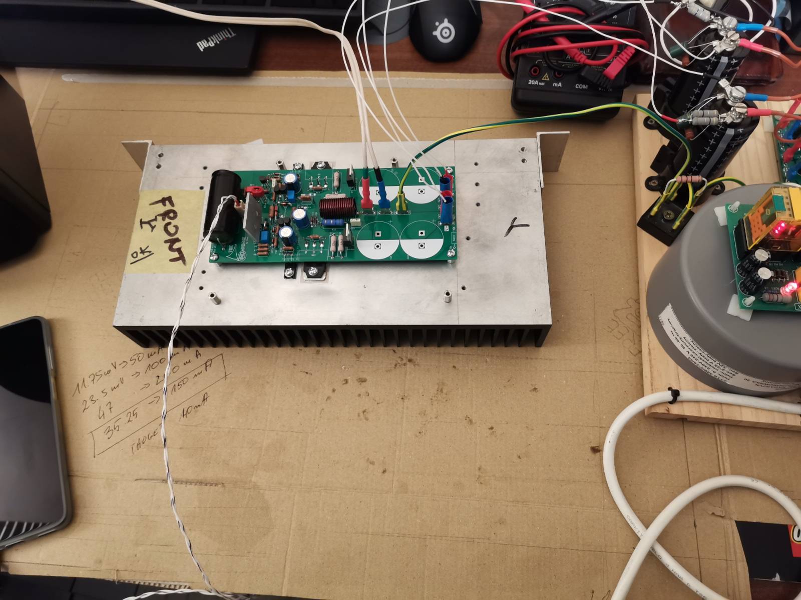

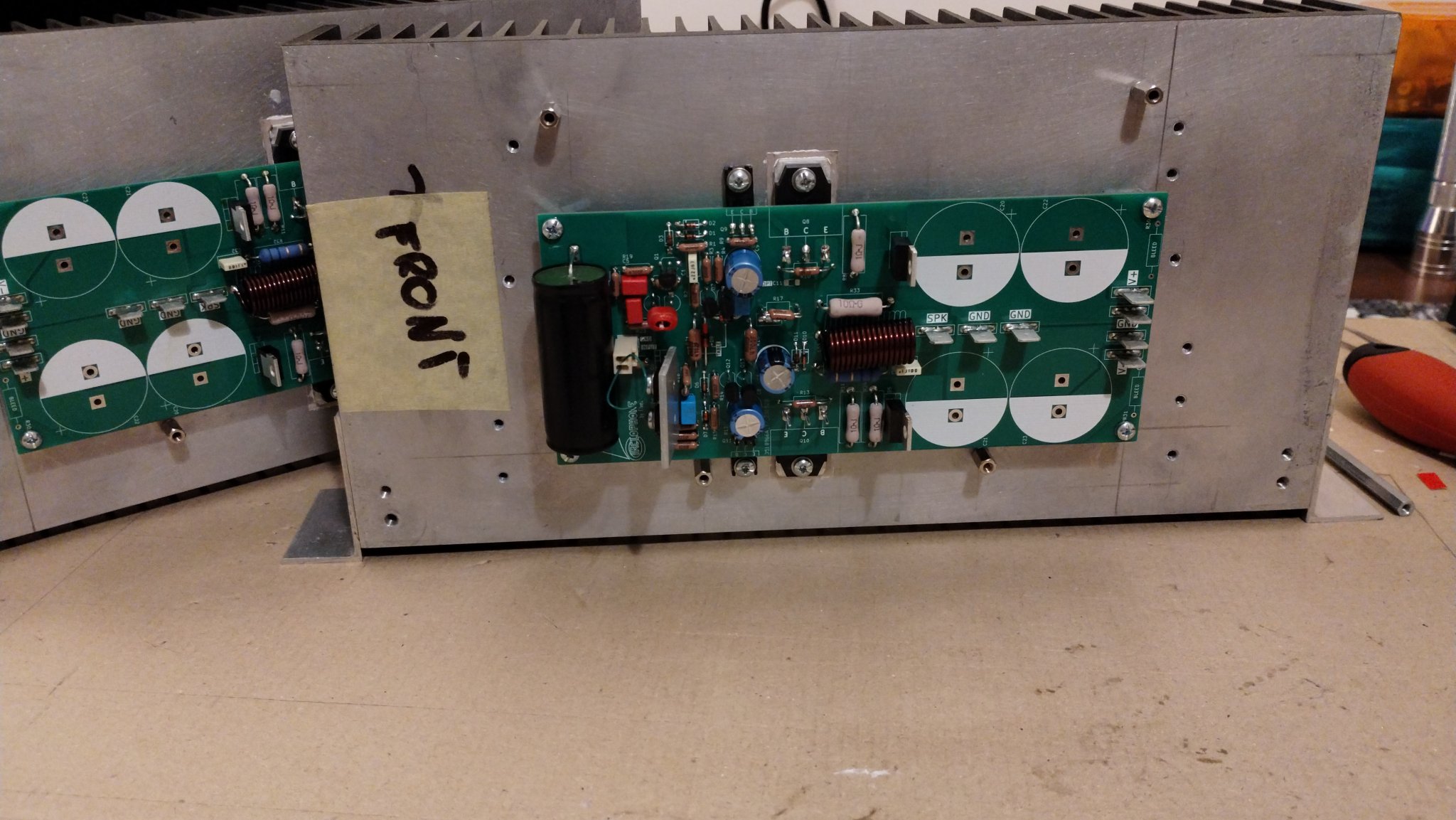

I finally found some time to fire up the amp. It is alive!
DC offset 3mV, rail current draw 200mA. Both channels identical.
Playing music for the first time. One channel at the time. No surprises.
Interestingly, when I mute the source and stick my ear into the speaker I can hear nothing. This amp is really silent 🙂
Next steps: assembly the big caps, install the second transformer and listen in stereo.
