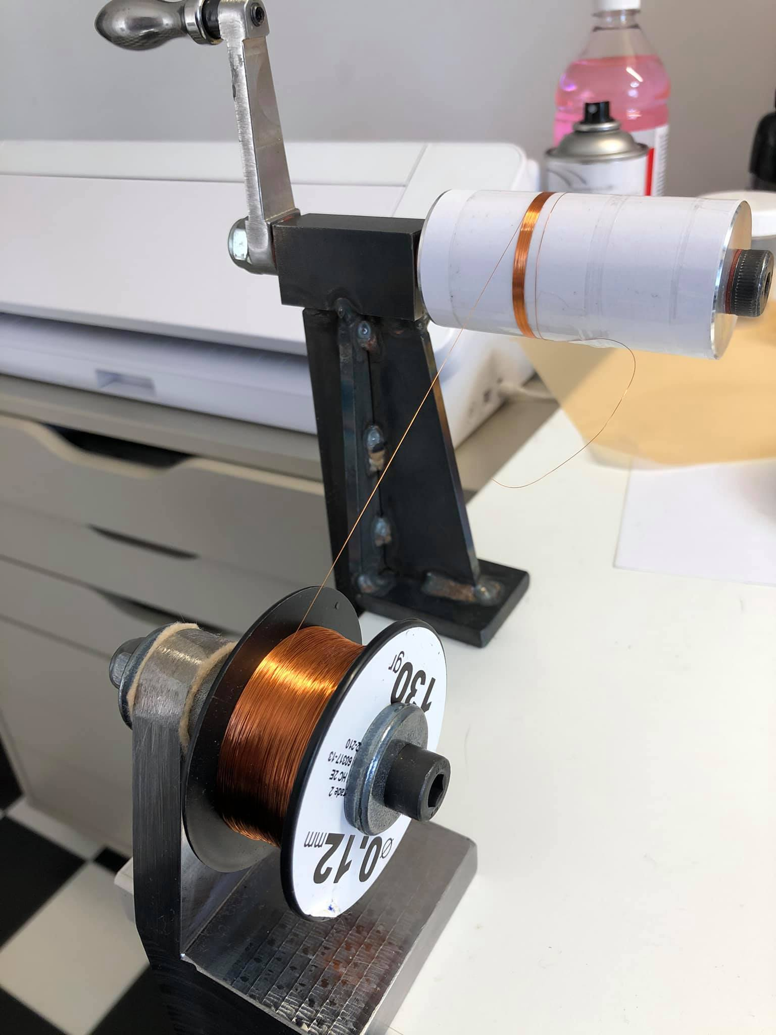

What has me curious is that it should technically be possible with basic machinery to produce the voice coils have been around for a long time, just if I am to make them, where and how do iI aquire these.

I will make it clearer then, 40-50mm headphone driver voice coils. The gauge wire needed, and preferrably machinery that can produce it that are not large and in smaller quantities.

After a few days of self discovery and looking into this topic, I am going to build my own machine dedicated to making my own speakers.
"Wait, how are you going to do that?"
Good question! With a bit of maths, correct ratios and understanding the production process with some help from a few people, I plan to make my own coil winder, press and glueing mechanism that allows for a consistent amount of glue to the membrane. While everything in this won't be eletctrical, and all mechanical, I firmly believe it is very possible.

I made a winding machine that can wind thin wires. Believe me, it's not easy nor cheap. Have a look at ukcnc, they have some nice winding devices and can make you a custom one. Doing it by yourself is not likely to become any cheaper than what they offer, unless you can get away with lower precision.
Literally just got off the phone in contact with one of their guys (who was very lovely by the way) and he said it would do the work I need, I think you just saved me a few thousand!I made a winding machine that can wind thin wires. Believe me, it's not easy nor cheap. Have a look at ukcnc, they have some nice winding devices and can make you a custom one. Doing it by yourself is not likely to become any cheaper than what they offer, unless you can get away with lower precision.
Looks like I am buying one of their machines.

If you plan to use glue or other fluid stuff for your coils maybe ask them if they recommend some kind of protection...

That seemed to be the issue with most of the DIY and really cheap commercially available options I saw also. They seemed to have problems accurately spacing the wire or they were relying on a skilled operator to do it.unless you can get away with lower precision.

The best way would be to reverse engineer , take a blown driver of the ohms, vc dia & xmax etc you would like to make and measure the wire gauge and analyze the type of wire - copper , ccaw, al. etc.
Below is a trial diy way to get one going in making a vc - hand winding
1. Take a PVC pipe and cut a V shape , that the pipe can be compressed
2. Use Kapton / Paper similar to the the vc being reversed engineered
3. Cut the VC paper , a little bit oversize - as the extended part can be trimmed before fixing the dust cap
4. Fix the VC paper on the pvc pipe with tape keeping a small gap between edges.
5. Mark up the vc winding height
6. Roll epoxy glue over the winding area with a paint brush (epoxy glue - flowy type)
7. Wind the 1st layer by hand - and tape it, let the epoxy set a while, put epoxy over the 1st winding layer
8. Place the 2nd layer of winding over the first
Hand winding is not difficult - needs some patience and dexterity
9. Cut n tape the wire on to the PVC pipe n let it dry
10. Once Epoxy is touch dry - press the pvc pipe to release the coil - the V shape cut will facilitate the compression of the pvc pipe to release the coil
11. Heat with blow dryer of in an oven to set the epoxy.

I also customized and build my own winding machine which is computer controlled to wind my own voice coil with self bonding CCA wires.
