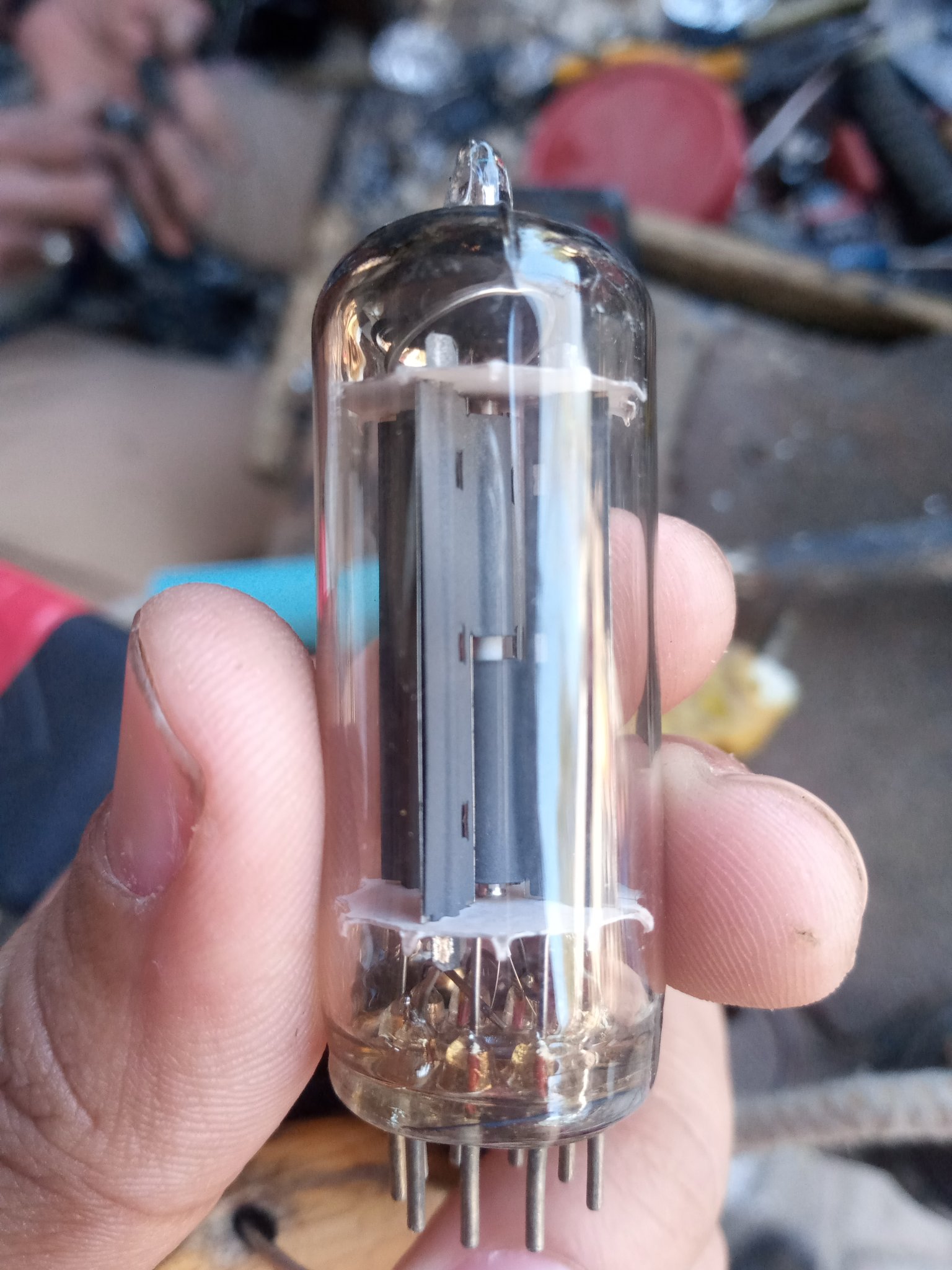

Here D1047 B817 2sC5200 2sA1943 Tip 41 Tip42 Are Commonly Available But Some Transistors Are Rarely Available Like Audio Tubes or 2n3440 Or 2n3773 etc...

Another workaround is to use a TRIPLE output stage. If you are stuck using TIP41/2 drivers because literally nothing else is available, it becomes much less unacceptable if you use something like MPSA42/92 pre-drivers. This will at least minimize the damage that the TIPs will do by reducing the nonlinear capacitive loading on the VAS by the output stage. Having the extra gain will help things. A lot. It brings up the “effective” fT. Stability will be trickier, but not impossible (I have done it, even with 60 dB of NFB). If you do use a triple, you could also use D1047/B817 as drivers instead of the TIPs. For very large amplifiers with many paralleled outputs this is actually appropriate. For a triple output stage, using a proper bias regulator using a Vbe multiplier instead of just a stack of 1N4004’s becomes a must have.
The amp I built had 2N5551/5401 predrivers, TIP31/32C drivers, and TIP35/36C outputs. All generic transistors. It was even a class H output stage (which you can skip). Sounded good and was stable. Best in the world? No. But plenty acceptable.

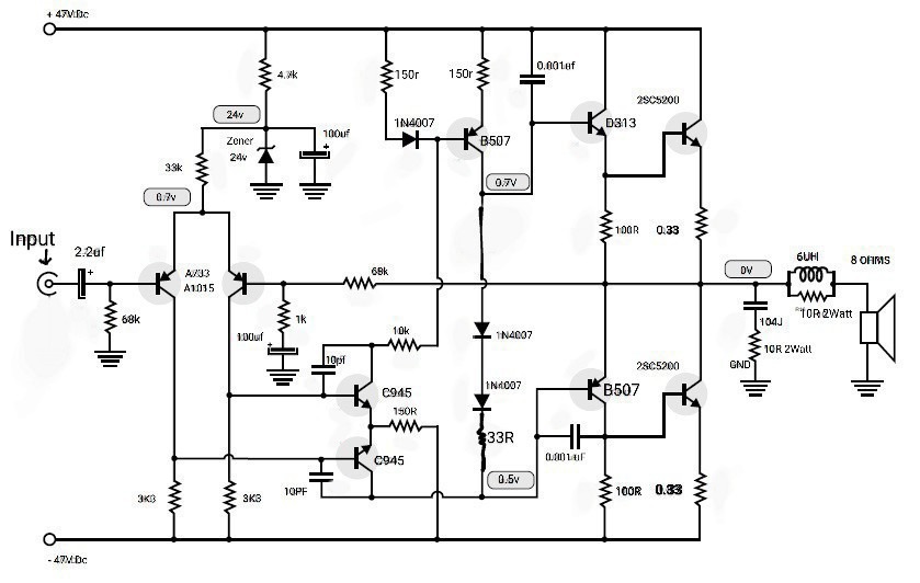

I Have Create A Design of Another Shematic After Learning Some Basics Of Amplifiers in A Short Time... The Parts I Used In The Schematic Are Commonly Available Here So I Put Them In Shematic Can any One Simulate This Shematic for Me In Spice Coz How Much Out Put Power I Can Get From It???
I Am using 35v 35v AC Transformer For It...
Thanks In Advance......

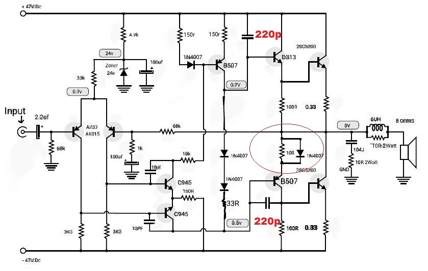

Quasi Complementary Output Section ( all NPN power transistors)
Needs extra resistor and baxandall diode
.001uf capacitors or 1n on driver transistors D313/B507
is incredible high, this would make high frequency performance very poor.
Those help stabilize the amplifier but shouldn't have to be higher than
100 to 220p
Only pair of output transistors, good for 90 / 100watts max
use only 35 to 38 volt supply rails.

Thanks White Dragon I Understand What You Are Try To Say The Main Problem Is That Here Just Few Transistor Are Available Many Of Them Are Chinese Version not Original...
Anyways Can U Edit My Schematic For Good Performance I Know You Can do Easily...
Can You put Extra Resistors And Baxandal Diodes in My Schematic Kindly...
I Am Using 12inches Speakers With It..
Once Again Thanks,,,
Hopefully you understand that Bipolar Transistors
When they heat up require less bias voltage.
So the bias network is usually designed
to Thermally Track output transistors.
When they heat up, the circuit lowers bias.
In your case using Diodes for Bias
The Diodes are usually mounted near the heatsink
So they thermal track
also you may want to add potentiometer and set resistor
so you can adjust bias.

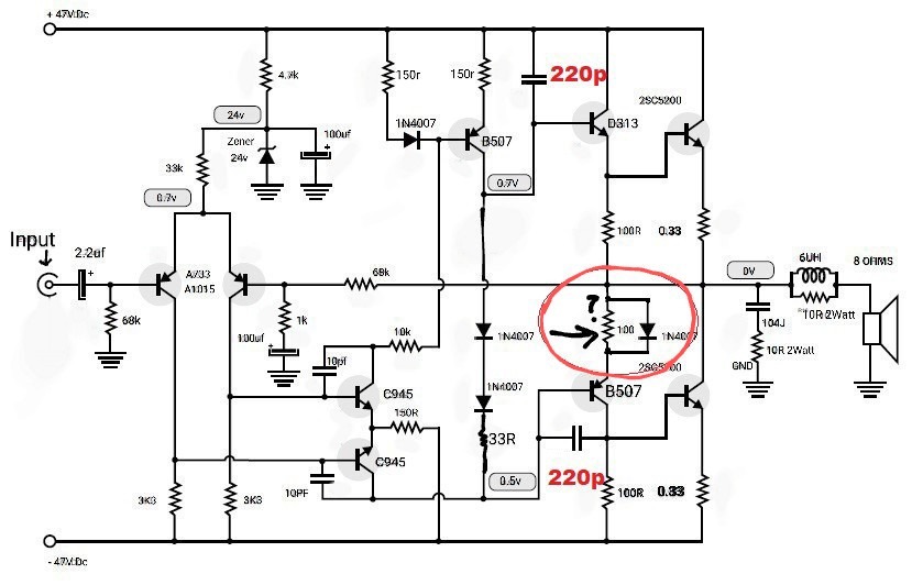

Can I Fix Bias Without Potmeters???
Anyways I Will Built It And Then If I Get Any Issue I Will Talk To You Again... Thanks Man....
Don’t build any large-ish amplifier without a way to adjust the output stage bias. If you don’t you're asking for trouble. There is no way to get it “spot on”, especially if you go substituting transistors. The only way to be safe with NO adjustment is to deliberately under-bias it, but that gives gross distortion with most circuits. There are circuits you CAN under-bias and get away with it, but they still require bias adjustment. A vbe multiplier is not hard to add to ANY amplifier, almost foolproof, and doesn’t need any special transistor. Yes, you can even use a TIP41 (But will need an insulator on the heat sink, which is why everyone uses encapsulated types instead). A series resistor (pot) will work too - but you need to be able to work out the required range for the pot. You need to be able to adjust the voltage on the emitter resistors, and that requires a meter. IMO, you cant build any amplifier without one so don’t try. Doesn’t need to be expensive, just needs to be able to read DC millivolts, preferably down to 0.1 millivolts.
With +/-47 volt power supply you need two pairs of output transistors per channel. Period. 2SC5200’s will be fine, as long as they are not FAKE. The ”N” version is fine, so is the TTC.
If you want to build something that requires NO bias adjustment and uses only one output pair, build Elvee’s “Circlophone”. It does require some schottky diodes (do not just substitute 1N4001s), and at least a halfway decent pair of driver transistors (No TIPs). Can’t run all the way up at +/-47 volts though - +/-35 or 38 is about the limit because of the one pair of outputs. It cannot easily be adapted for two pair just by paralleling like most amps can. But it is just plug and play. It COULD be run safely on +/-47 volts, but only with 250 watt metal outputs MJ15024, MJ21194, or one of the old big bruisers like 2N6259’s. You probably wont find a real one in your country if you’re having trouble getting real driver transistors.
