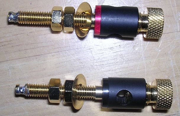

awesome, thanks so much guys. you were both right - both my RCA jacks and speaker jacks were not insulated from the chassis. believe it or not, i deliberated a while on how to wire those up and attach them to the chassis but this is one of those steps that folks with a clue probably take for granted so i couldn't find 'jacks for dummies' info anywhere. i remember being frustrated that the jacks didn't come with instructions. 🙂
the RCA -> star ground seems to have been something i picked up on my first pass at building the amp about a year ago (before finding Peter's 'how to' thread). i almost removed it when reading Peter's thread, but as the SG was already shorted to my chassis, i figured it couldn't hurt. ha.
so after fixing the RCA jacks and bypassing my un-isolated speaker jacks i get music from the right channel. honest to goodness non-staticy music. yay! (the left channel seems to be dead. i can do some diagnosis on that and hopefully find the problem.)
so, now that you know the kind of guy you are dealing with, maybe you can help me figure out how to isolate the speaker jacks. the RCA jacks came with plastic washers that i was using incorrectly (though I am still a little surprised that everything is truly isolated as the jacks physically touch the chassis?), but the speaker jacks are kind of simpler and it seems like the simple act of sticking them through the hole in the chassis would ground them? how *should* i attach these to the chassis to keep them isolated?

The simplest way to see if the chip is OK is to check DC offset. If it shows 0V DC, it's certainly no good 😉
Usually, binding posts have washers and one of them comes with a lip that goes inside chassis opening. If you don't have those, use any plastic washers of apropriate size and some masking tape to isolate binding post from chassis walls.
thanks everyone for the help - the amp is working and i am really pleased with the results.
