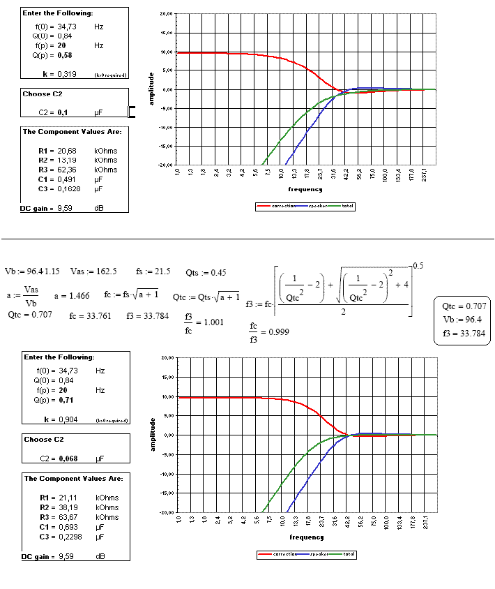

I would Like to know if anyone can help e with the LT circuit for this specific sub (Peerless 12" xxls - 830845) with th Ruthmik Audio A370 Plate amp?
I'm considering on purchasing rithmyk's plate amp and chaging it's RC values to achieve a better set for my sub.
I've made some plots and I've come up with a 110,6 L sealed box!
Is'nt it a box too big?
Hi There again!
Wath would be the LT circuit values that you would recomend if I where to use the 12" XXLS - 830845 Driver with the Rythmik Audio A370 Plate amp?

Please take a look at the attachements
