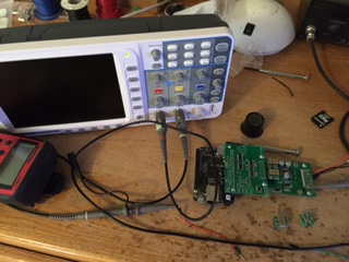

I have one on my bench right at this very moment. 🙂 I am just finishing setting it up and I will post my progress as I go. I have finished testing the "Cronus" itself and it is working even better than expected. 🙂
Rhea boards also tested - go!
Just getting the the Hermes-BBB itself right now. Taking it slow and cautious (don't want to damage anything).
I already tested my battery backup/shutdown and it seems to work exactly as it should. I see only a few micro-amps of current draw on the battery after power down. I will keep testing this - but it seems to be a fine solution. Of course one could also use this power cape which is excellent:
BeagleBone Power Cape - AndiceLabs
Here is a pic of how it looks on my bench right now.

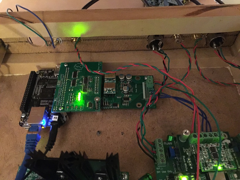

Here is a pic of the beta build in the trusty (not fancy) test rig.
Cheers!
Russ

Thanks. Your last photo prompts another question:
I had always thought I would use one of your Trident regulators to power the clocks, but I see you have gone to a certain amount of effort to provide an onboard power supply on the Cronos. Is this onboard solution as good as a Trident?
Yes indeed it is a superb solution for this situation - otherwise I would not have done it. 🙂
The problem with making the vreg external is that it would not have as direct control over the rail (longer sense loop) - also a series reg in this case helps this unit integrate better with a larger stack. Also - it's one less thing for builders to have to worry about.
My initial beta used various external supplies, and I just found it was better to do it this way. I used the superb ADM7151 - and I wouldn't change it.
I built three prototypes (vastly different each) and this is the one I finally feel reaches the mark. And the others were good. 🙂 This one is just amazing.

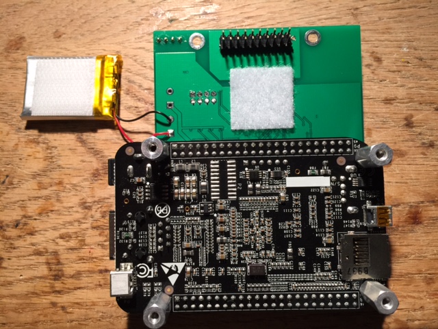

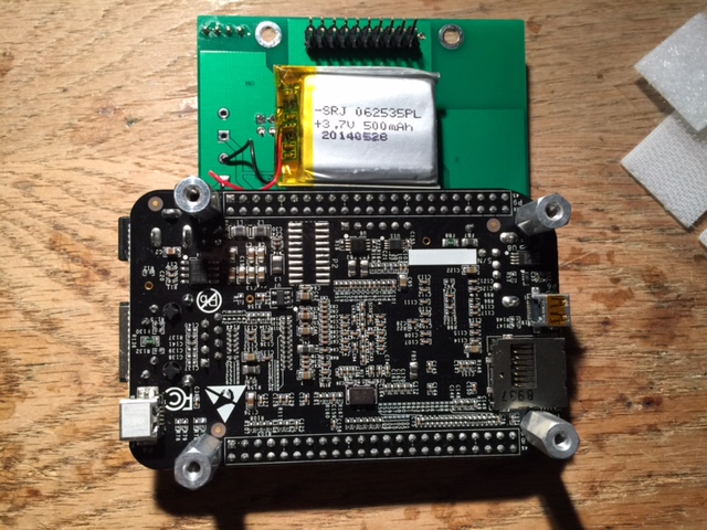

Installing a battery is really simple.
For safety just make sure its the type with a built in protection circuit that prevents both over-charging/discharging and under-voltage. This way you can safely just install (carefully) and forget.
I just used ordinary self adhesive hook and loop material.
When using Miero's distribution - when main power is lost - shutdown is automatically initiated.
After power is restored it will start up again.
It is proving to be a simple effective solution. I also have a power cape - but I don't see any need to use it right now.
Cheers!
Russ
