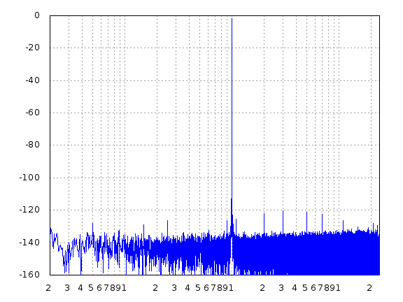

The BBB works well as ADC too. Here is FFT plot 1kHz signal from Buffalo3+IVY captured at 48kHz/24bit by analog part of ESI Juli@ PCI soundcard and I2S signal recorded by BBB.

If the analogue signal is actually captured by another external device (ESI Juli@ PCI soundcard) then it mean that the AD conversion was/is made on that device, which also output a digital stream as I2S, further to BBB.
If BBB it record the digital stream (I2S), that do no mean that BBB it works as ADC, but as a digital signal recorder... This function it does not have something special in it...
The plot published it may represent the parameters of the AD conversion of the sound card, and it may not have anything to do with the BBB as a recorder of a digital stream, and may not reflect its parameters...
If the analogue signal should get directly into the BBB, through its (supposedly) analogue stage or an own (on board) ADC chip, then the BBB it could be called as an ADC... But anyway, an analogue to digital conversion may not have something to do with BBB as a embedded digital device...
In my opinion the above assertion it may not be quite right...

Thanks for clarification Coris. Digital recorder is the right term for this usage 🙂
The plot demonstrates that BBB is capable to record I2S digital signal with 24 bit precision.
(( Just a while ago I've assembled ESI Juli@ back into its original state and now it's PCI audio interface again ))
