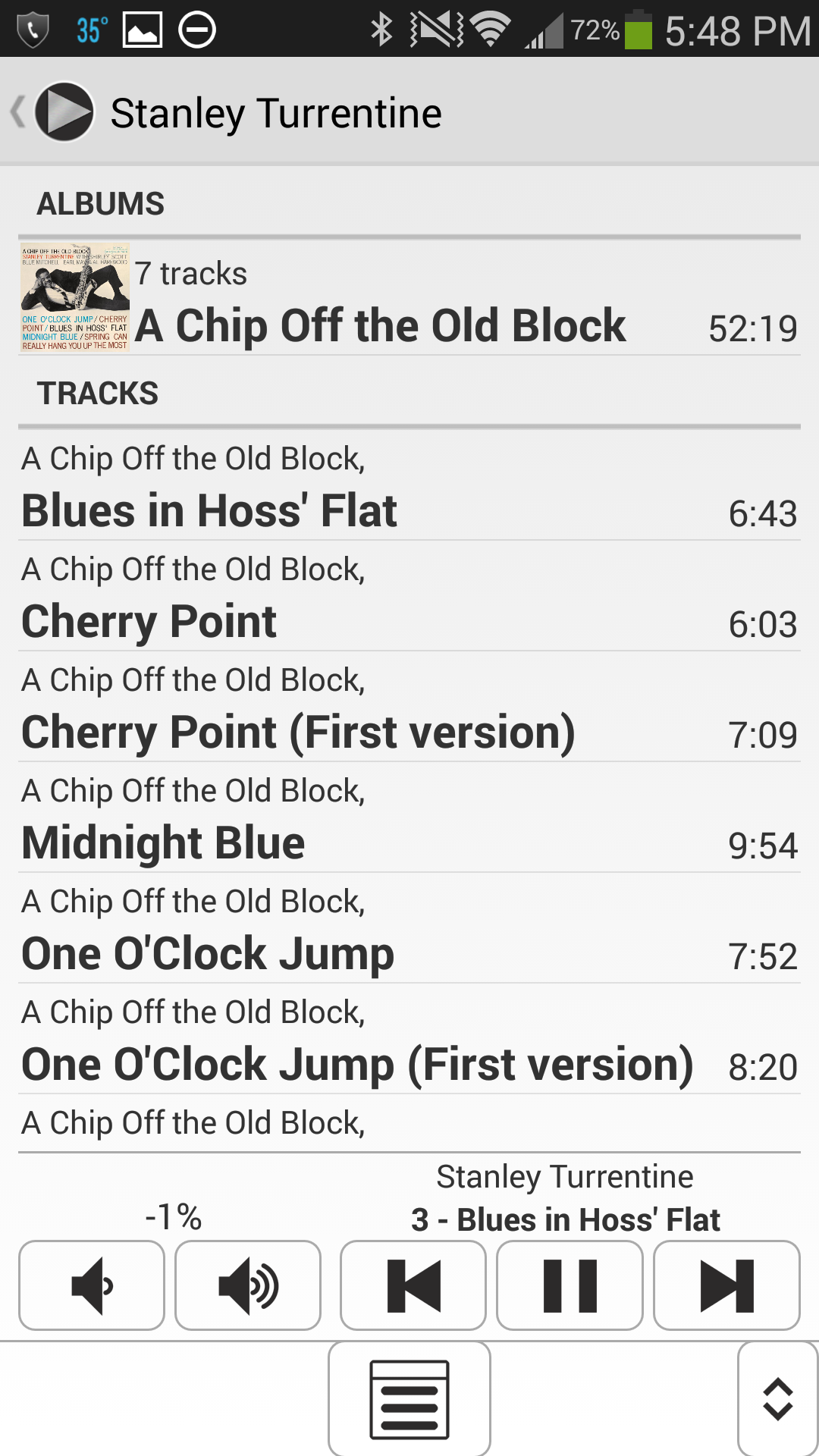

I have actually changed (for a while anyway) my setup a bit, going back to vanilla Raspbian and using Mopidy instead of MPD. Mopidy is really cool! It has extensions that support google Play Music (making it look like a part of your library, and streaming from it), and even running as a UPnP media appliance.
There are many mpd client apps for iOS, Android, Mac, Windows etc... You don't have to use the included web app.
For instance I have been using MPRemote - which works great.
Along with my BLE app to actually control the DAC. 🙂

mpd runs on the pi. 🙂 It is using a NAS mount directly. There is no other server.

Yes - I have used two mounts, one NFS to another Intel NUC linux box (8TB of music) as well as CIFS mount on the router. The NUC is physical Gb ethernet to the router.
The both seem to work the same. No complaints. 🙂
Still (after being educated by some folks) I do believe the BBB is much better hardware, and I will probably refocus my effort there.
