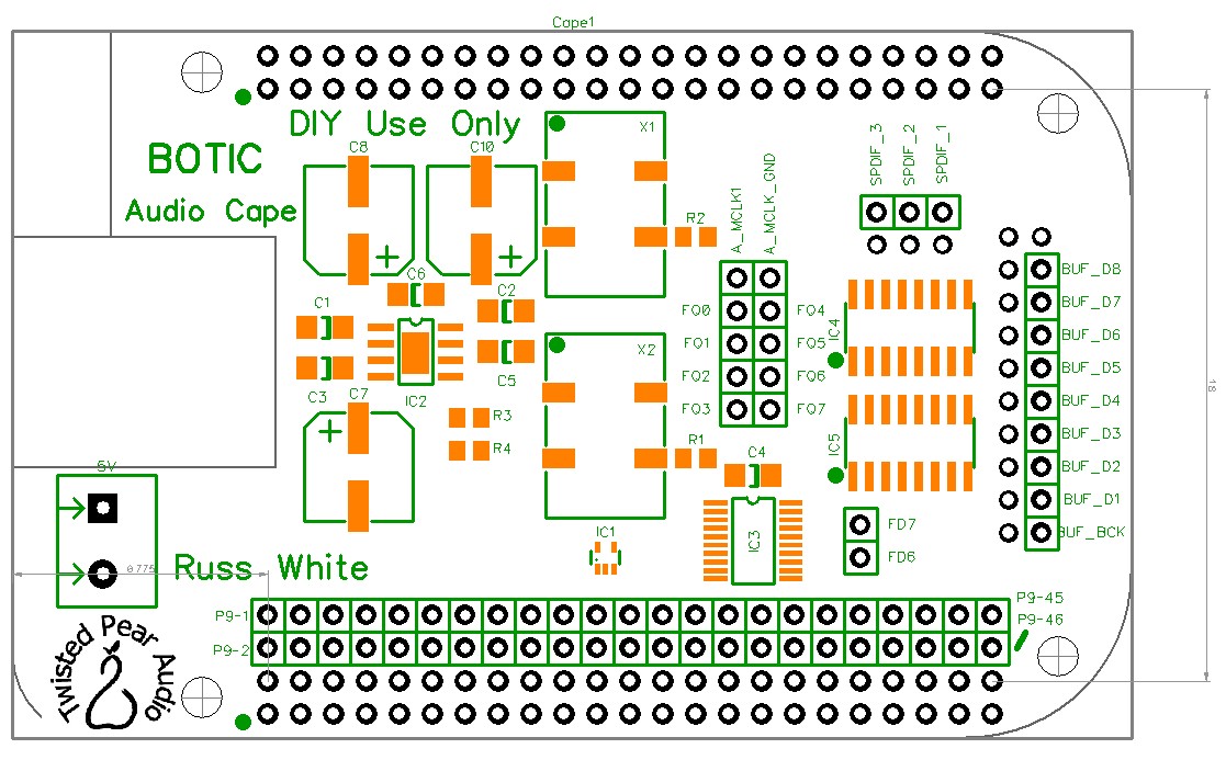

Cape progress so far 🙂
There is still some work to do, but it's much closer to done.
Miero and I have been hammering out the muti-channel and DSD pin assignments.
I went ahead and went with the ADM7151 to power the clocks and FFs/Muxes.
Cheers!
Russ

May I request some pads to be able to try different regs etc if we desire to?
Chuz,
Drew.

Did someone want to use LCD cape together with the audio cape?
Because with the current design (audio must be also on top) it will not be possible. Moreover there is some pin conflict because LCD3 seems to use audio data pins for LEDs or something.
