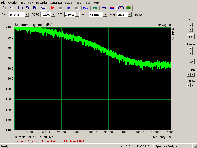

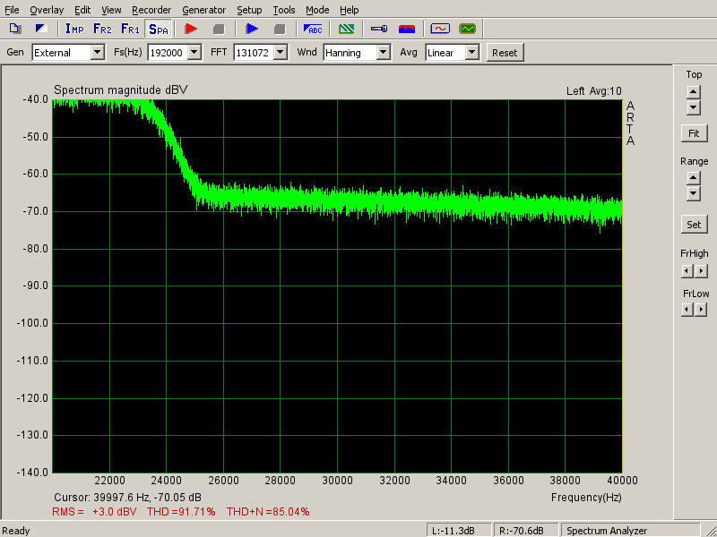

Roll off issues with I2S
I've measured HUGE difference of ES9018 filter roll off when using I2S.
Any idea? Bad settings?
White noise signal on SPDIF generated by onboard sound card and ARTA.
White noise signal on I2S generated by following command on BBB:
$ dd if=/dev/urandom | aplay -r 48000 -c 1 -f S24_3LE -
For 16bit it looks similar, but for 32bit the roll off is even more strange and roll-of is moved to 48kHz instead of 24kHz.
EDIT: first two images are for SPDIF input and the other two (with much noise) are for I2S input.

Default settings work on a pi so should be ok for BBB. They also work well on a wandboard which is what we are using for CSOS.
Pi doesn't have the horse-power (CPU bound) to resample on-the-fly to >96k. Not sure how the BBB compares, hardware wise. ISTR, upsample was fine up to 192k with the original BB I have. Not used that for a couple of months, though. (And not sure if the BBB uses the same processor as the BB.)
I'm building the latest CSOS F20 kernel with a bunch of patches for the BBB. Not sure this is going to happen anytime soon, but I'll add miero's BBB I2S patches to the next build, assuming they apply to the latest mainline. Then, maybe Chris can try my CSOS F20 test image on the BBB. 😉
Miero, your code, are you using recent kernels and device tree for initialisation?

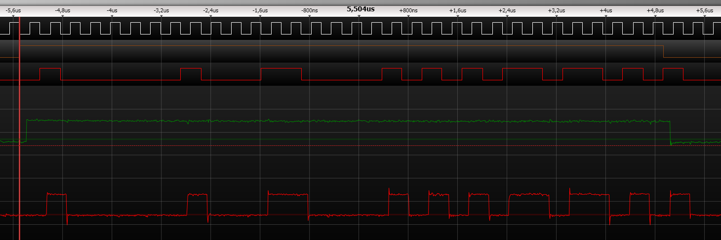

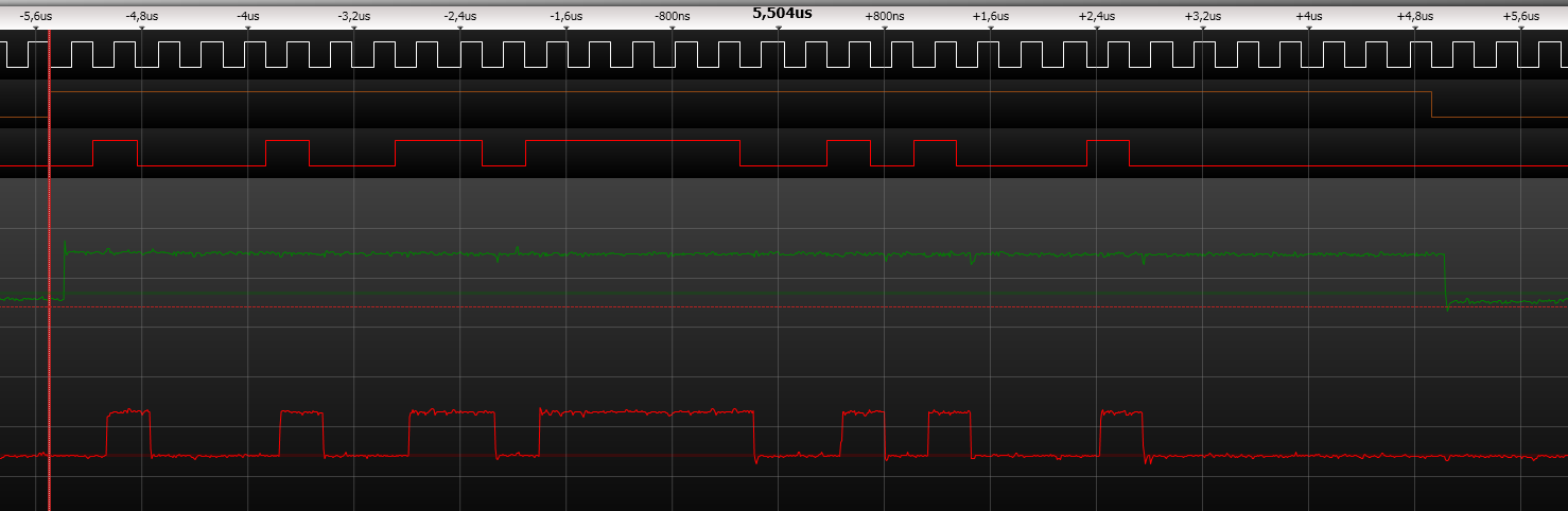

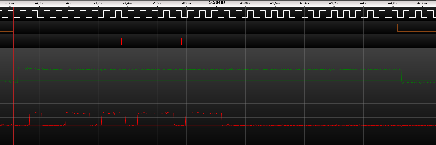

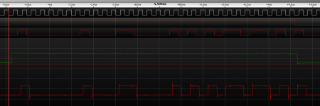

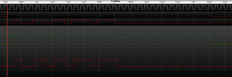

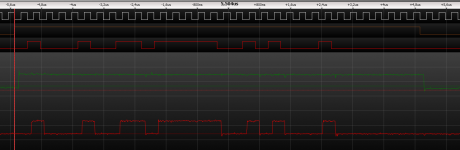

Measured bare I2S output from BBB, no DAC connected.
Signal changes on falling clock side.
Data is delayed 1 by LRCLK.
MSB is on the left, LSB on the right.
Playing 16/24 bit keeps data aligned on the left side.
Analog channels of BCLK, LRCLK and DATA seems well (BCLK is not shown, but well aligned with LRCLK/DATA).
Seems OK to me.
One thing that might be incorrect is Left-Right side.

Word clock should also change of the falling edge of the bitclock.
You probably are doing it correctly, but Data actually needs to be wrapped when delayed one bitclock cycle. For example: The LSB of the Left channel will be clocked in as the first bit after wordclock transition to right channel directly followed by the MSB of the right channel.
Only difference is that 32bit playback can use all bits in the word.
Captures with both MSB and LSB for 16, 24 and 32 bit playback:
