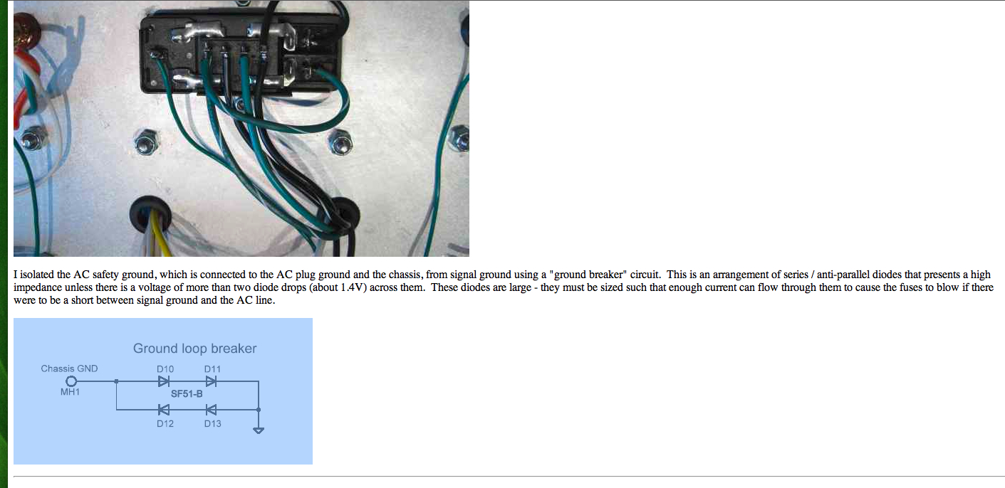

ground loop isolator. basically it's 4 diodes. two in series in each direction. the two sets are paralleled in opposite directions. connectted between the circut and the mains ground. this isolates the ground during non fault conditions. but when a fualt occurs that is greater than the forward voltage of two diodes in parallel, the diodes open and you have a normal saftey ground. a real ince way of having a virtual 2 prong plug that turns into a 3 prong plug during a fault condition.
A ground lift can be used to cut the ground loop between two pieces of equipment if the loop goes through the power cord. It does nothing to eliminate ground loops within your equipment. It also does nothing to break ground loops through signal cables.
