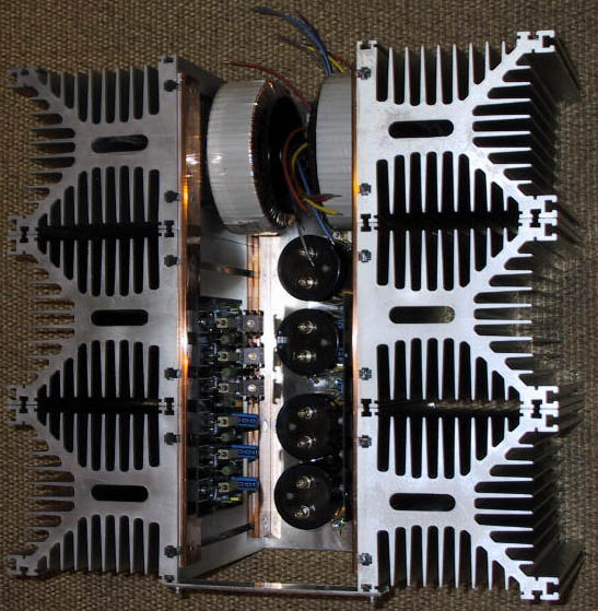

Herm said:
Looks like about .55 degrees C per watt.
Coulomb said:
Thermally it is close, yes. I am using 0.4 to allow for a fudge factor.
Anthony
Keep in mind that that data from Thermalloy was for 3 in. length. And if you're trying to be conservative, your number should get bigger rather than smaller. A 'not-bad' approximation of the equivalency between this sink and yours can be gotten from looking at the in^2/in. numbers of the two sinks.
My question is did you get the dimension orientation all mix up or did I misunderstood your post? I personally would always want the fins to point vertically up, not sideways.
Hello Fcel, the answer is yes. Between the time I put the first post up and when I put the drawings togeher, I realized the flue's should be vertical as you say and not horizontal. Not only di d this change the orienation, it also changed the heat sink count from 6 to 8 for aesthetics', as I want the finished product to look more conventional in design.
Anthony
Anthony,
Sorry, I still don't quite understand how you're aligning the heatsinks. To me, conventional way means having heatsinks fins pointing up which means if you have 4 heatsinks on each side, your amp would be approximately 40" long which would make it the longest amp that I will ever see.
your amp would be approximately 44"

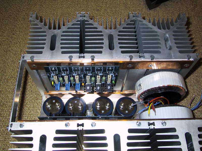

Hello Fcel,
They are to be stacked 2 high, if you look at my drawing, imagine you can see the second row of heat sinks on top of the first. The 4 heatsinks becomes 8, the dimensions would be approx 14" wide x 20" deep x 10" high.
I will try to post a photo of the parts in a rough layout tonight.
Anthony
The Aavid-Thermalloy approximation was based on a 4.875"
Hello Herm, I suck at math, so what kind of rise above ambiet Temperature, assume 23 Deg C, is 8 of my heat sinks per channel going to result in?
Anthony
use correct orientation
Hello Peter, I assume you mean the same as Fcel, with the flue's in the vertical plane so heat can rise and escape the chassis unobstructed?
Anthony
Yes. I would go even one step further and trim one end of ea.heat sink, so when you put them side by side all fins in the center (where they connect) are equal length. Your amp would be less deep and look better. You got more heat sink area than required anyway. Just a thought.
Coulomb;
OK, so the Aleph 1.2 dissipates 500 watts per channel.
One of your heatsink is about .55 degrees C per watt.
Since you have 8 of them, your aggregate rise will be
.55/8=.06875 degrees C per watt.
Lets multiply that times the 500 watts youare trying
to get rid of and we get 500 * .06875 = 34.375 degrees.
Add on your 23 degrees ambient, and your grand total
looks like 57 degrees celsius (or 134 fahrenheit).
-herm
P.S. Your mileage may vary ...
