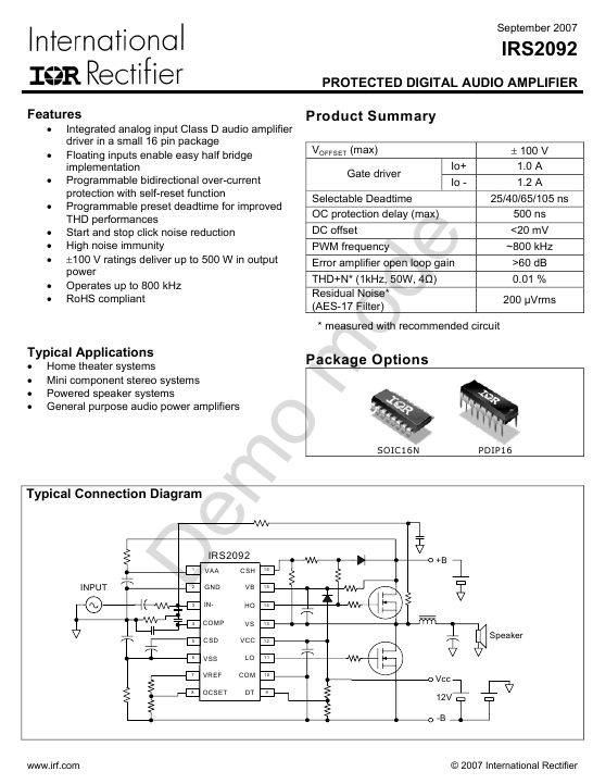

If you have further problem with the amp, you can try IRS2092. Single chip Class D Amplifier Driver from IR. Just add two external MOSFETs, a few resistors and capacitors and ..... you get a powerful class d amp with power as high as that can be handled by the MOSFETs!
