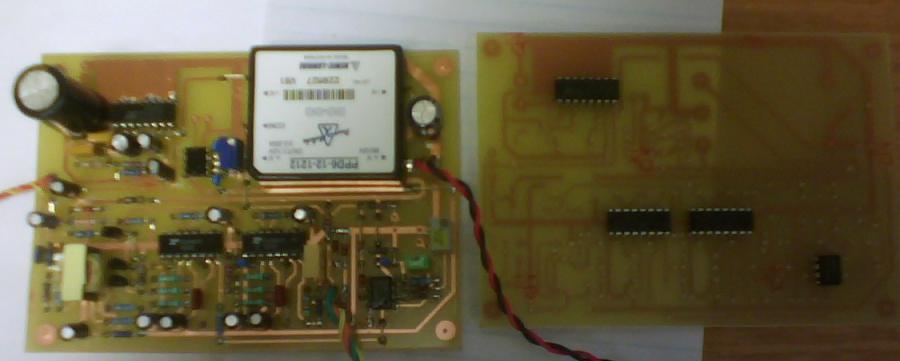

Aleph P..
I'm doing an Aleph P volume control using a PIC and a remote control...
This is my attenuation board:
attachment.php
The 8-pin header at the bottom of the board goes to a logic/driver circuit.. In my case, an octal buffer and I2C 8-bit IO expander, tied to a PIC18F452. However, you could avoid the PIC and use an up/down counter circuit; the IR signal decoding might get messy though.
--Jordan
