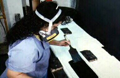

looks like jim had it going on back in the day.........an those were the days of Acoustat........dont for get to bow the louvers..........An let us all know when you get the coating figerout??

coating the inside of the mylar
Has anyone ever tried using thinner Mylar and putting the coating inside of 2 sheets and using the coating to stick them together.
I did this back in the 70's using plastic wrap with UN-insulated stayers and it worked well, but the coating never dried.
And more than double the mass? Hmmm.
The real answer is doing a surface treatment of thin polyester film (Saran is even better, but tougher to find these days- my last ESL build used Clysar) before coating. A corona or plasma treater is optimal, and one can improvise that with a Tesla coil. With a sufficiently high surface energy (40 dynes), it's easy to paint on a good, stable coating; there are quite a few commercial PTF resistor coatings that will work fine. I used a thinned version of Acheson 423, a carbon-black-loaded vinyl composition, but I don't know what's around these days. The membrane switch industry uses lots of this sort of stuff, so something equivalent will be findable.
Making your own coating will be problematic without good dispersion equipment to obtain a consistent conductivity with no hot spots. Most of us don't have three roll mills or homogenizers.😀
First thing that comes to mind for the coating would be carbon black in thinned down contact cement. That stuff will stick to anything.
Getting the conductive coating right is probably the hardest part of building your own ESL. I see several problems with using contact cement: 1) it will probably add significant moving mass to the diaphragm; 2) it will be very messy to work with; and 3) contact cement remains tacky essentially forever, and therefore will attact dust (which, in turn, will eventually cause unwanted ionization and even arcing).
Keep in mind that the goal is to have a highly-resistive coating, so as to keep as close as possible to the theory of constant-charge operation.
Many different methods have been tried for ESL conductive coating, many of which are documented here at DIYAudio. Most of them have one or more problems with performance and/or long-term stability. I do think that Acoustat's success had much to do with their proprietary coating, which yielded very consistent results and extreme long-term reliability. Many years of experimenting and many dollars were spent on developing that compound. Even if I could share the ingredients with you (which I don't have) the equipment necessary to create it is way beyond the scope of DIY'ers.
