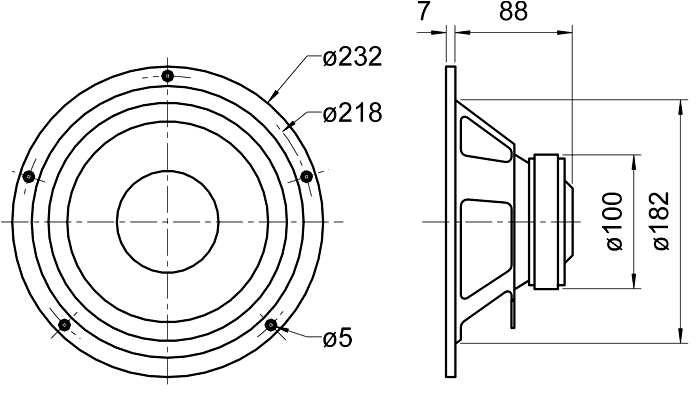

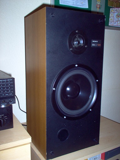

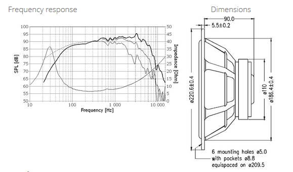

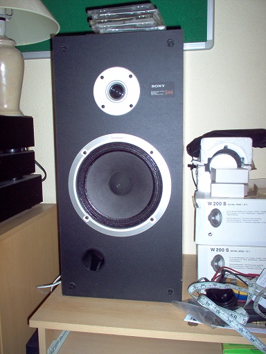

I usually carry a tape measure when looking at a potential cheapie cabinet. This Sony E44 looked ideal diy territory at around 30L or a cubic foot for 8" plus 1". The reflex port can be made bigger, because the original is tuned quite high, being high efficiency.

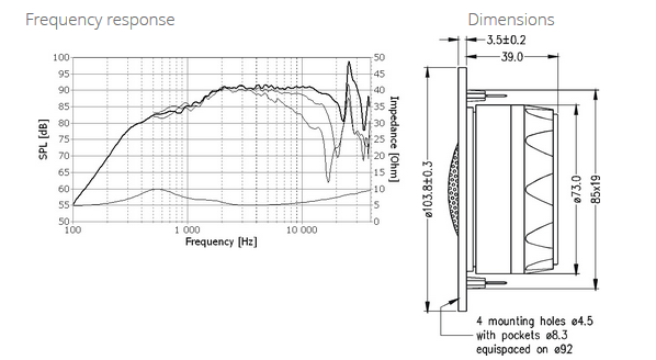

Tweeters tend to be 94mm (like the Visaton DT94 below) or 104 mm. Chipboard cabinets are improved by sticking rubbery/damping stuff to the side panels. Carpet tiles will do.
Crossovers can be simple or complex. According to Joachim Gerhard, the SEAS U22 and DXT drivers willl work on simple cap and coil, but we can do better.
Have a go. Always happy to help with crossover when nearer the final design, but really any flattish drivers will be good. Below is 1st order bass with some impedance correction, 3rd order BW3 tweeter. The Sony original was mere 3.3uF tweeter and it sounded like it.

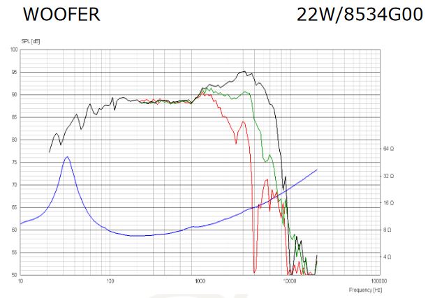

The Scanspeak 22W 8534 G00 is hopeless for a two way! That peak is at 3kHz, but worse is the 6dB SPL rise above 1kHz. That will muck up any attempt at a simple filter, and ruin impedance.
Don't waste time on it. Except in a three way crossing near 500Hz.
Most SEAS 8" are also more suitable. WOOFERS
As the 22W/4534G00 shows the same behavior I can tell you that these drivers work extremly well in a two way enclosure, if not crossed higher than ~2kHz.
The Crossover for Suzie was not complicated at all. No notch or anything unusual needed.
The 3kHz peak (in my measurements it is higher @~3,8kHz) does not show neither in burst decay nor in distortions.
In fact I regard these drivers as extremly good midwoofers.
