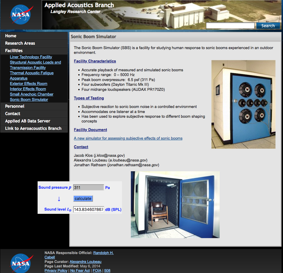

Hello Ive been learning allot about healing frequencies. 432hz. 528hz etc
But Im really confused by all the youtube videos with "earth frequency" 8Hz
No speakers can play this low. Whats up with all the videos?
How do I make a speaker play this?

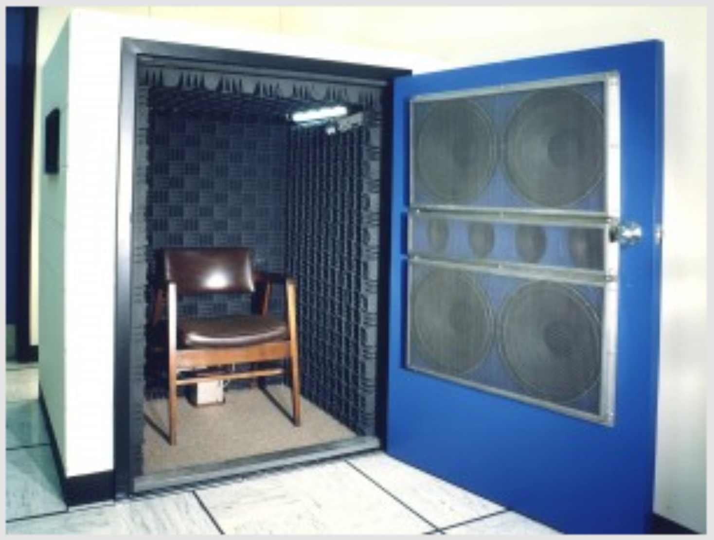

You could copy NASA's sonic boom simulator, updated from the original JBL woofers to Dayton Titanic MKIII.How do I make a speaker play this?
Frequency range 0-5000 Hz, somewhere in the 143dB range (6.5psi, 311Pa).
Boom.
