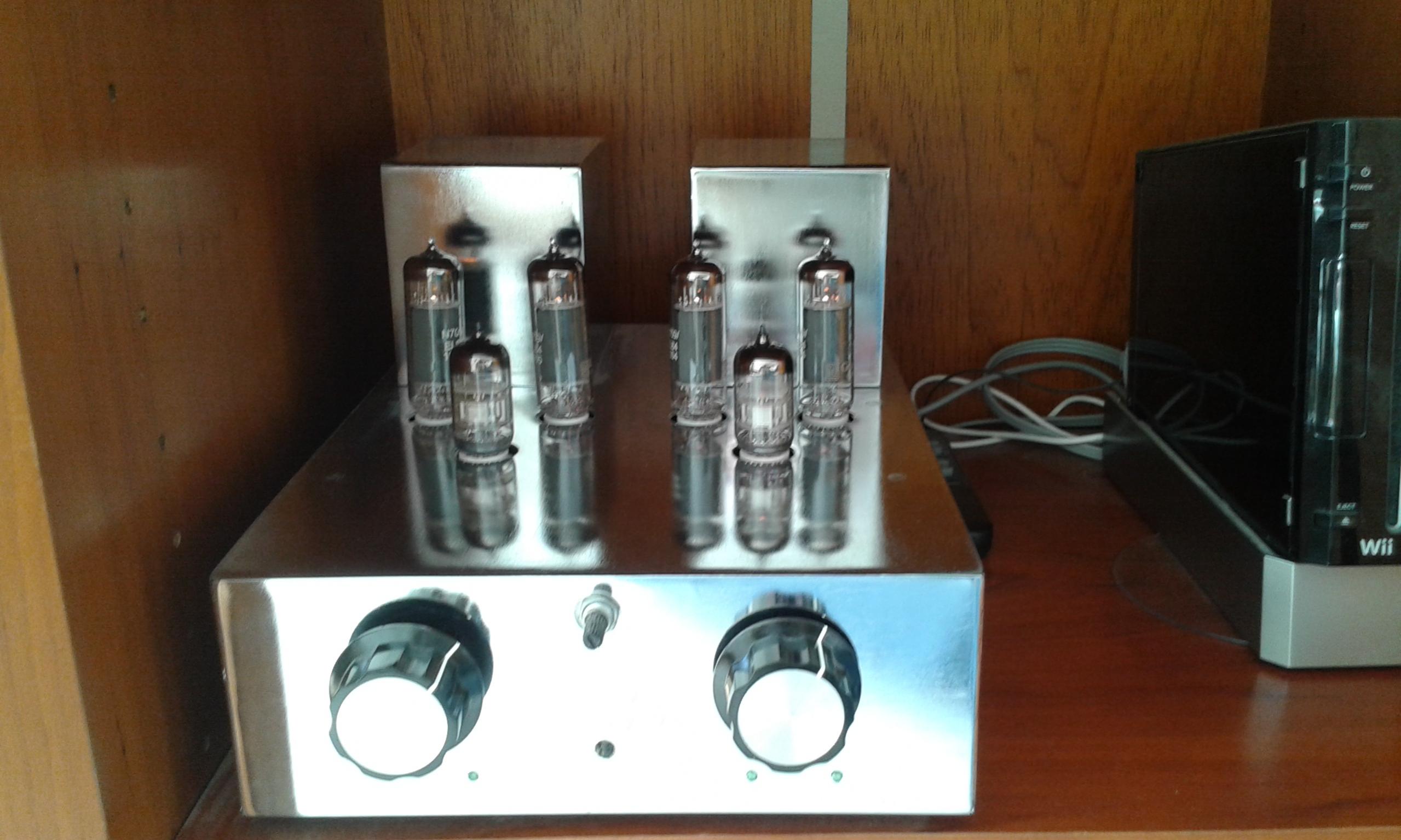

Just seen your post and I went to Dortmund to pick up bits from Thomas Strüning(DieRohre) , Poland for transformers, valves, USA for some bits and China. Made/migged the case and had it chromed here in Southampton UK. SOUNDS really good through my old Richard Allan Monitor 80 loudspeakers. Now about to add phono stage, kit build tube possibly, did you add one?
Sorry I but realise you might have moved on from that time!
Pic of amp.
