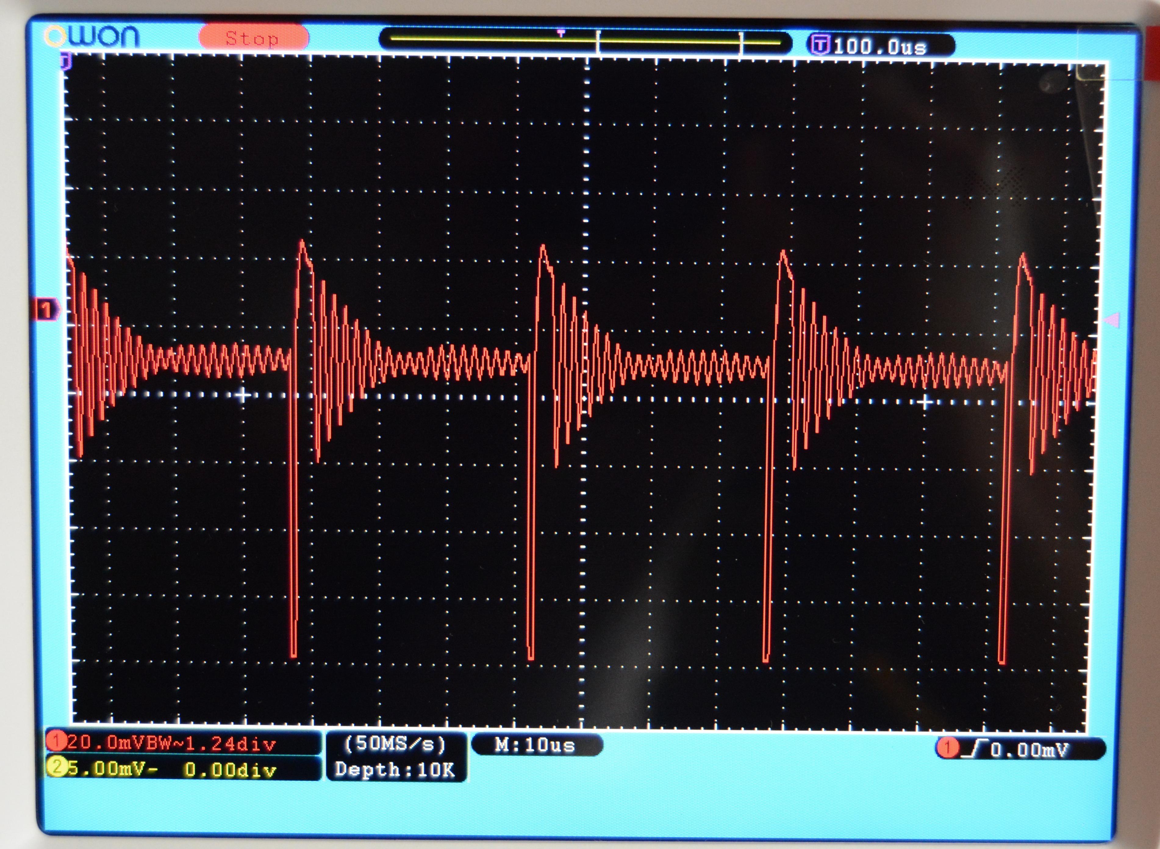

The nano PS comes with a gigantic mains brick providing 12v @12.5A. It made me a bit suspicious so i switched it off. Now the Dell is sounding finally normal. It appears the PS is polluting either the room, the mains, or both.
This is what my scope shows with the probe shorted to ground and resting on top of the PS. No electrical connection and purely common mode radiated noise.
Just finished listening after replacing the little horror with a bench PS @12.5v. Average current consumption seems to hover around 1.5A.
And what a difference! There is ambience, dynamics, hf details galore. Tomorrow will be building a linear supply. So, even with a nasty little switcher supplying the ATX voltages out of the incoming 12v, the raw dc still makes a huge difference, at least in my system and to my ears.

Of course, even though supplying cleaner power to a switcher seems to make a pronounced difference in my case, it is much better to get rid of the "nano", "pico", or whatever other switchers generate the ATX supplies out of the incoming 12v and instead source the required voltages from linear supplies. For a low power system, such as the one i use it is not hard. The problem is that most motherboards are fussy about the sequence of applying the various voltages, so some intelligence may be required for the PS.
Detractors are always fast to point out that in any case some switchers will still be left on the mobo itself. Probably too hard to bypass those. It seems though that motherboards are designed to keep switcher interference well controlled, while external switchers are much more damaging.
