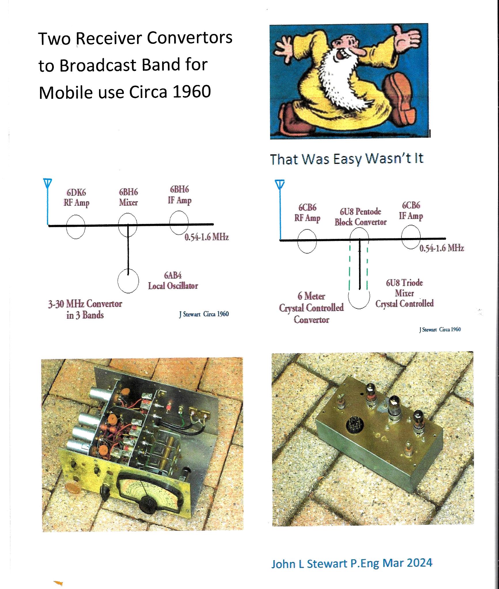

I've built many amps & receivers. These books were a great reference.
The photos are from a talk I gave at the local antique radio club a while back.
