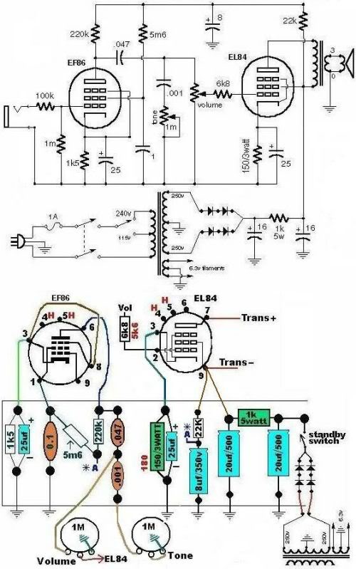

I like the changes in the schematic.

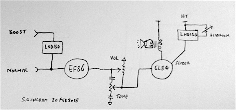

It might work, but not as intended. I need to swap around the networks between position 2 and 3. Then on position 2 (not connected) the screen is connected to HT via the zener and resistor (suitably sized to turn on the zener) and the when switched to position 3 it bypasses the zener for higher HT.

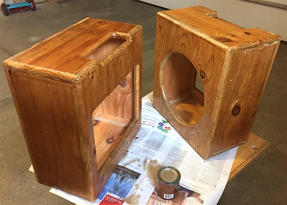

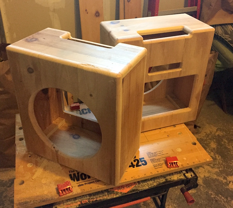

I've attacked the cabs with my roundover bit. I'm more than happy with the 1/2" size. The cabs are still rough looking - need to decide how to finish them. If I go with paint or something and want it all smooth then I need to fill the blemishes, if I go with the rustic look then I may leave the blemishes as they are since filler doesn't take stain very well.

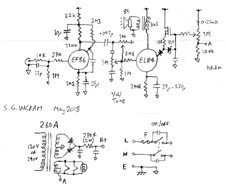

Well things just got really busy back in March and no progress has been made at all. I am going to try and make some progress again. I think a simpler approach is needed so I got some different power transformers - they are the smallest and lightest available from Hammond that give me the voltages I need as well as the flexibility to use the same trafo for the UK and Canada. The compromise is a little less current depending on how hot I run the trafo. And so I had to lose one of the tubes to save on current demand and keep it simple. If the gain is too low I will add a sand-pre stage.
I'm going to try a CRC supply instead of CLC to cut down on weight. The reality of how much stuff has to go into the little chassis has started to dawn on me now that I have some of the parts drawn out.
Attached is the simplified design. It's closer to the original design I posted, more VOX like. Even though gain is lower, the adjustable screen voltage on the output tube will allow the amp to be set up so that the front end can drive the output into distortion.
