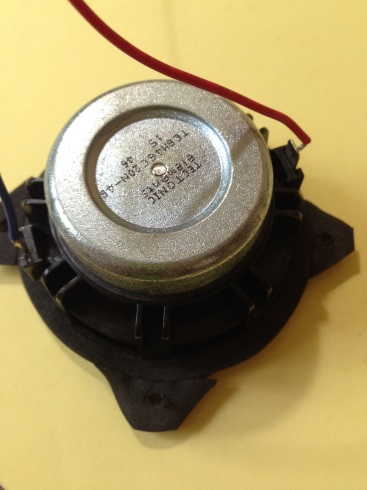

I purchased a pair of TEBM46C20N-4B BMR full-range drivers from PE long ago and put them aside. I finally got time to take action putting them in a box. I found sutiable box online. This is a plain box with a port as shown below. The net internal volume is around 1 L.
I measured each driver's free-air and delta mass (1 g) impedance for deriving TS parameters. I used them in EnclosureShop of LEAP simulation software to see how the box alignment for the existing port. TSL model of ES was used. The second graph shows SPL of 1 W and 20 W. No filling in the box was assumed. The alignment as shown is not perfect, but not too bad. The peak disappeared for rated input power. I will check the result against measurement.

I used a 60 mm holesaw to open mounting hole. The edge of the hole is chamfered at bit for good air flow. Foam gasket was placed surrounding the chassis to avoid air leak. The box was finished as shown.

I added a passive radiator to the box shown in post #1. The passive was optimized for another project. The tuning is too low for the box.
Image below shows simulated (solid) and measured near-field (dash) SPL.
