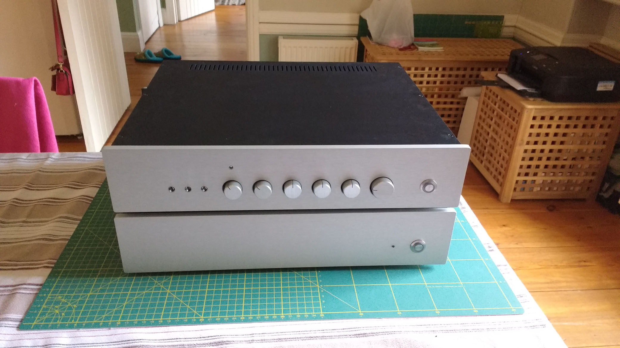

Great finish Geoff! Looks superb!
A few questions if you don't mind.
What case did you use?
What Mains power switch did you use?

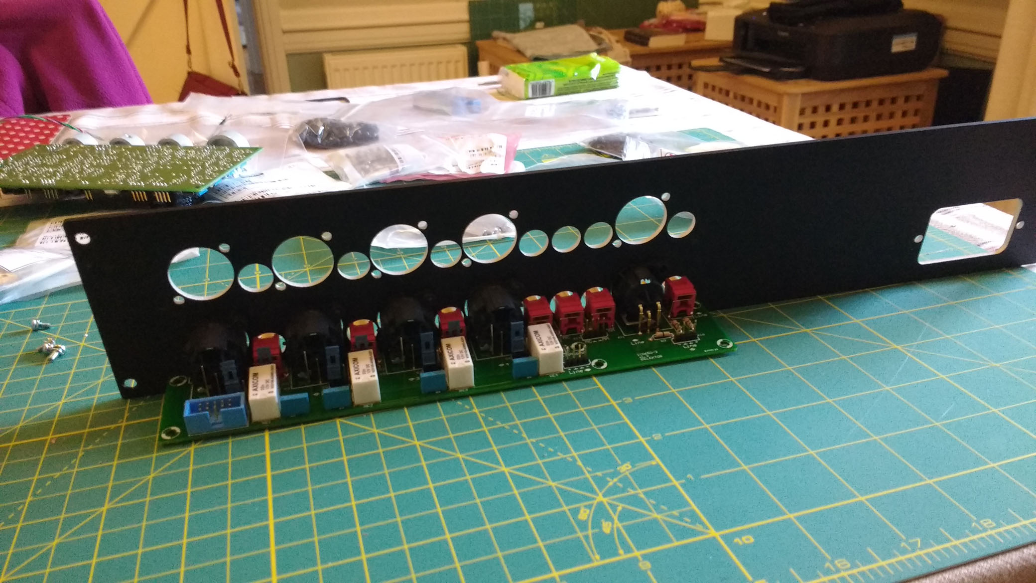

How did you manage to drill the holes for the Rear Panel pcb's?

It's the HiFi2000 Slimline 2U. It could easily have gone into something smaller but I wanted it to match the 100W power amp I was building at the same time.
The front panel mains power switch is a Schurter MSM L19 2 pole single throw illuminated switch (Farnell o/n 1637578)

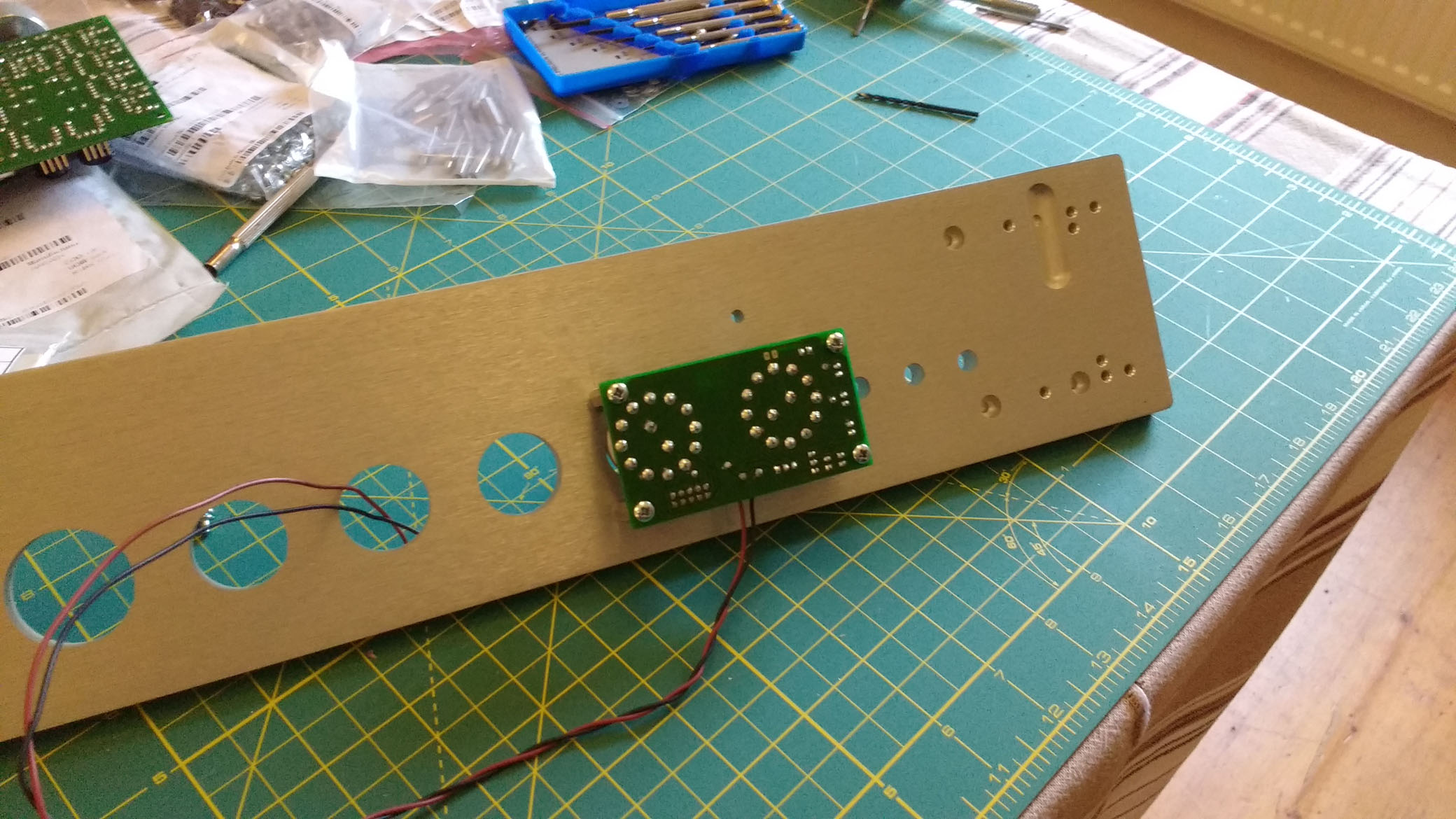

All the rear panel holes were done for me on a Water jet machine. The through holes (for knobs, switches and LED) were also cut on the waterjet machine. I had to drill the blind holes for mounting the front panel switch pcb on a pillar drill (thank you to my next door neighbour for use of it) and hand tapped them to suit M3 mounting posts.
I drew the panels up with a CAD package. I used LibreCAD 2D software at first, then switched to FreeCAD 3D software as my waterjet guy mentioned that most CNC machine shops prefer to receive 3D drawing. As a starting point for the panels, HiFi2000 have the case drawings available on their website.

It's a 100W class B (Doug Self Load-Invariant design).
I chose an Modushop by Hi-Fi 2000 | Contenitori per Elettronica | Electronic Enclosures | Hi Fi Chassis all black Dissipante case for the Elektor Q-Watt i built. 145W - 8 Ohms / 220W - 4Ohms. Great quality cases!
For the Elektor Preamplifier 2012 i down scaled the case and chose an RS | PF-19 Ventilated Rackmount Enclosure with Handles, 2U, 84 HP, 245mm Deep |

I used water slide transfers to do the labelling of the back panel. I tried this on a reject piece of front panel material but I (and especially the wife) wasn't happy with the results so I haven't labelled the front panel at all. It's not really a problem as once everything is set up to match power amp / speaker / room, the only controls being adjusted are volume (it has a larger diameter knob than rest) and the source select rotary switch.
If I was doing the panels again, I would get them engraved or laser printed at the same time as being CNC drilled.

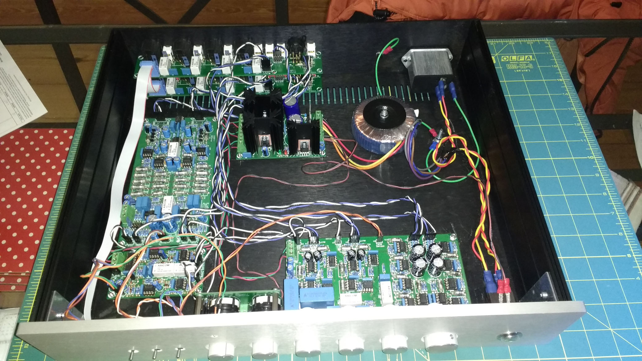

Wiring list is attached. Lengths and colours are what suited my case /internal board positioning.
Wire size, headers, crimps I used are detailed in previous posts (#35 - 39, if I remember correctly).
View attachment Interconnect.pdf
