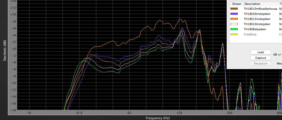

Here is what happens to the response of the Keystone sub, a tapped horn with a keystone shaped exit, when it's mouth is restricted progressively (10meter distance outdoor measurement) :
Fb is driven lower with each mouth size restriction resulting in slightly more low frequency output, while upper in band response takes a huge hit.
Air noise from reducing the mouth opening to a fist size probably won't be the big problem.💩

Wow I never saw this response, missed notification. Thanks @weltersys - I note that the upper response suffers but the lower isn't too bad under 150hz.

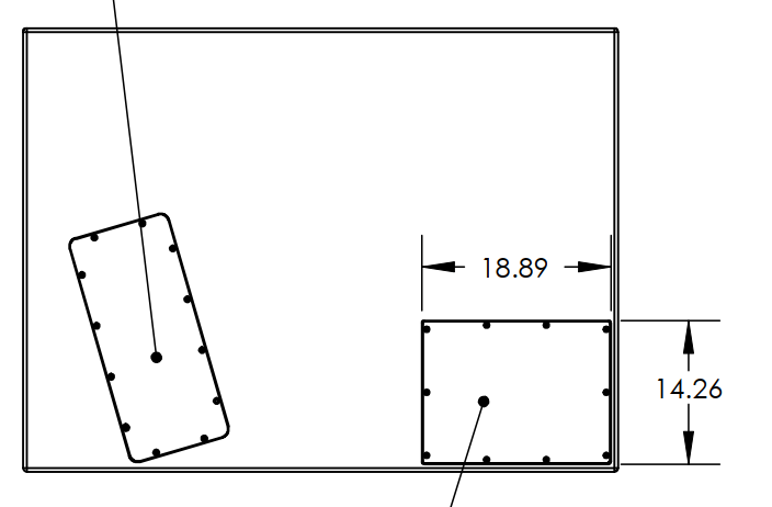

One big problem though, how would I "connect" the mouth of the DTS10 to the hole in the wall. I'm currently imagining effectively having the sub freestanding in the office with the output port close to the hole in the wall, building a bit of wood around it (aka building it into a cupboard) but I could never match the holes exactly, for one there'd always be a little space between the box and the wall.
Would some foam style material suffice? Or how would you create a short (1cm or so?) duct between sub output and wall hole?

A -6 to -9dB loss (a huge hit) on all but a 1/6th octave point at the lower impedance/excursion minima is very bad.Wow I never saw this response, missed notification. Thanks @weltersys - I note that the upper response suffers but the lower isn't too bad under 150hz.
I'm thinking piping the exit of a TH through a 5x5 inch (13 x 13cm) hole may throw away 75-90% of it's output except for a narrow band peak at Fb. I'm thinking 2x SVS SB13U will put out more LF than a DTS-10 piped through a (perfectly sealed) 5" x5" duct.
Ah apologies I had updated my assumptions to a much larger hole, e.g. 14"x18" - the full size of the DTS10 output.
I just need to aesthetically hide it, is a white speaker grille/cloth allowed or will that impact sound deeply?

If you are not reducing the horn's output size, going through a well sealed stud wall should not have much effect on the output.
Use a strip of 3/4" wide x 1/2" thick self-adhesive neoprene foam weather stripping around the 18.89" x 14.26" horn exit ("exhaust port").
Push the cabinet tight enough against the wall to compress the weather strip.
Then screw "L" brackets or wood blocks to the floor on three sides of the cabinet to prevent it from moving to keep the seal air-tight long term.
