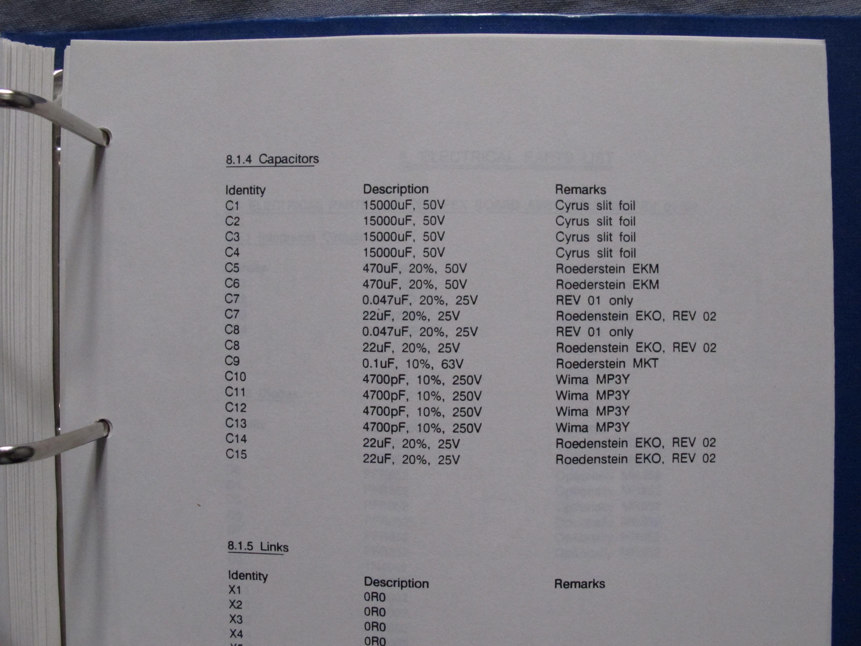

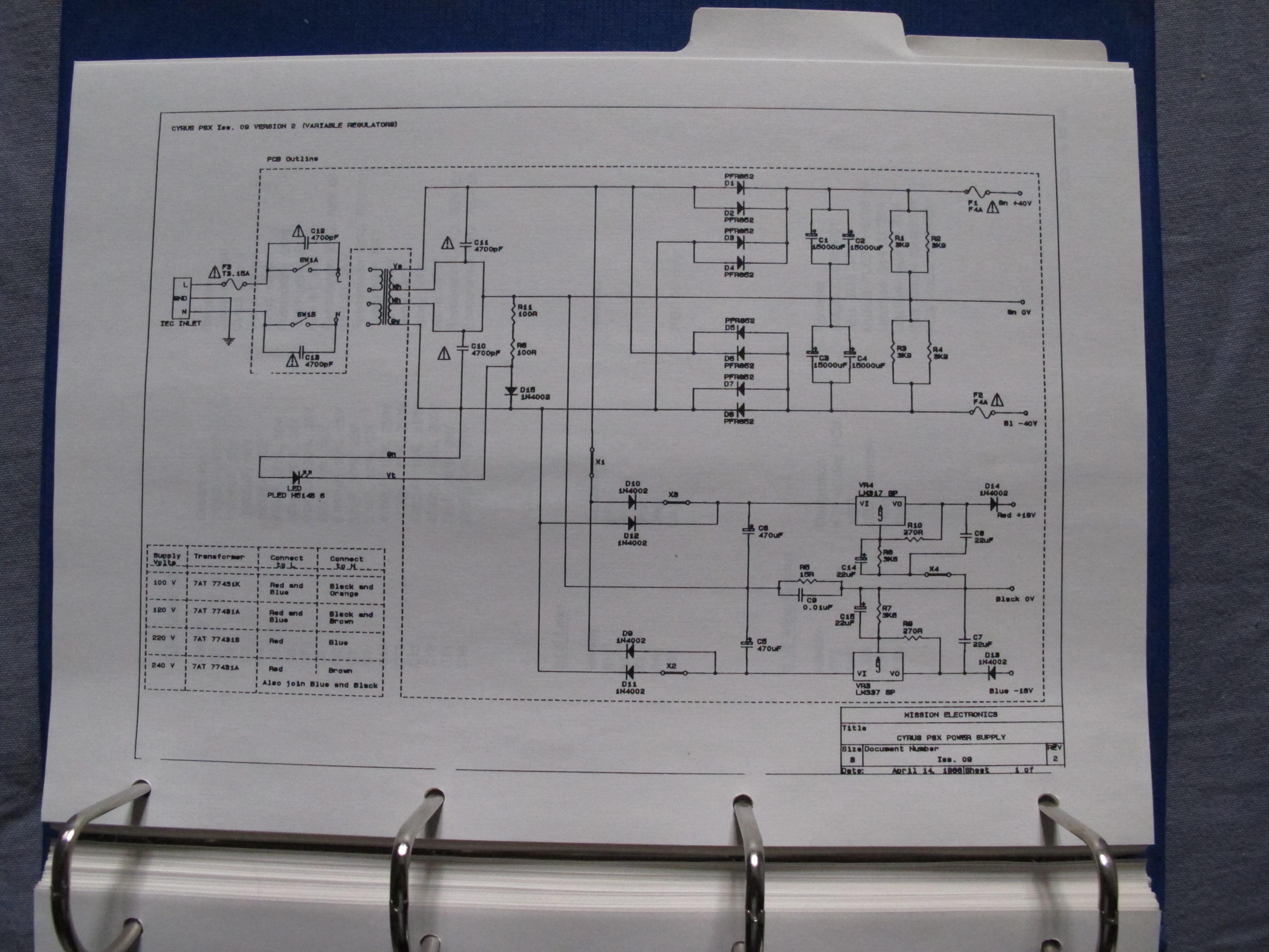

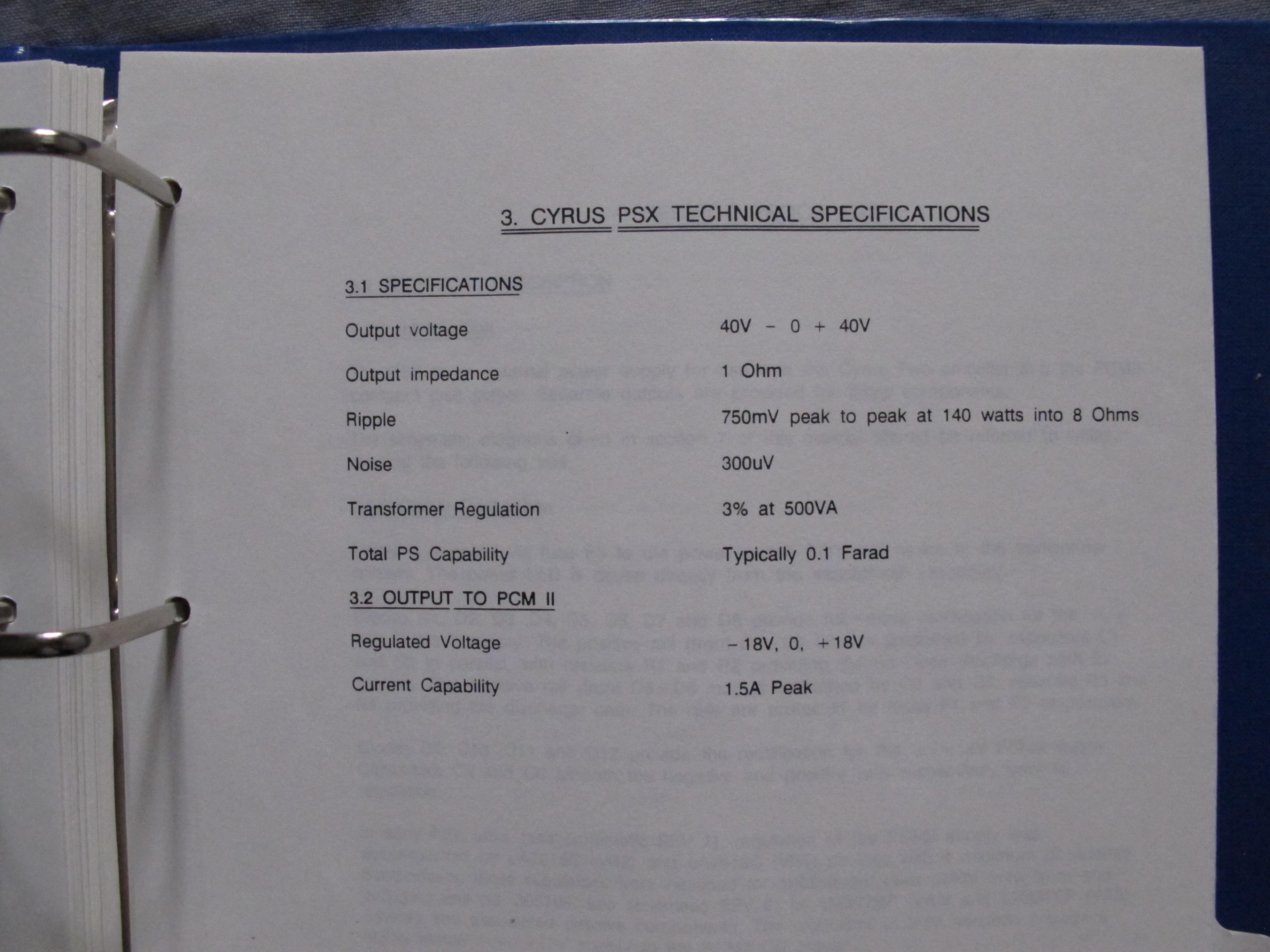

Cyrus PSX P/S sevice manual images
I have the actual complete "Mission" Cyrus service manual, obtained directly from Mission in 1989. I can make / take images and/or "copy" other aspects / pages if needed.

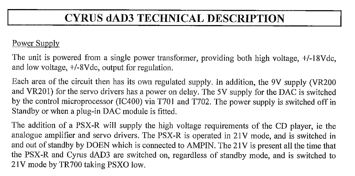

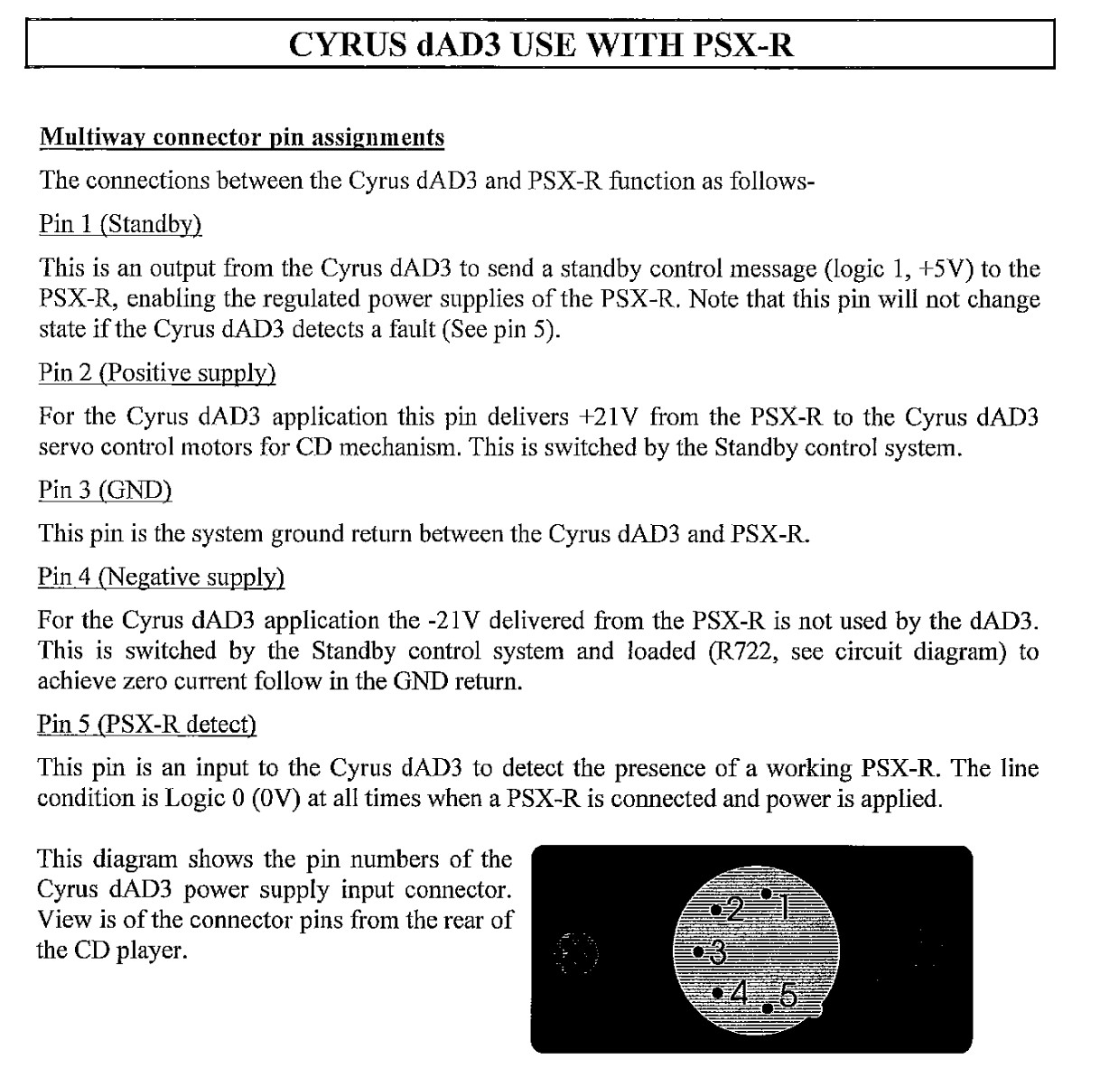

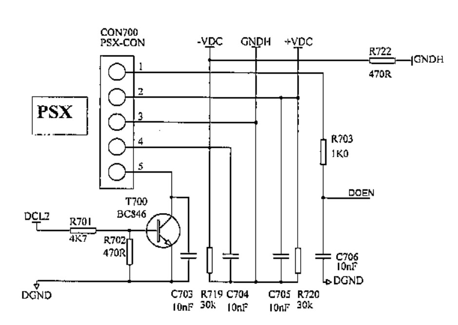

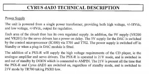

I looked into how to clone a PSX-R as well because I want to power my Cyrus Dacmaster with a diy PSU, and found the following information:
attachment.php
Page 6 tells us the wiring, maybe PSXO and AMPIN could be points inside the PSX-R:
attachment.php
I assume that with PSXO they mean pin5 of the Hirose connector and with TR700 they mean T700 shown in the diagram below:
attachment.php
These screenshots are taken from the DAD3 service manual but should explain how to get around the PSU detection.
I made a test by pulling pin5 low (by shorting pin3 to pin5 on the Hirose connector) but the Dacmaster still played music through the outputs: do I need to supply also +/-21V to pin2 and pin4 in order to make the DAC detect the presence of an external PSU?
