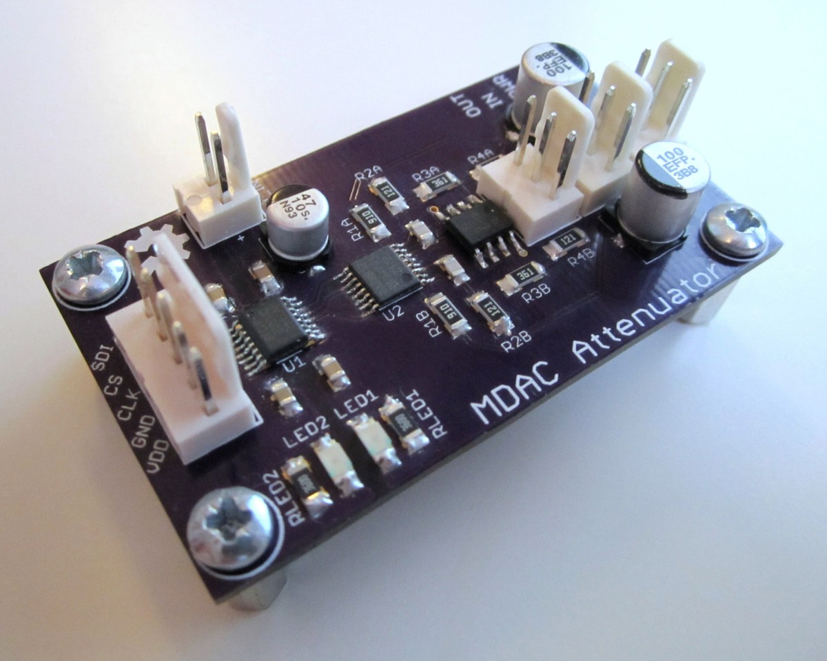

MDAC attenuator
I'll start with the volume control as this is at the core of the design and has the most impact on performance. Because I want to use a remote, the volume control needed to be digitally controlled. The options I could see were
- PGA2310/PGA2320
- A relay based attenuator
- CS3318
- Motor driven pot
- Something else
I'd had problems with many PGA23x0 designs, mainly noise. I'd already made and used a few different relay based attenuators. I tried the CS3318 which was good but I didn't find it very user friendly and fried a couple by simply not powering them down correctly. So I wanted to something else and eventually designed and built an attenuator based on a multiplying R2R DAC.
Although the design uses a DAC IC, the signal is never digital. The signal is converted to current (V to I), then attenuated using the solid state switches and resistors inside the DAC (an R2R ladder). Then converted back to voltage (V to I) using an opamp. It sounds elaborate but it's pretty simple and only uses 2x ICs and 2x caps (no gain) or 2x ICs, 2x caps and 4x resistors (to add gain) in it's simplest form.
All the details about where I got the design and testing can be found in this thread.
Some details about my MDAC attenuator:
- 65536 linear steps (16bit)
- Any gain possible, set by opamp and resistors
- SPI controlled with isolation by using ADuM7440
- Excellent performance (better than PGA2320 in my measurements)
- Can drive headphones
- Can take +/- 10V input
- Compact
- Cost about £35 to build with expensive parts, could be ~£30 with cheaper parts
Eagle schematic/layout and Arduino sketch are attached.

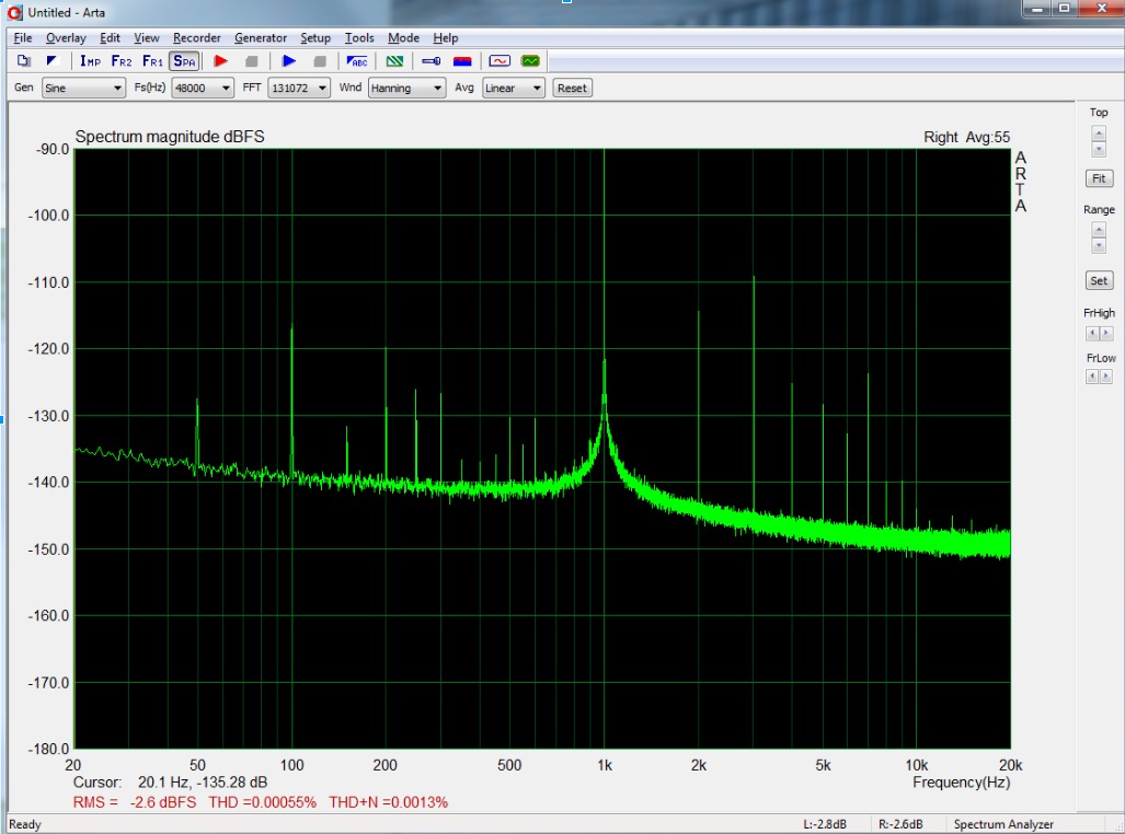

Here is an Arta screenshot. The curve is due to measuring with my E-MU 0404 USB, not the device itself:
399297d1392158148-solid-state-r2r-attenuator-using-analog-switches-multiplying-dac-mdac-arta.jpg

And here's a BOM for the MDAC attenuator:
U1 1827342 ANALOG DEVICES - ADUM7440ARQZ
U2 1390687 TEXAS INSTRUMENTS - DAC8812ICPWG4
IC2 1438872 ANALOG DEVICES - AD8599ARZ Description: IC, OP AMP, DUAL, SMD, SOIC8
C1A, C1B 1759181 MULTICOMP - MCCA000310 Description: CAP, MLCC, C0G/NP0, 2PF, 50V, 0805
R1A/B 1841733 PANASONIC - ERA8AEB910V Description: RESISTOR, 1206, 0.1%, 0.25W, 91R
R2A/B, R4A/B 1841735 PANASONIC - ERA8AEB121V Description: RESISTOR, 1206, 0.1%, 0.25W, 120R
R3A/B 1841744 PANASONIC - ERA8AEB361V Description: RESISTOR, 1206, 0.1%, 0.25W, 360R
C8 2326107 PANASONIC - EEE1AA470WR Description: CAP, ALU ELEC, 47UF, 10V, SMD
X1 1675767 MULTICOMP - MC34655 Description: HEADER, SQUARE PIN, 2.54MM, 5WAY
IN, OUT, PWR 1675765 MULTICOMP - MC34631 Description: HEADER, THT, VERTICAL, 2.54MM, 3WAY
C4, C5 1539485 PANASONIC - EEEFP1E470AP Description: CAP, ALU ELEC, 47UF, 25V, SMD
C1-3, C6-7, C9-10 2320839 MULTICOMP - MC0805B104J500CT Description: CAP, MLCC, X7R, 100NF, 50V, 0805
LED1, LED2 2217976 1206 LED Description: LED, SMD, 1206 BLUE; Bulb Size:-; LED Colour:Blue
RLED1, RLED2 1206 Resistor

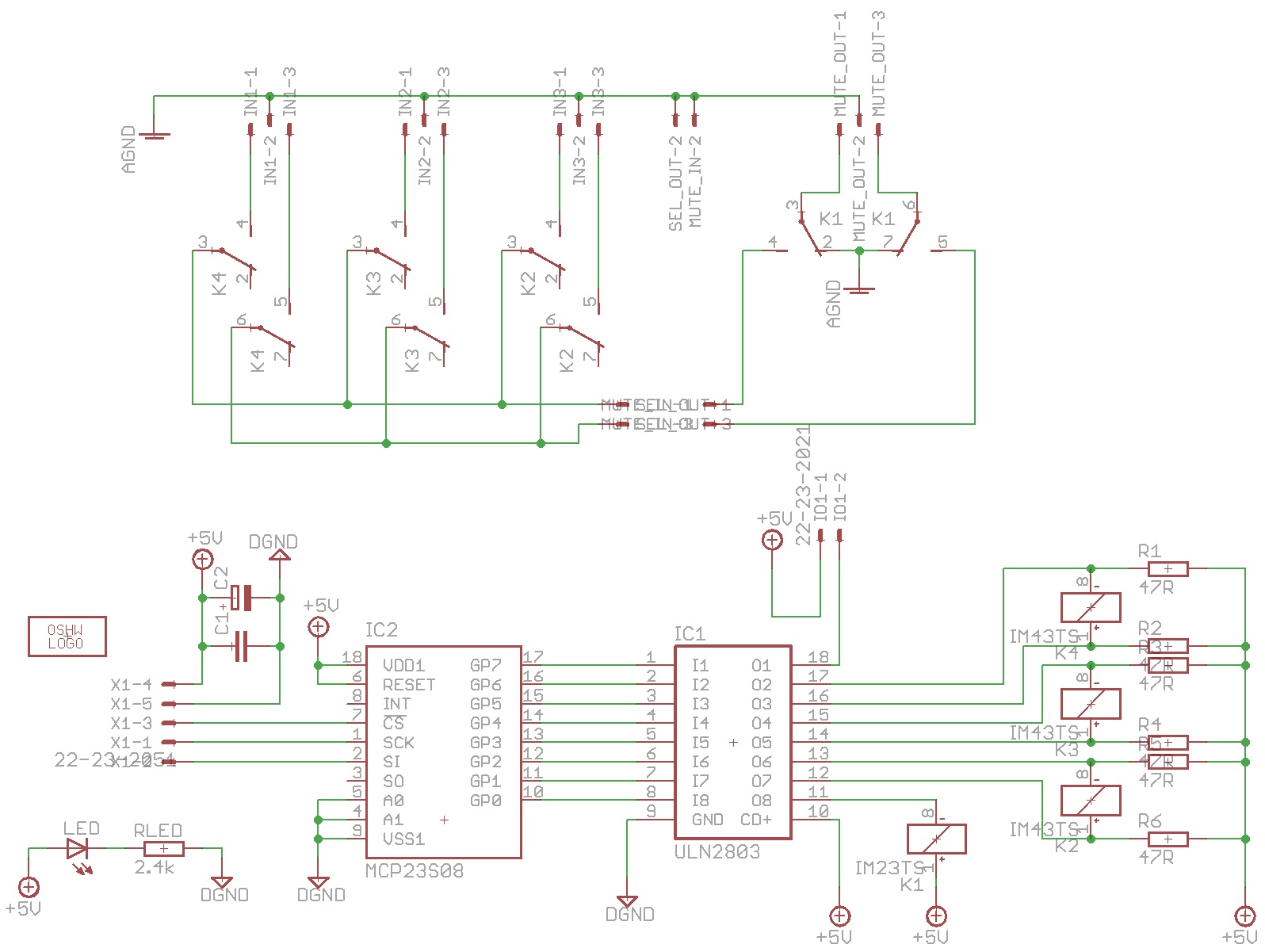

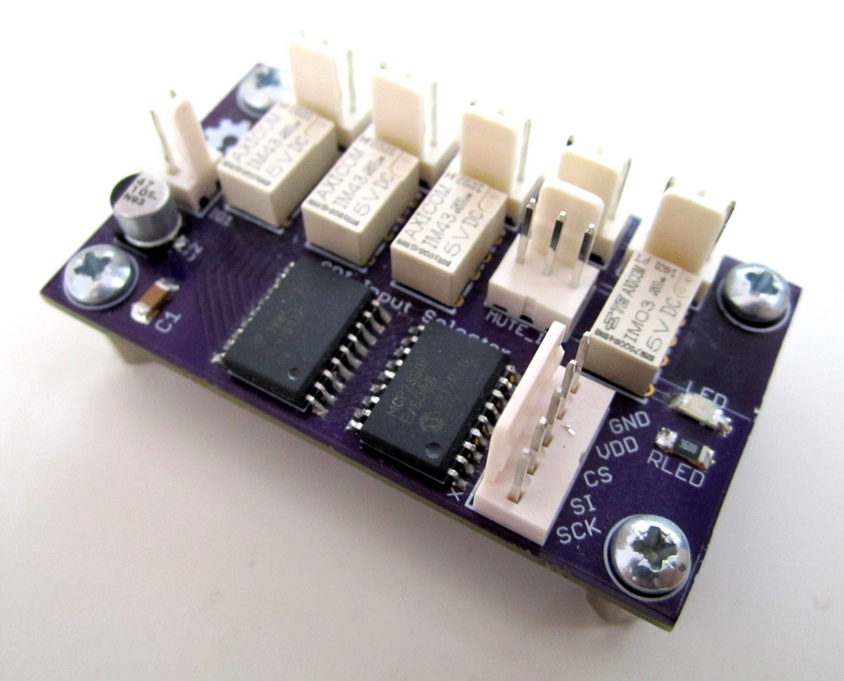

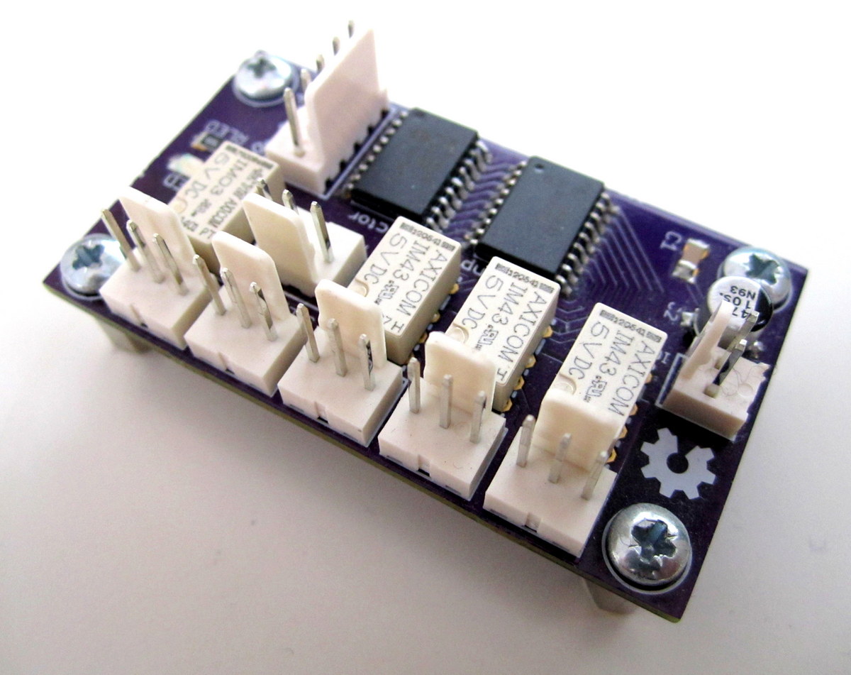

Input selector
For the input selector I wanted to use latching relays so they were not always on and to reduce power consumption. I also figured it would have to be SPI controlled to match the MDAC attenuator otherwise I would have to use two different control protocols which would be a pain in software and with the wiring.
I decided to keep it simple and just use 3x inputs and one mute output. This would allow me to use an 8bit I/O expander IC. Any more inputs and I would need more I/O as each latching relay requires 2x I/O channels.
Features:
- 3x inputs
- Mute
- 1x spare I/O (could be used for a power relay or something later)
- SPI controlled (MCP23S08 IC)
- Compact
- Costs about £19 to build
Pics and Eagle schematic/layout are attached.

BOM for the input selector:
IC1 1652419 TEXAS INSTRUMENTS - ULN2803ADW
R1-6 2332121 TE CONNECTIVITY - CRGH1206F47R Description: RESISTOR, POWER, 47R, 0.5W, 1%, 1206;
K1 1175066 TE CONNECTIVITY / AXICOM - IM03TS Description: RELAY, DPDT, 5VDC, 2A, THT; Coil Type: DC Monostable; Contact Configuration😀PDT;
IN, OUT etc 1675765 MULTICOMP - MC34631 Description: HEADER, THT, VERTICAL, 2.54MM, 3WAY;
X1 1675767 MULTICOMP - MC34655 Description: HEADER, SQUARE PIN, 2.54MM, 5WAY;
C2 2326107 PANASONIC - EEE1AA470WR Description: CAP, ALU ELEC, 47UF, 10V, SMD;
C1 1414725 KEMET - C1206C224K5RACTU Description: CAP, MLCC, X7R, 220NF, 50V, 1206;
K2
-4 1770588 TE CONNECTIVITY - IM43TS Description: RELAY, DPDT, C/O, 5V, LATCH; Coil Type: DC; Contact Configuration😀PDT;
IC2 1332092 MICROCHIP - MCP23S08-E/SO Description: 8BIT EXPANDER, I/O, SPI I/F, SMD;
LED 2217976 1206 LED Description: LED, SMD, 1206 BLUE; Bulb Size:-; LED Colour:Blue;
RLED 1206 Resistor
Reactions: starcat

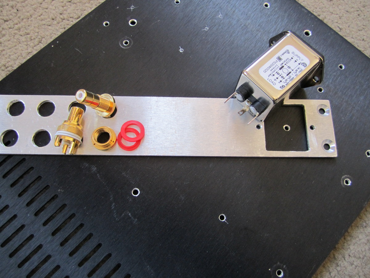

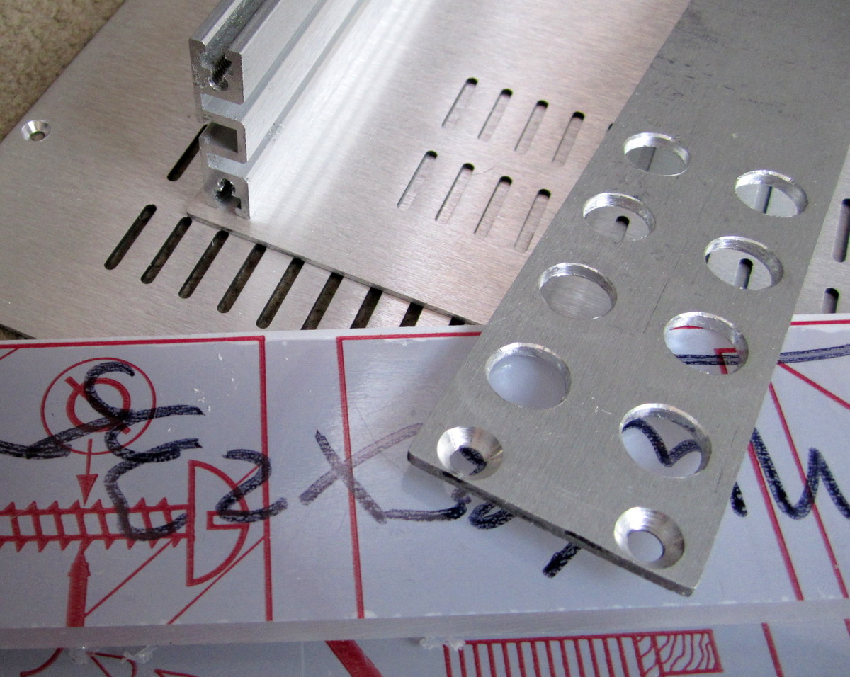

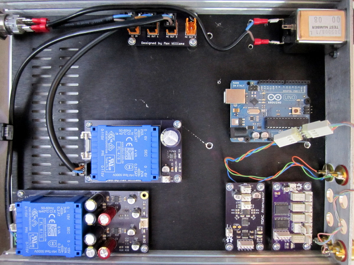

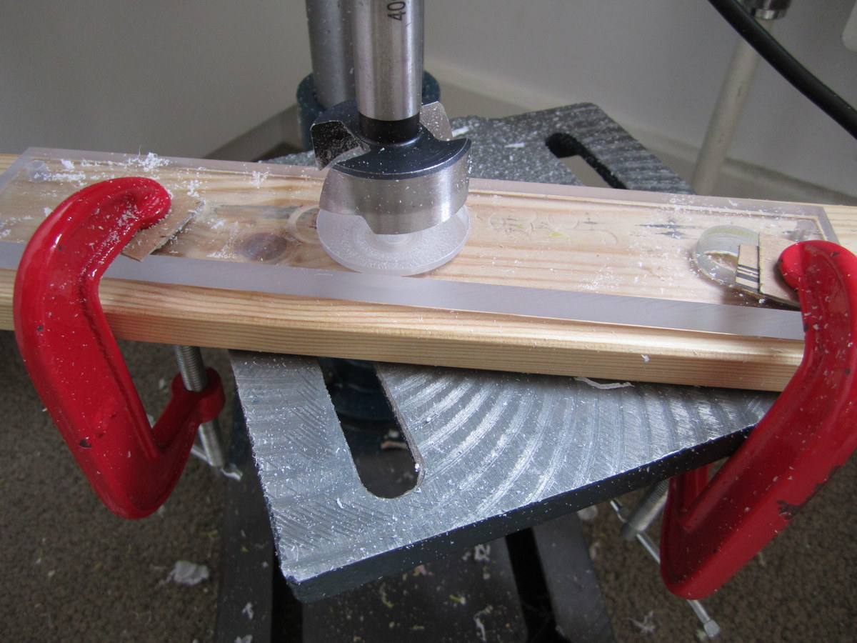

For the case I use the Modu Galaxy as I wanted it to match my Hypex amplifier. They are nice cases, easy to put together and modify. I asked them to send me a non-anodised one as I prefer the look of bare aluminium compared to black anodising. It also makes grounding much easier. I am going to try and make a front panel out of 10mm transparent acrylic but still working out the details.
Reactions: starcat

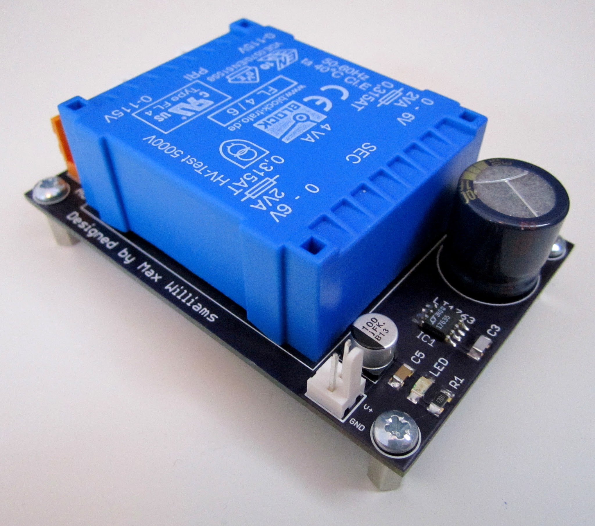

5V Power Supply
I needed a compact 5V power supply to power all the digital items and the DAC in the MDAC attenuator.
It needed to power:
- The Arduino
- MDAC attenuator (Just the DAC IC)
- Input selector
- IR
- Encoder
- LEDs
I wanted something with low noise so that it wouldn't impact the performance of the MDAC attenuator so I designed one with a LT1763 regulator. It's pretty simple, there is a thread about it here with a BoM, layout and schematics.
Current output: 500mA
Cost: ~£25

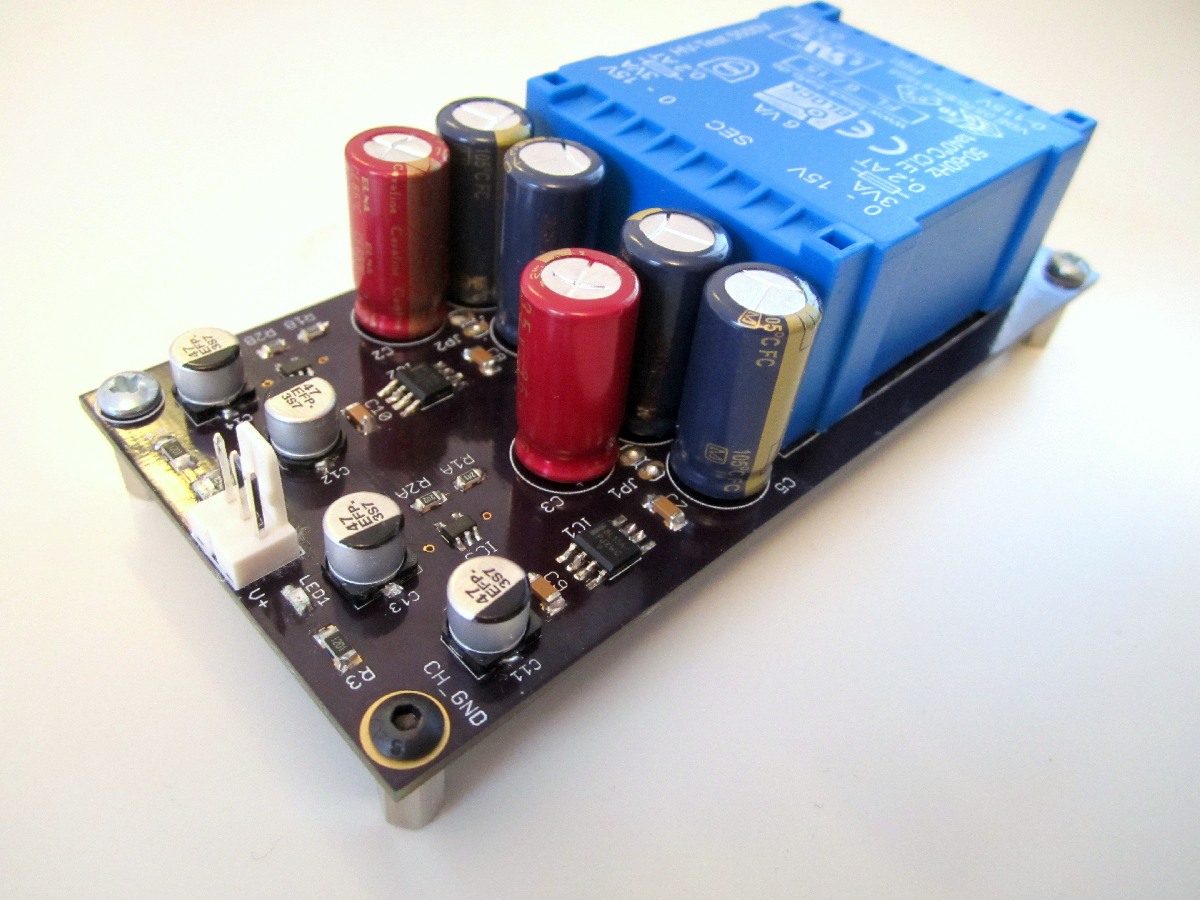

+/- Power Supply
The opamp in the MDAC attenuator needs +/- power. Again, I wanted something low noise and compact so settled on a design that uses 78/79Lxx regulators and then LT1761/LT1964 regulators. There is a thread about it here that inlcudes a BOM, layout and schematics.
Current output: 100mA
Cost: ~£36

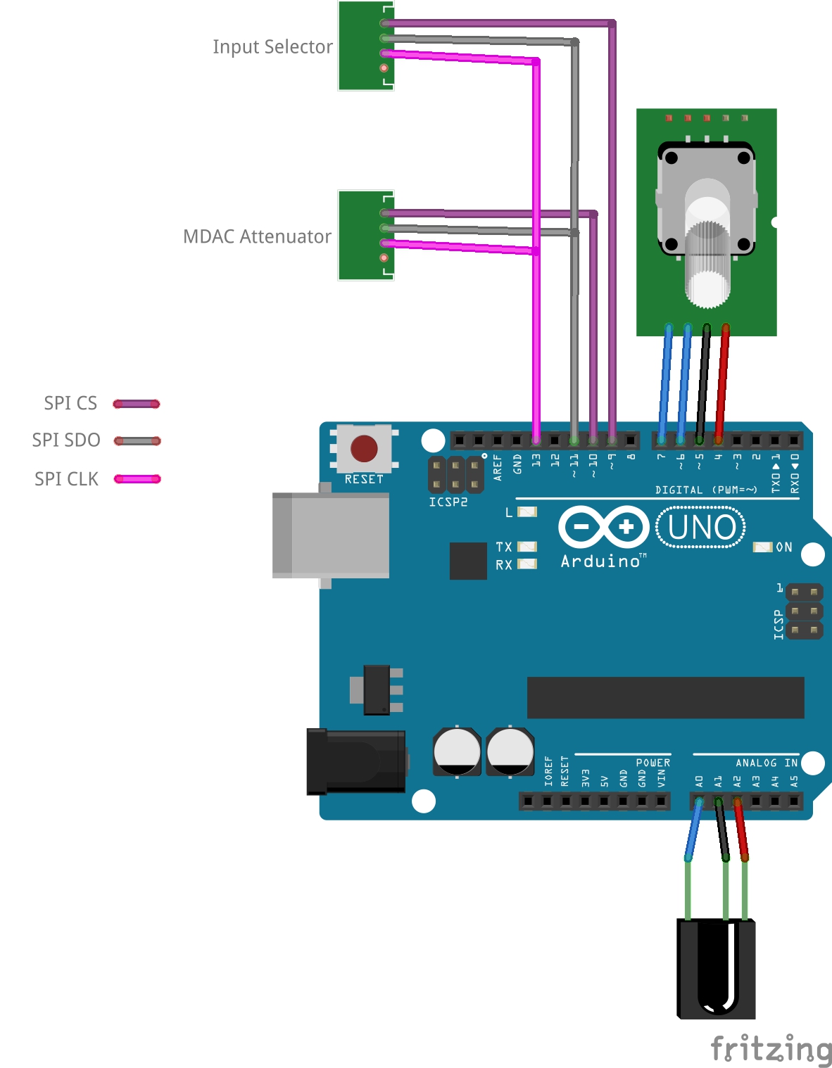

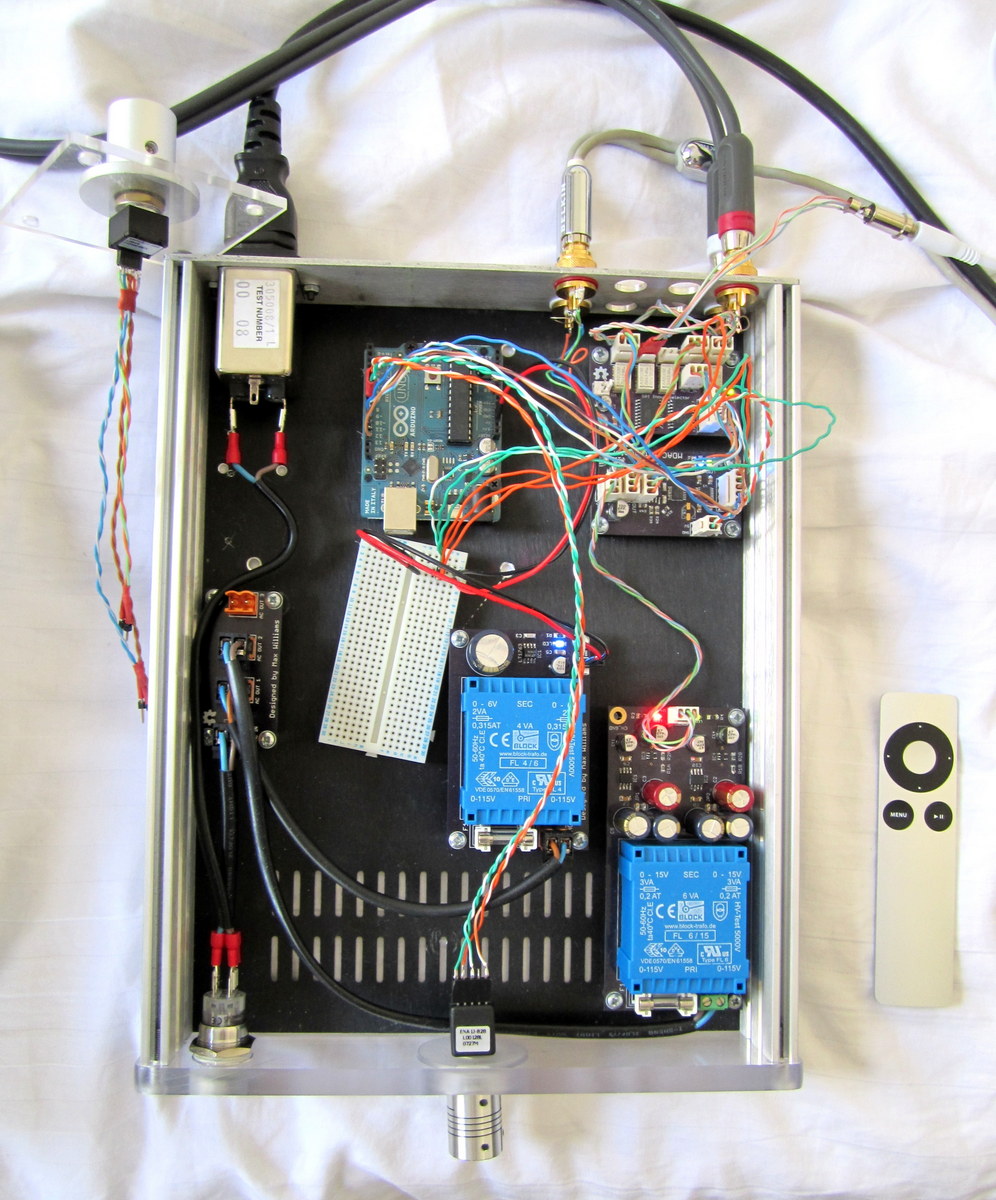

For a microcontroller I'll be using an Arduino Uno R2. They are easy to get, cheap and really easy to program as there is so many examples and libraries already available on the internet. I'll post my full code as it progresses.
Here is version 1.0 of my Arduino code.
Features:
- Control via encoder and Apple remote
- Volume up/down and switch inputs
- Controls both the attenuator and input selector
Still to do:
- Accelerate volume step size when using the remote as it's too slow
- A mute function
- Save volume level to EEPROM
