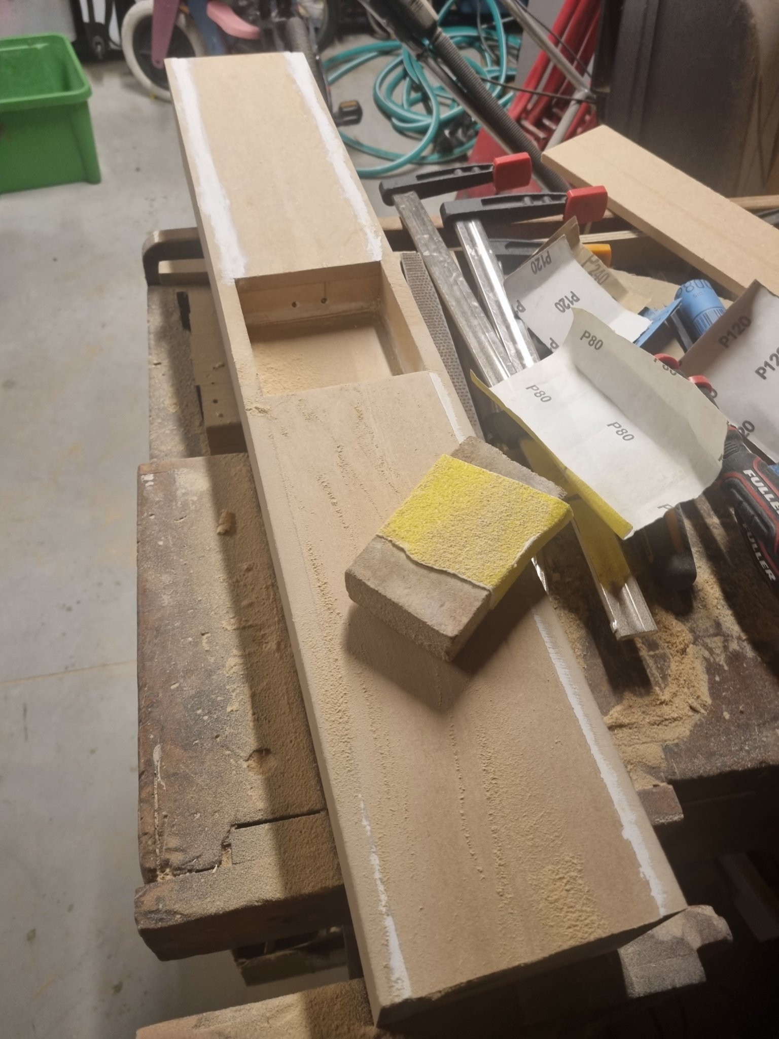

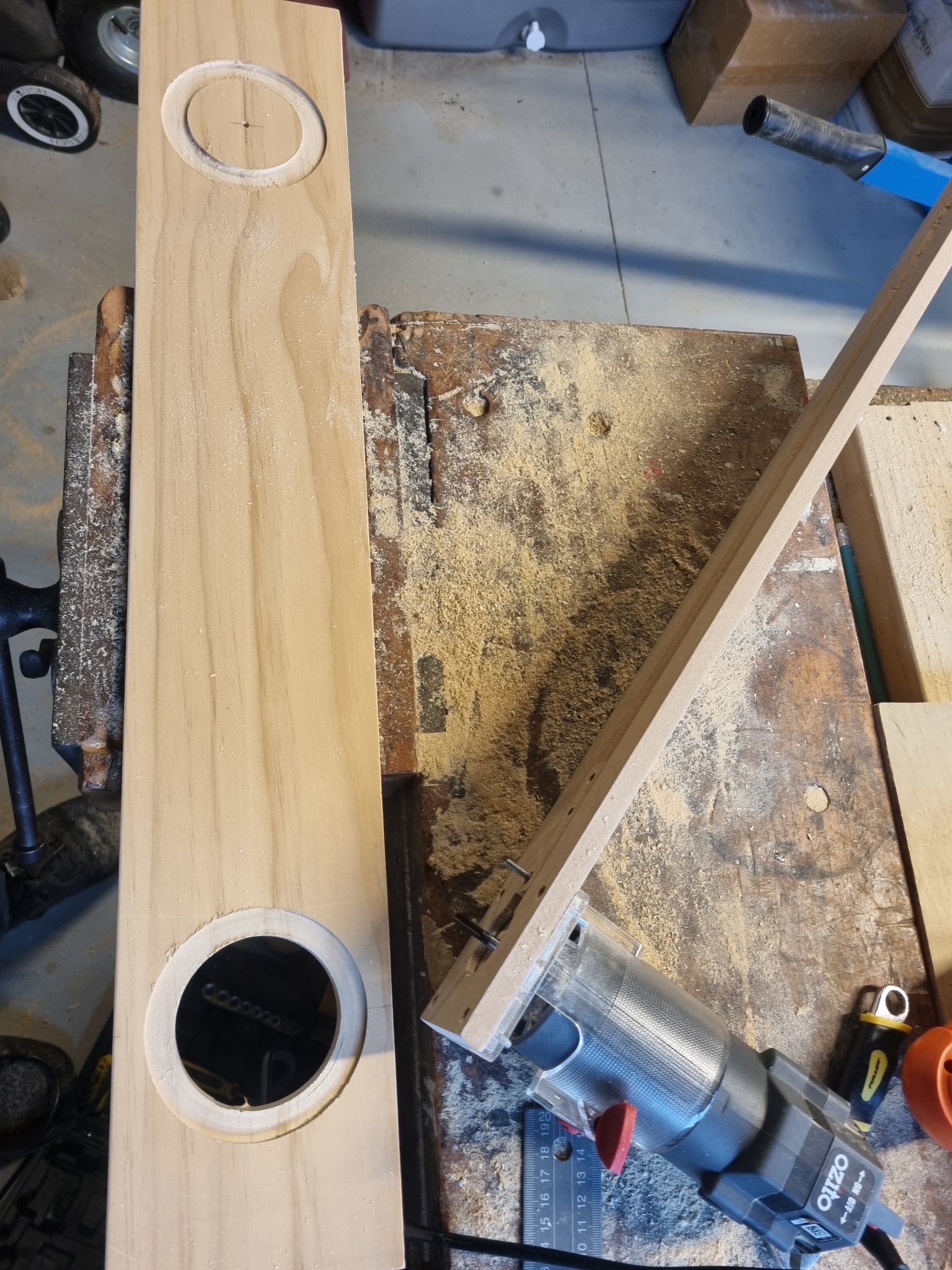

First in-progress pics. Made a simple circle jig (it's very satisfying to router a perfect inset speaker - a first for me). Now up to the super-fun sanding and filling stage...
