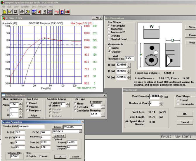

Hi pikipupiba,

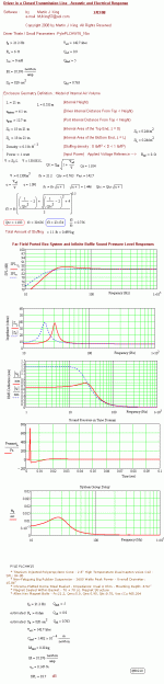

Here is another simulation for a 5 ft^3 vented enclosure, this one is done in Boxplot. Please, notice that I'm adding a 42Hz, 1st order low cut filter to cut down on the low end bump and to prevent excessive low end excursion, the -10dB point is @20Hz. 5 ft^3 is also just fine for a sealed enclosure, for -10dB @ 20Hz you now need a 27Hz 1st order low cut filter, and the response looks smoother.
This size box would also be a good thing to have around to measure T/S parameters. As long as we don't have the parameters for the speaker you have, we are all just guessing.

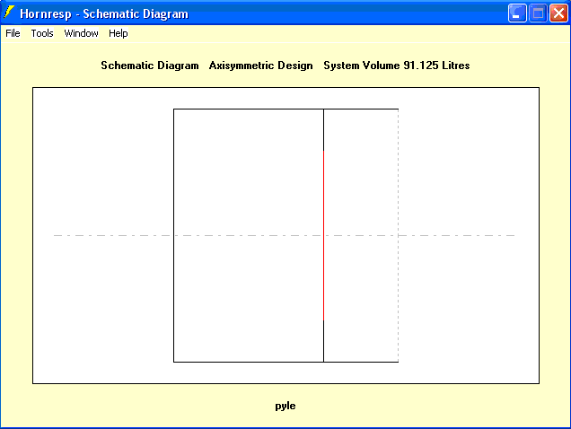

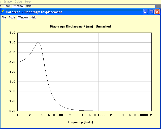

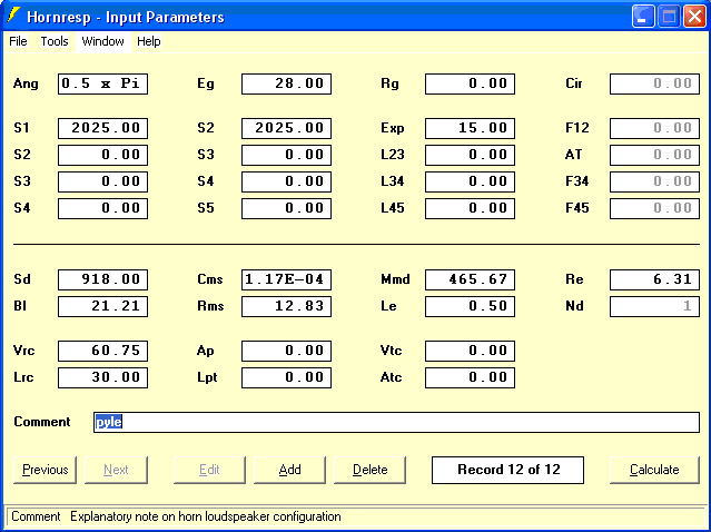

Here's a nice, small, simple box for the Pyle driver.
width = height = 1.5 ft
depth of closed space behind driver = 1 ft
depth of open space in front of driver = 6 inches
Turning driver back-to-front so magnet faces out will give better ventilation, higher power handling.
edit: I kinda guessed some of the parameters - hopefully close enough.

In the first pic below:
Black line is the original,
Red line is with the enclosed volume increased from 1 ft deep to 2 ft deep,
Blue line is with the open part increased from 6 to 10 inches deep.
So, with more closed space, it goes a bit deeper but with less sensitivity. Greater length of open space gives more of a peak at the top end, but at a slightly lower frequency.
btw, all of these are with 100 watts input and the speaker in a corner, so results are comparable with what djk posted earlier.

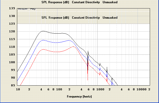

Pulling the speaker out from the corner gives more of an upward slope in the response. In the second pic below:
Black = in corner (1/8 space)
Blue = on floor, against a wall (1/4 space)
Red = on floor, away from walls (1/2 space)
