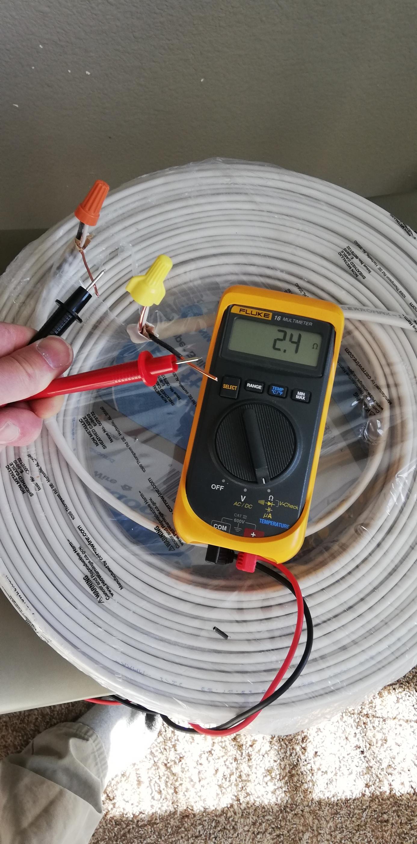

250 feet 14-2 with ground wired in series.
2.3-2.4 ohms
We want non-inductive loads for audio testing.

I never could figure out the reasoning for using non-inductive resistors.
As I see it, in actual use, speakers themselves are inductive devices, not purely resistive.
So that would thus be more of an "actual" load.

I do not see a real reason why an audio amplifier needs to be tested into a non-inductive load.

EBG power resistors on my experience, are the lowest distortion high power resistors available. The are non inductive bulk metal with a large thermal transfer surface for a heatsink or CPU cooler. I was able to get orders of magnitude lower THD using these vs wirewound rheostat ceramic style ones.

Because it adds distortion to an amp being tested. The amp’s performance is usually defined as a non inductive pure resistor.

Well, if we run a square wave test to check the amp's compensation, any (partially) reactive load may mislead the interpretation of what we see on the scope.
