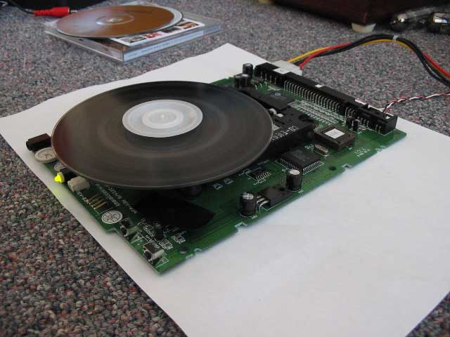

This is what i use. AND i love it.. sounds GOOD.
Mikelo said:
Post 223 is critical of using CD-Rom drives. Meridian 588 and later
uses CD-rom drives with tremendous results. HOwver, they don't rely on the drive but a huge buffer.
The post is not critical of using CDROM drives per se, just the practice of using the drive in CD-DA mode and using the SPDIF output. It also points out the difficulties involved when treating an audio Cd as a data CD.
Having only ever heard the Meridian in passing , I'm in no position to comment on the results of Meridians choices but I would doubt that they are using the drive in CD-DA mode or filling their huge buffer via the SPDIF port at a speed of 1x.
