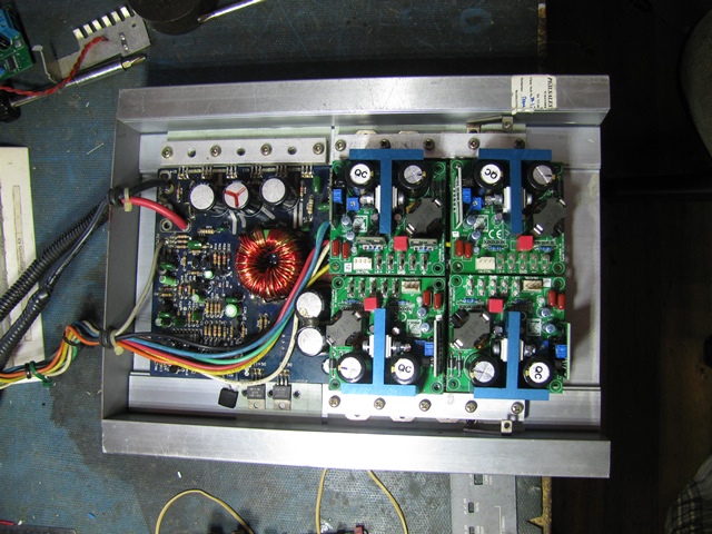

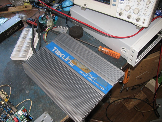

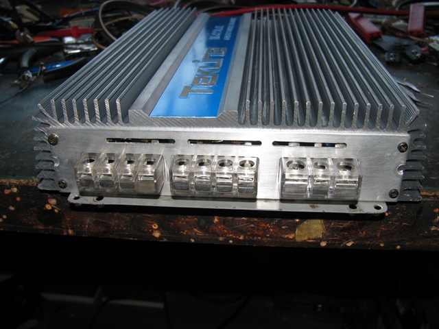

Suddenly dawned on me that an off the shelf car amp would be a good way to have most of the difficult parts already done. Looked at the bunch of car amps I got from a local repair shop for a good one and ended up with a generic one from the 90's.
attachment.php

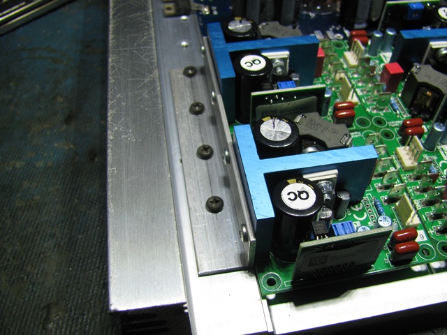

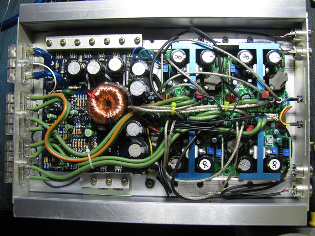

Took the bottom plate off and the four UcD180HG modules fit in it like a glove.
attachment.php

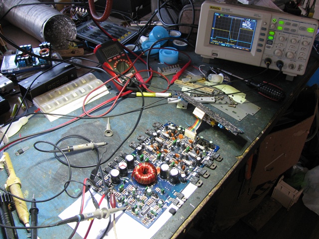

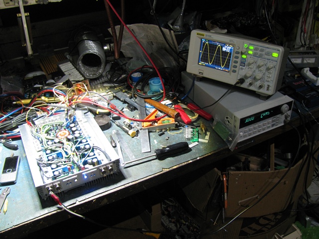

Testing the powersupply and looking for the signals for DC protect, overcurrent and delayed mute signal. Which, luckily, can very easily be integrated for use with the UcD modules!

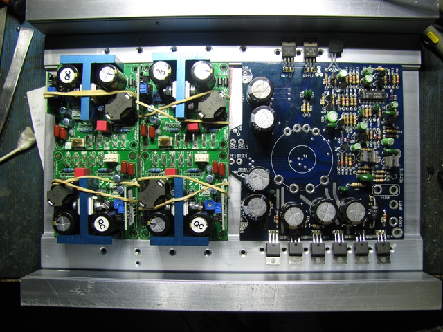

attachment.php

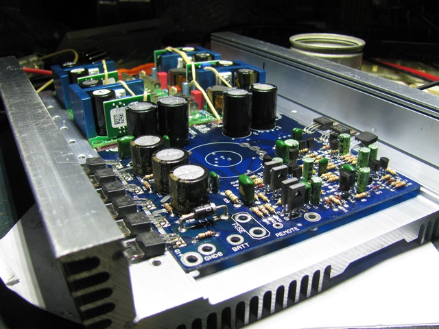

Powersupply chopped off, cleaned and replaced stuff to handle the higher power this will be designed for. And it still fits, barely.
attachment.php
Original powersupply fets are IRFZ30. Replaced them with IRF3205, changed the 220ohm gate resistors to 22ohms and changed the driver transistors for higher current. Transformer will be rewound for higher output voltage and more copper for more current.
attachment.php

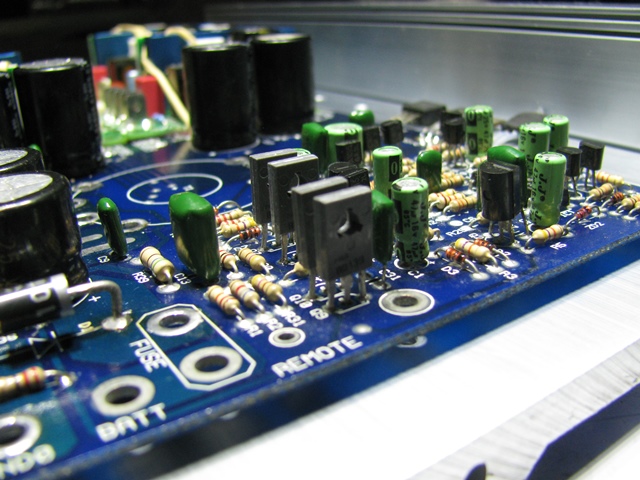

Original gate drive transistors were the 100mA rated C1815/A1015 transistors. Replaced them with BD139/140 pairs which have the same pinout in the PCB 😀

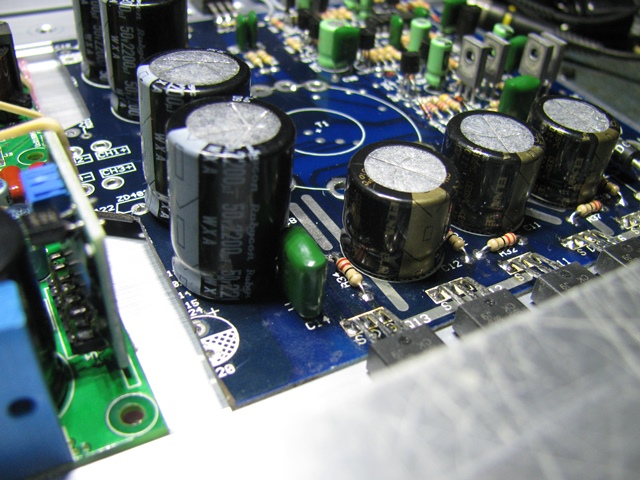

attachment.php
Replaced the powersupply caps with Elna/Rubycon since I didn't like the old no name caps which won't survive the expected higher rail voltages anyways.

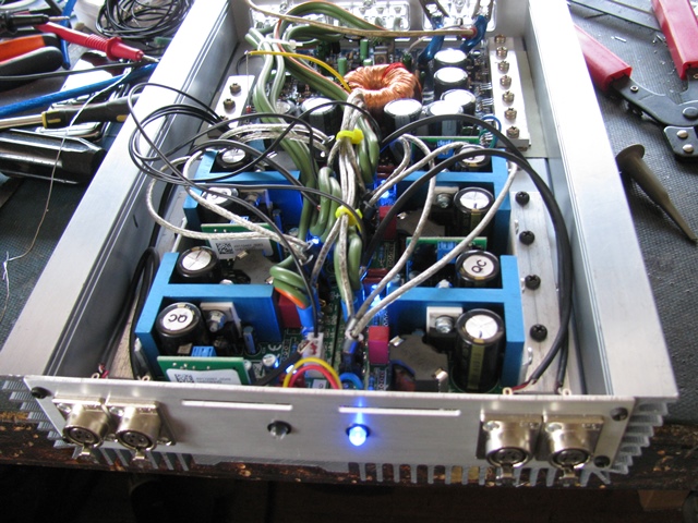

Did a bit more work tonight...

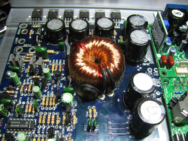

Rewound the transformer secondary for 50V rails. Used DIY litz wire with 40 strands of #31 wire.
attachment.php
Angle bracket to hold the hypex modules
attachment.php

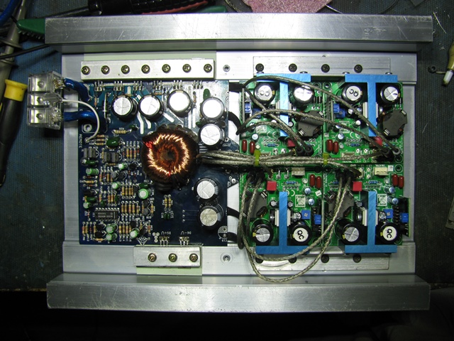

Wired up the power supply lines. I ran out of wires to connect the speaker terminals to the amp modules.
attachment.php

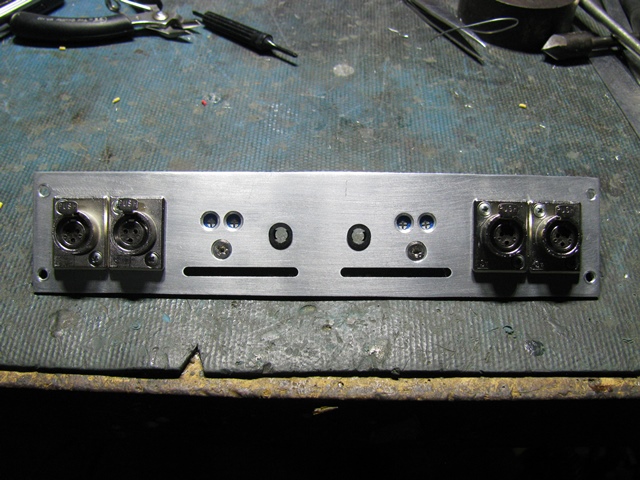

Now I need some alu sheet to make the end plates.

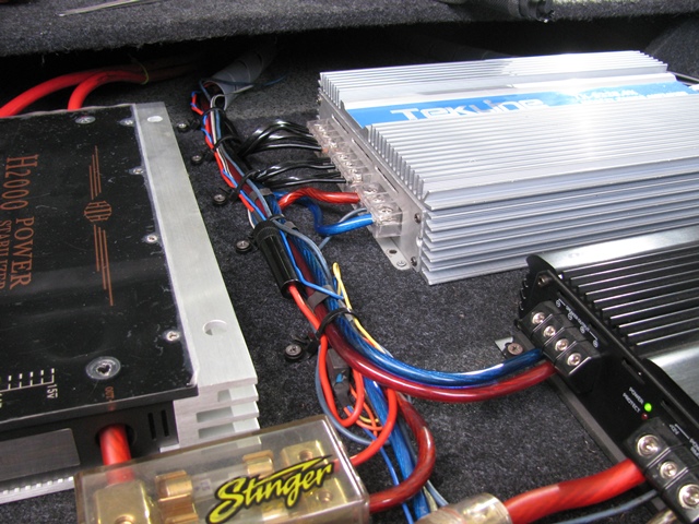

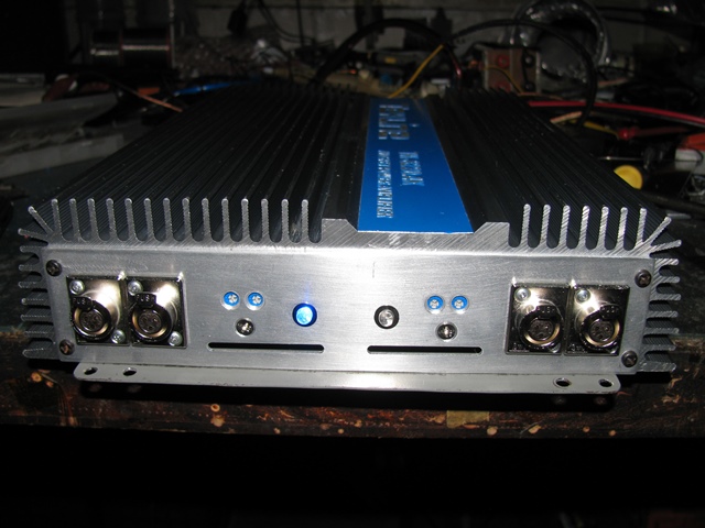

Amp is now installed in the car. Very nice sounding except for a loud turn on pop. Other than that, my concern regarding the switching frequencies interacting with the multiple modules did not occur, it is dead silent. Just need to add an attenuator. Gain is too high for my use.
I'll post pics later once I tidy up the install
Here are some more pics!

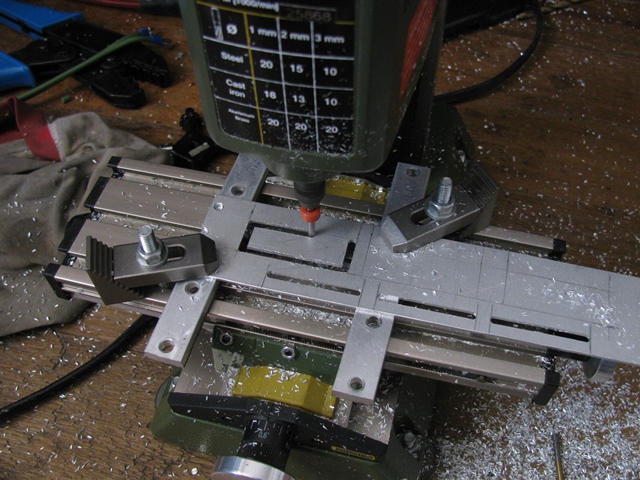

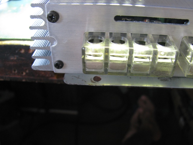

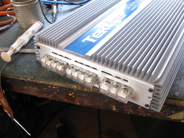

Used my micro mill to cut the rectangular holes for the terminal blocks.
attachment.php
End panels finished:
attachment.php
attachment.php
And it lives!!! No fireworks!
attachment.php
Here's the rats nest 🙂
attachment.php

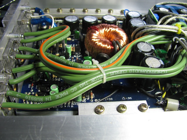

Tchernov audio speaker wires used to connect the UcD180HG modules to the terminal blocks

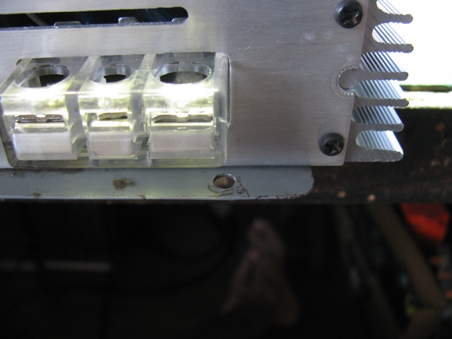

Design fail. Terminal blocks ended up covering the mounting holes.
attachment.php
attachment.php
Ended up drilling new mounting holes.
attachment.php

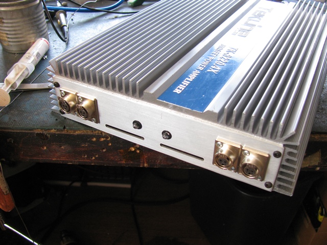

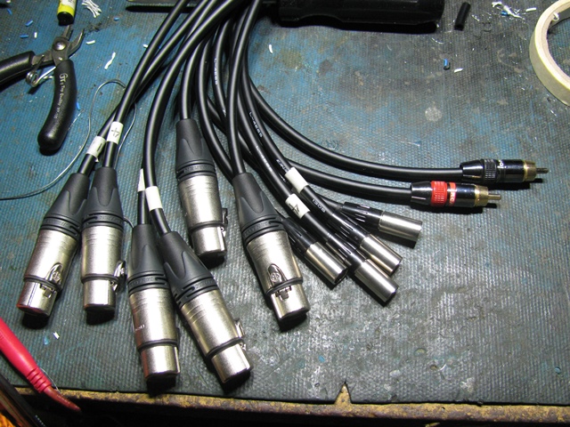

Canare Star Quad cables with Neutrik XLRs, Switchcraft mini XLRs to connect the amp to the DCX2496.
attachment.php

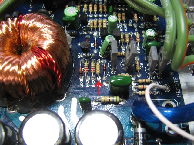

I was able to fix the popping sound by adjusting a resistor value so that the amp unmutes well past when the DCX boots up. Now it's just a faint "tick" on the tweeters.
The transformer holds up just fine. The other two channels only drive the tweeters so there's not much strain on the PSU.

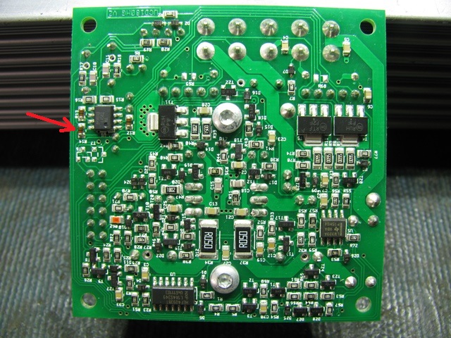

I also reduced the gain of the UcD modules from 21X to just 4.5X (by removing a resistor on the op amp stage on the Hypex module) and it's still a little high but can be tamed. Sounds even better now.
Some more....
To change the delay I increased this resistor (originally 47k) to 330K to increase the unmute time to about 3.6sec. Well beyond the boot up time of the DCX2496. Pretty much solved the pop issue 🙂
attachment.php
And I removed this resistor to decrease the amp gain from 21dB to 13dB. Still a little high but can be managed by the DCX2496 gain adjustment to tune for driver efficiencies. I could have used an attenuator on the input but that would put more parts in the signal path (and we know what happens if you do that :shhh: )

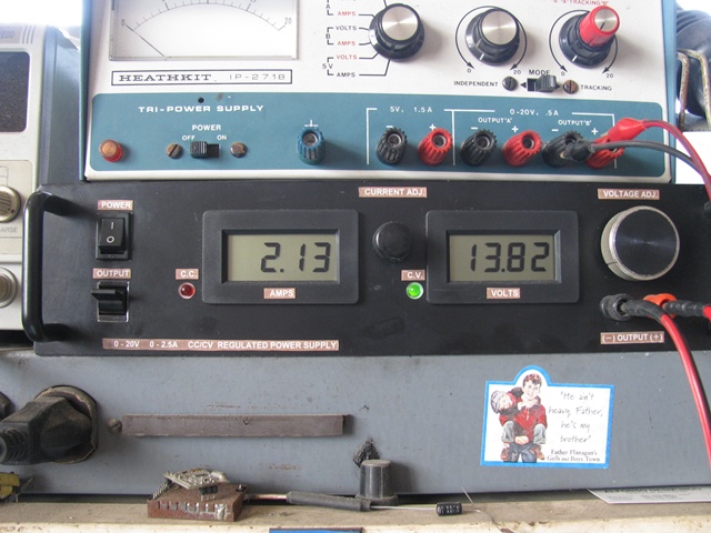

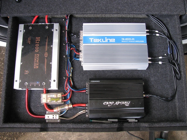

current draw on the test bench. Since I'm using a regulator, I'm pushing 14.6V into the amps no matter what the battery voltage is. At that voltage, idle draw is about 2.35A with 50V rails. (rail voltages are 45V at 13.2V input, 42V at 12.6V input)
attachment.php

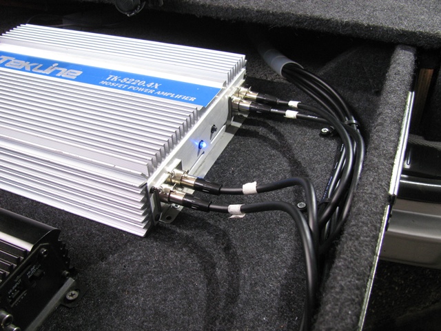

rearranged the amprack wiring to make things look neater
attachment.php
mmmm, balanced inputs 🙂
attachment.php
amprack overhead view. Where is the DIY amp? :camoufl:
attachment.php

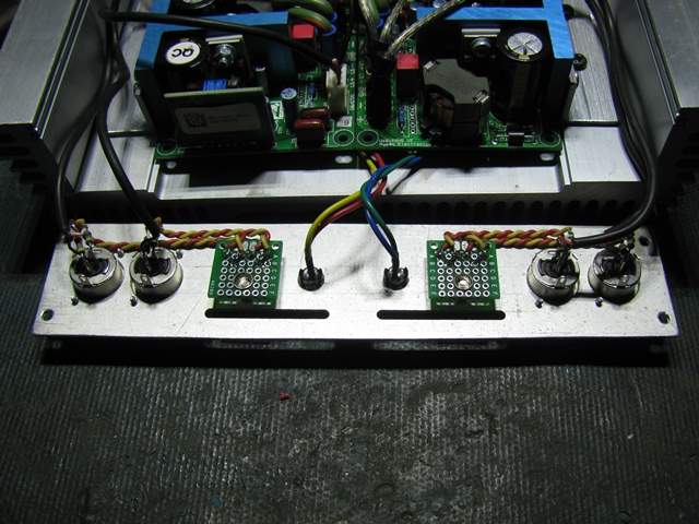

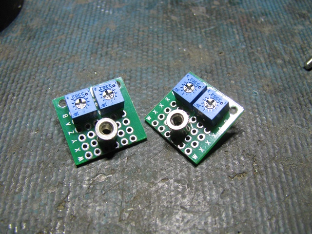

I found out the hard way that a gain control is a necessity. So I figured out a way to put one in the amp.
Made a couple ones mounted on perf board using the sealed Bourns 3362 trimmers.
attachment.php
Installed in the input panel. (I measured twice, drilled once. And it still came out misaligned. 😡 It's not too obvious though)
attachment.php
Back side. The resistors behind the mini XLR jacks are 10K 0.1% 25ppm. I got them from a scrap PCB which has a bunch 😀
attachment.php
Setting the gain to be the same as my old amps so I can reuse the old preset in the DCX2496
attachment.php
Input panel with gain control
attachment.php
