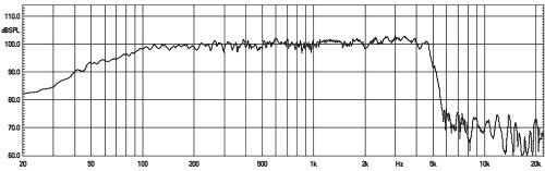

I have found some candidte drivers which are close including the Audio Technology Flexunits 15" which is a polypropylene cone with a well behaved rolloff
A couple of other units are possibles including the 18 Sound 15NW530 which is fairly well behaved, this one could be EQ'ed when dealing with baffle step response with a larger series inductance / parallel resistive network.
15NW530
Others include the Precision Devices PD153ER which is a possible as it can be used with small format compression drivers, again this will need EQ.
Anyway I will model with these two 15" units.
