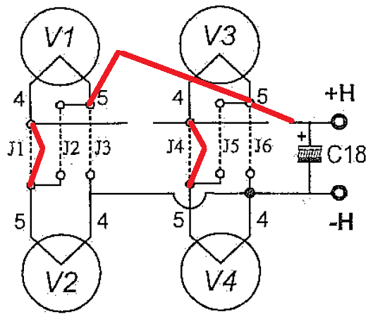

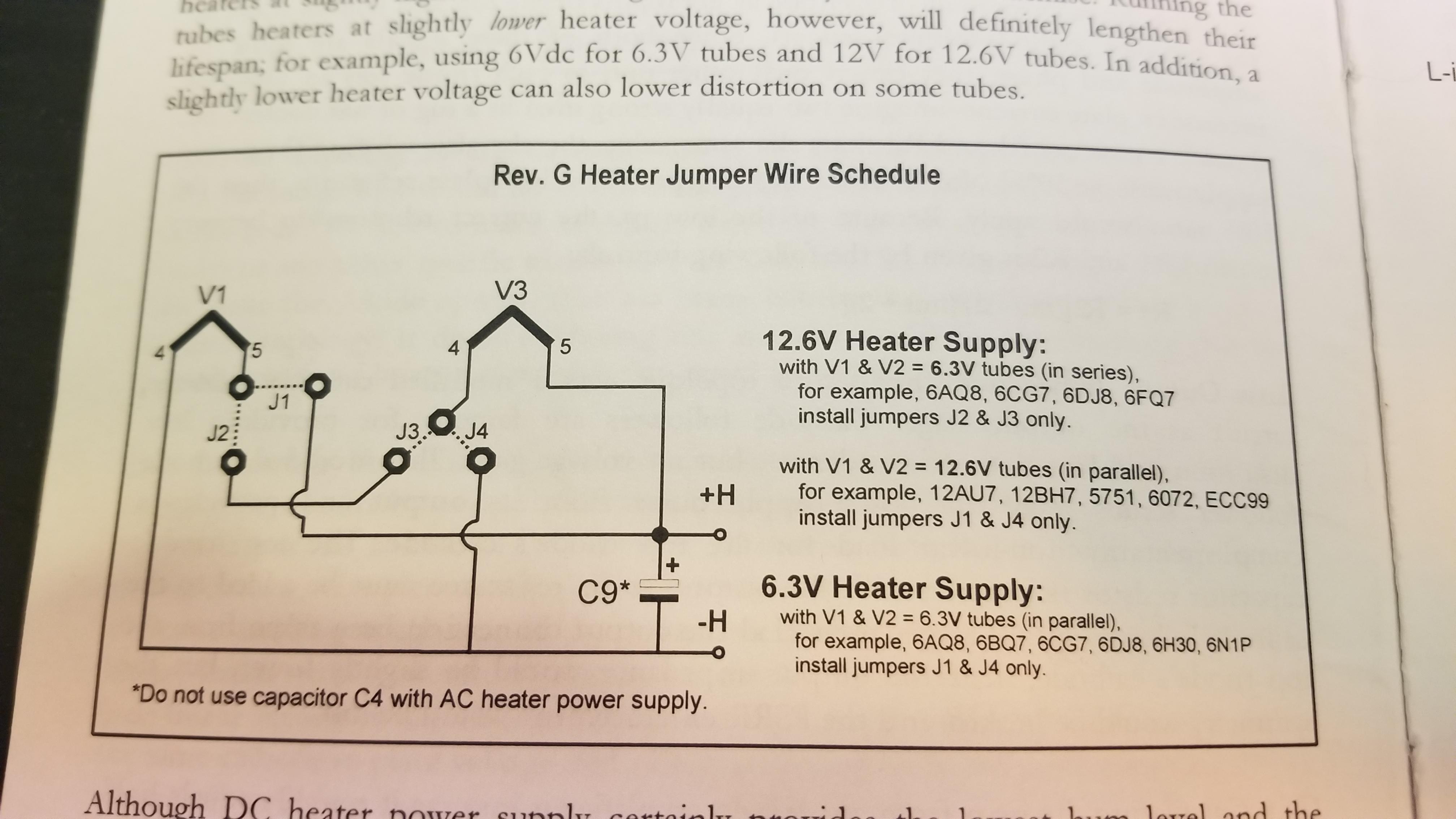

You have to cut +H trace. I think this is correct way. Any one confirm?

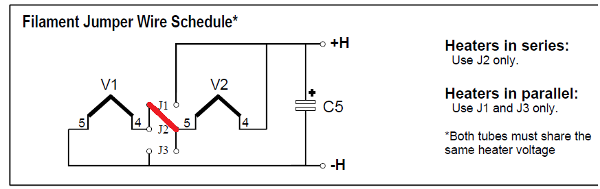

The Broskie boards I've seen have jumpers for changing between the base with pin 9 shield and the base with pin 9 center tap, and also jumpers for putting the heaters in series or parallel. I haven't seen the board in question or its documentation.
Here is the manual schem that came with these mono 9 pin boards. which looks different that your Alashikata. This shows how I can wire in series with jumpers but I am using the Janus Regulator so do I put 25v into the heater circuit on that board?

I think John revision manual never 100% complete. Even the last one, he still miss some components where you need to ask him.
Different revision has different jumpers. If you connect pin 5 of V1 to pin 4 of V3, then it's 25v. I haven't done mine yet but all my parts are for 6.3v
That won't work for the Janus board. You'll need 5V at 2A for the 5Y3 and either 6.3V at 300mA or 12.6V at 150mA for the 7247. Small 12.6 transformers are very common.
I ran into a problem using a Janus reg board for a preamp when I lived in a place where there were big jumps in the line voltage. The Janus reg doesn't regulate the DC voltage level, and these fluctuations were appearing at the output of the preamp, entering the power amp, making their way through that circuit and affecting the bias of the power tubes. I switched to a series reg (maida) and that solved it.
You could either use the 25v transformer like you said, or get a transformer with sufficient capacity for both the Aikido circuit and the Janus 7247. You'll need separate 5v for the 5Y3 either way, or use silicon diodes there.

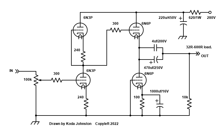

I built my own circuit effectively the Aikido without Aikidoeing. The Aikido feeds PSU noise into the unused triode to null the noise, but it only works for LF 50/60/100/120Hz and does nothing for 50kHz SMPS anyway.
I always looked at it as a half-assed work around for a crap power supply. My philosophy is if the PSU is clean, the PSRR doesn't need to be good.

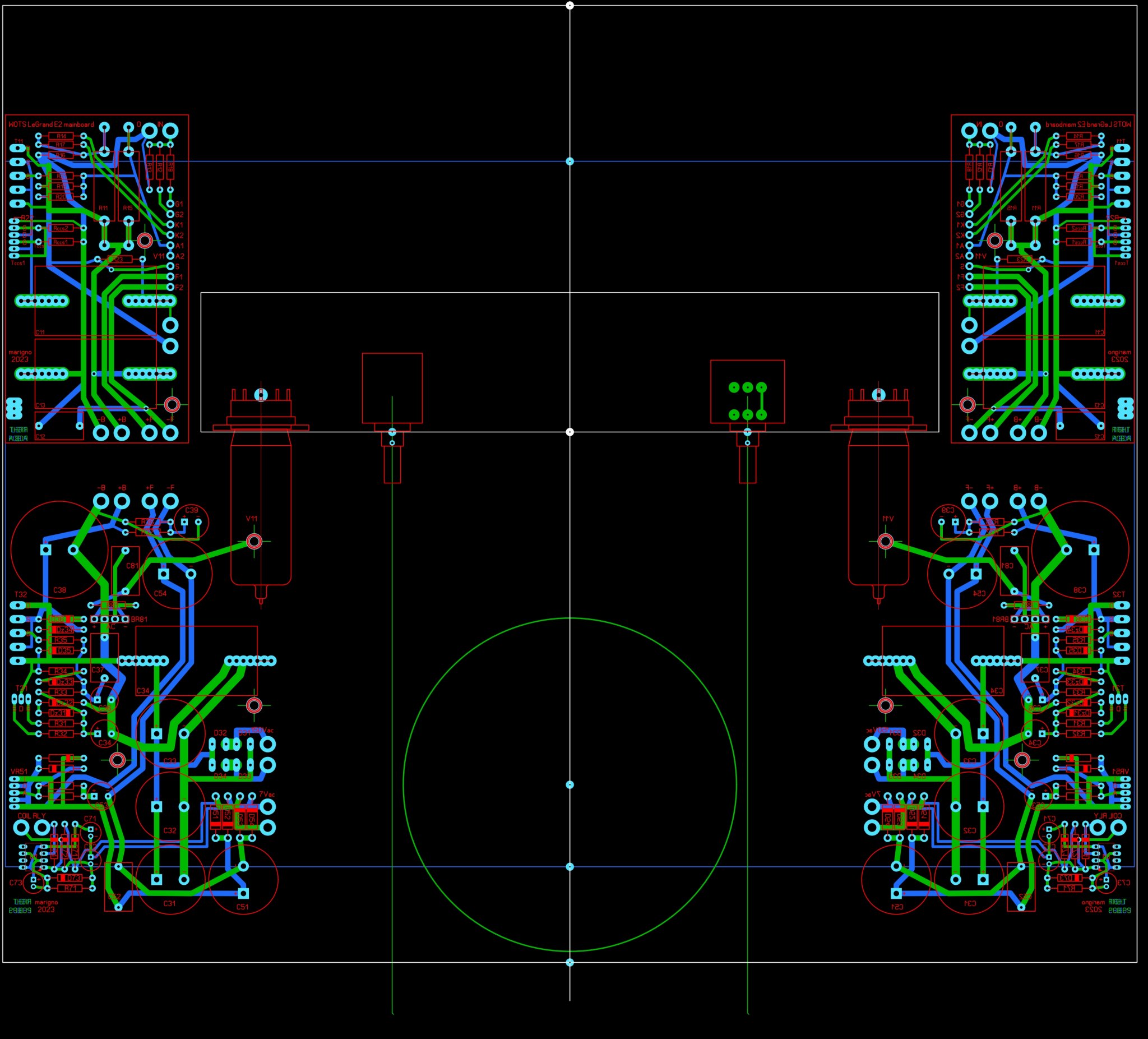

Good job on the pictures!
I understand you designed your PCB. Any suggestion about a good PCB Making service? I have the Gerber files almost ready for a project of mine.

EasyEDA and JLCPCB. And right now, they have a promo that if you make the thing in EasyEDA and use that to send it to JLC, they give you an 8$ coupon.
My last order I got 10 boards shipped for 3.10$CAD
My "actively loaded triode amplifier" negates the 2R1C in favour is SE output. It will drive 32R loud enough. It drives 470R very well, and of course, it also drives the input of 10 power amplifiers in parallel, 9 tube, 1 SS. So (9x100k) || 10k == about 5k
Thank you for the clues about the PCB services. I have already the Gerber files almost ready, I work with Sprint Layout 6.0. So I won't get any discount. Perhaps If I use EasyEDA and import the Gerber files into it, it will work and give me the discount. I'll try. I really don't like to design PCBs so I usually take a long time, then I need to forget about the tracks for some days, and then open again the CAD and check with the schematic if the drawing is correct. This time I had to design two reversible boards, which can be used symmetrically for the L and R channels. Take a look, the picture does not show the bottom side serigraphy. This project pushes the single-ended sound to a superior level.

I recommend you connect a 470KOhm resistor between the center of the potentiometer and the ground, in order to ensure the polarization to the grid of the first diode always, even when the potentiometer becomes dirty.
