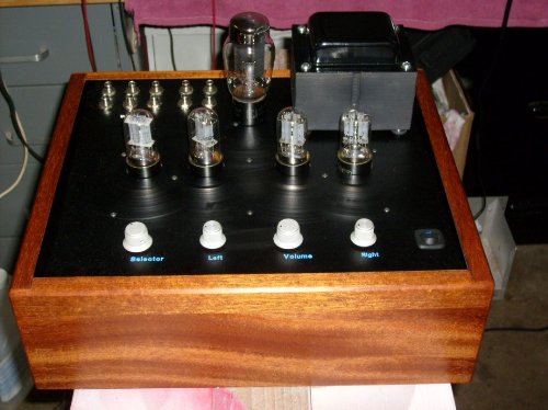

What type of rectifier tube is that? Nice looking Pre BTW.!
Ron

The rectifier tube is 5U4GB. The lettering is engraved and then infilled with paint. The top plate is from Front Panel designer which is a great site! Allows our designs to come much closer to commercial product.
